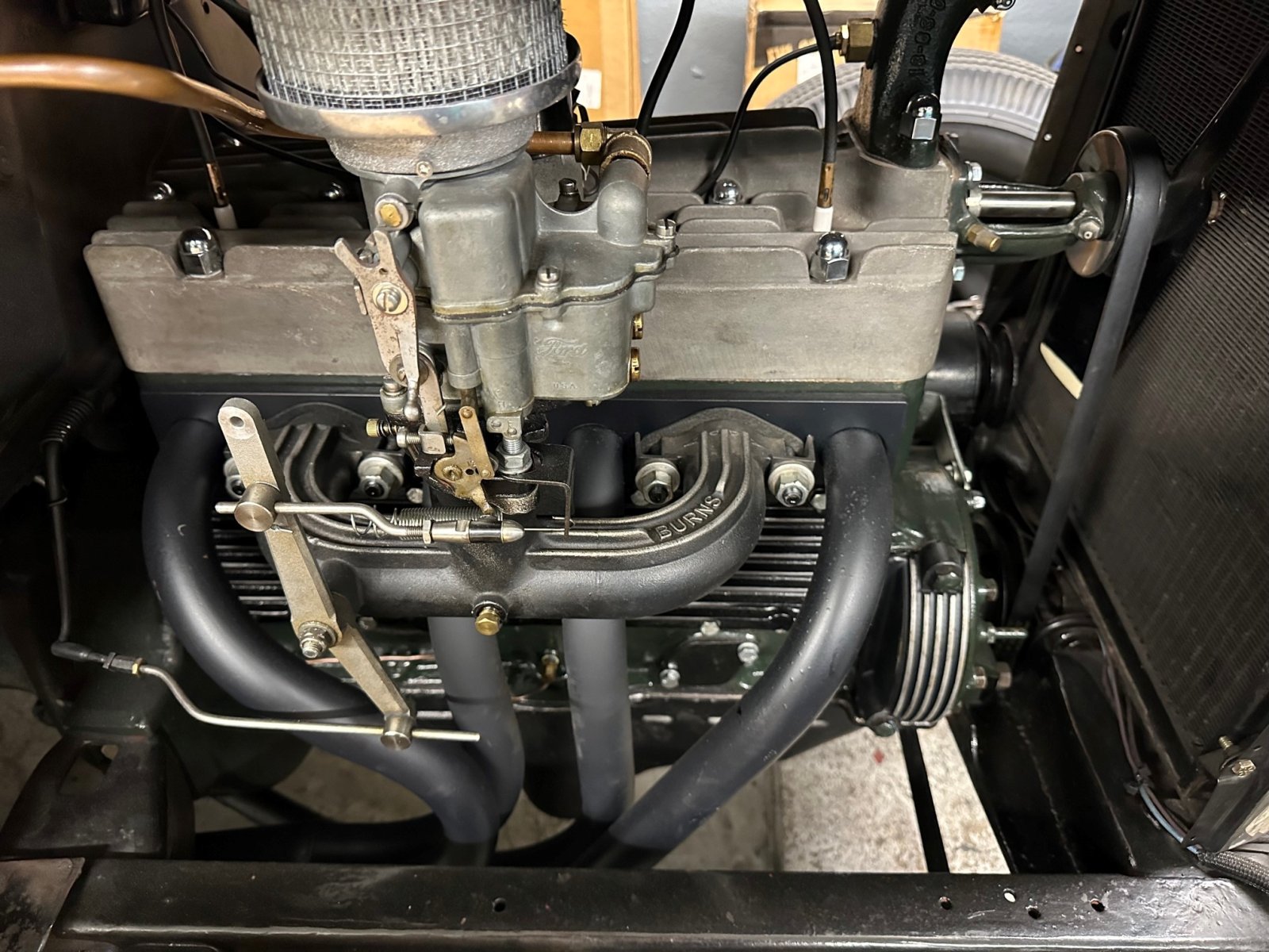

  7. I really need supervision in the shop
    Mock up going into coupe….
    burl, BiscayneBrain, Old Dawg and 7 others like this.

  9. Outback
    Joined: Mar 4, 2005
    Posts: 3,397
    Outback
    from NE Vic
    That does look dangerous...
    I think you should be left to your own devices more often! Haha
