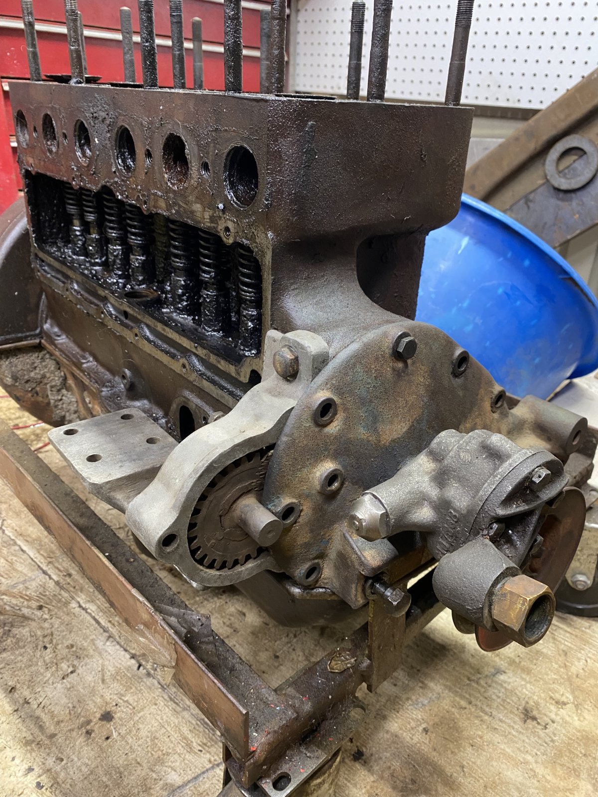

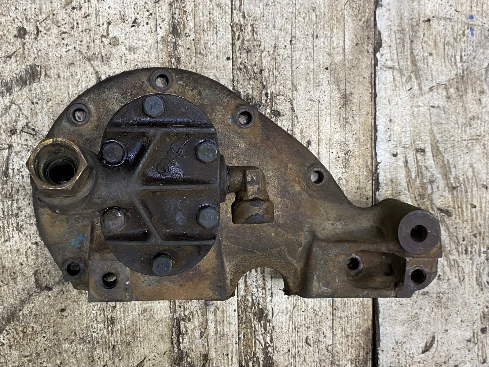

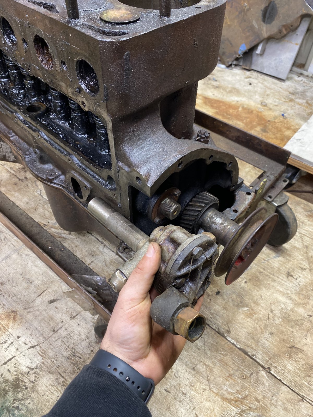

  2. I appreciate it guys! Currently I’ve got a .340 stripe cam, but I’m hoping to find a cam grinder locally. Learning how to grind a cam would be so cool.
    Tonight I got something I’ve been waiting so patiently for, an oil pump from a GMC “DUKW”. I chucked it in the lathe and turned it down to work with the cam plunger boss. I threw it on my B with a spare side drive… this is getting fun

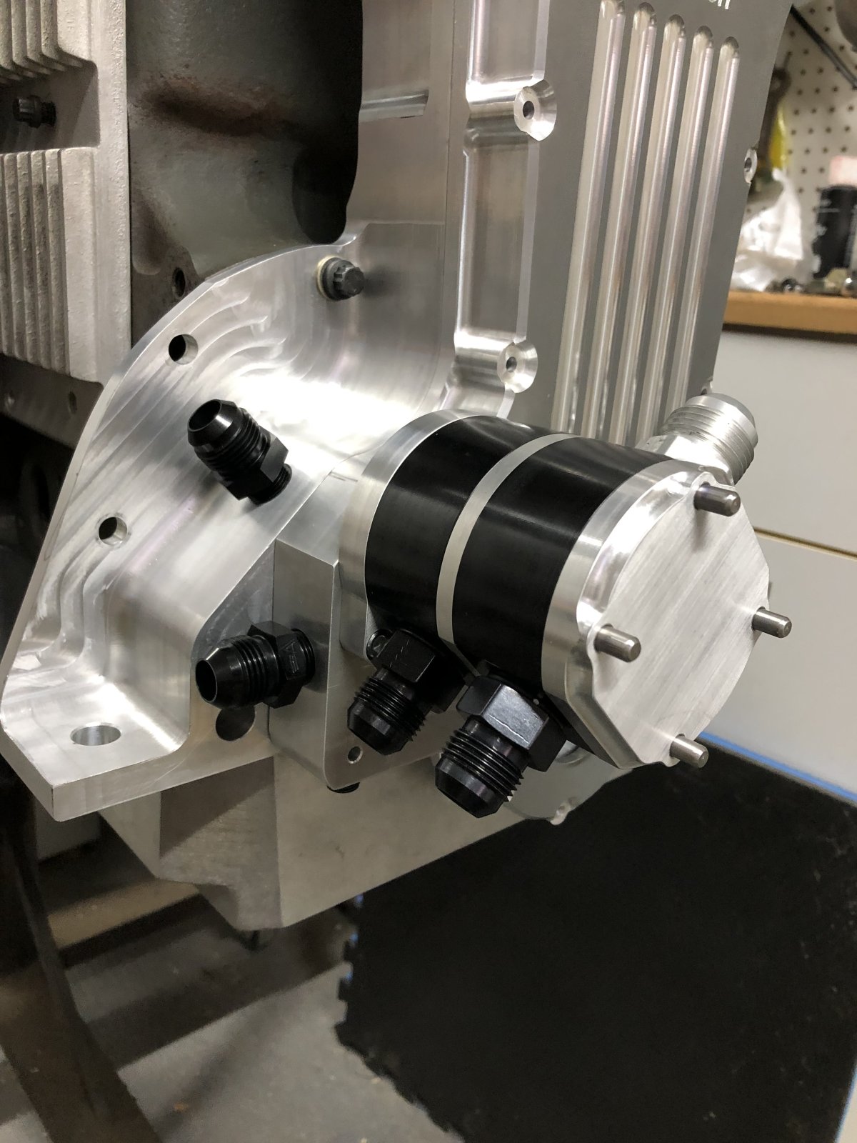

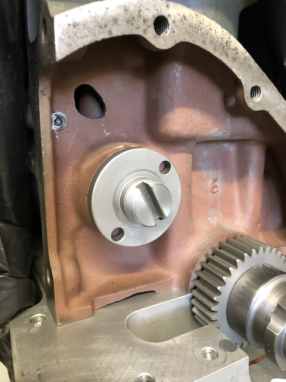

    Here is a pic of dry sump pumps on cam drive
    The pressure stage is inside the housing and 2 stages scavenge outside
  4. Wow, that is phenomenal machine work. Do I see a KONG side cover?
    Outback likes this.
  5. Yes
    Kong side cover

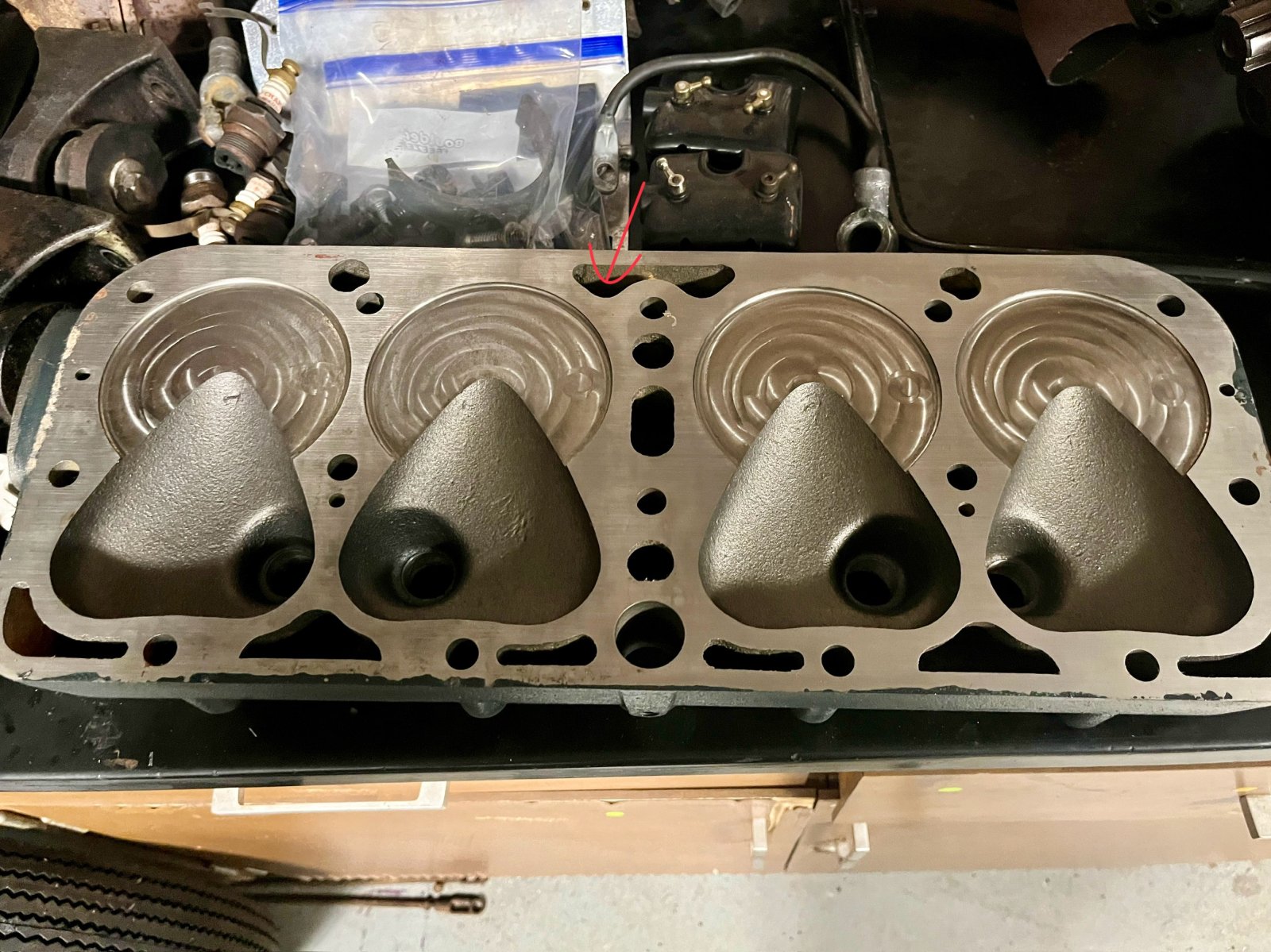

    Question for people smarter than me..
    What is this opening in the Snyders 5.5 head?
    Also, why do they recommend the B gasket on the A?
    As far as I know, the only difference is the 2 tiny holes in between the 2nd and 3rd cyl.
    Seems like an A gasket is the better choice.
    What am I missing?

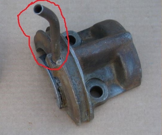

    I'm ***embling a B engine and found out that i'm missing oil return pipe from rear main cap. Pipe guides oil under the tray, so maybe it let returning oil cool down little and contaminations drop down to bottom of the pan. Or is there some other reason for that pipe? With out pipe oil drops straight on the tray where it will go on #4 rod bearing (i have original babbit bearings).
    The question is should i make the pipe or is it really waste of time? All other main caps leak the oil with out guide pipe, modern engines do not have pipes....

    yes, you need the pipe- windage from the crank will cause the rear main to leak. A model A pipe (except early '28) is the same size. Make sure when you screw the pipe in the cap that it does not go in so far as to partially block the oil flow. I always notch the end of the pipe to make 100% sure its as open as possible. The thread is 3/8-32.

    Thanks guys. The leak of rear seal without pipe makes sense. And yes those pipes are available, price is next to nothing. But only problem is that they are in States, i'm in Finland and i like to get the engine ***embled during this week. But i have 3/8" hydraulic pipe and hopefully find right size thread die, so what could go wrong... ;)

    The thread is standard National Extra Fine. You might find a die but 32 TPI is very close to a .8 mm pitch. If you can't locate a die, a machine shop could cut a .8mm pitch thread on your tubing- just a thought. Don't overlook tack welding it in place- I like a drop of braze, as the cap material is not steel, but rather some form of malleable iron from what I can tell and is not the most weldable material.

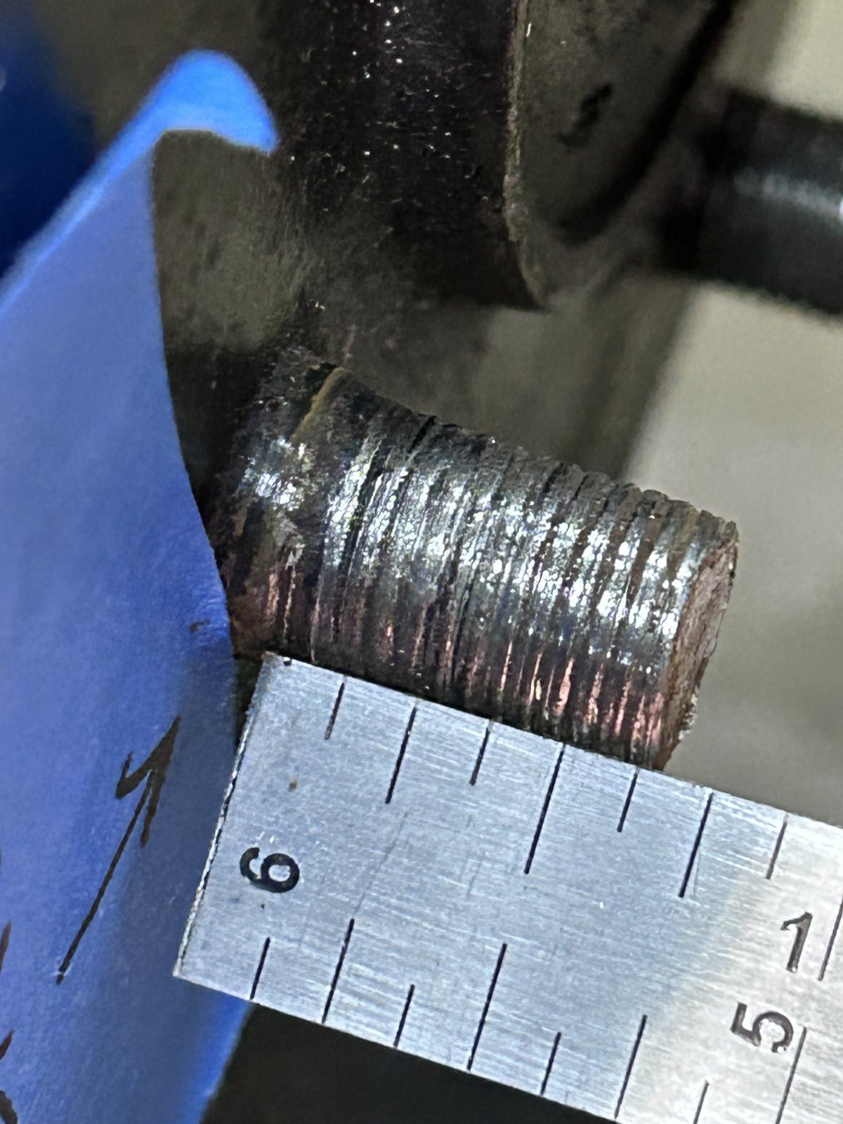

    I found out why my lug nut wouldn’t tighten.

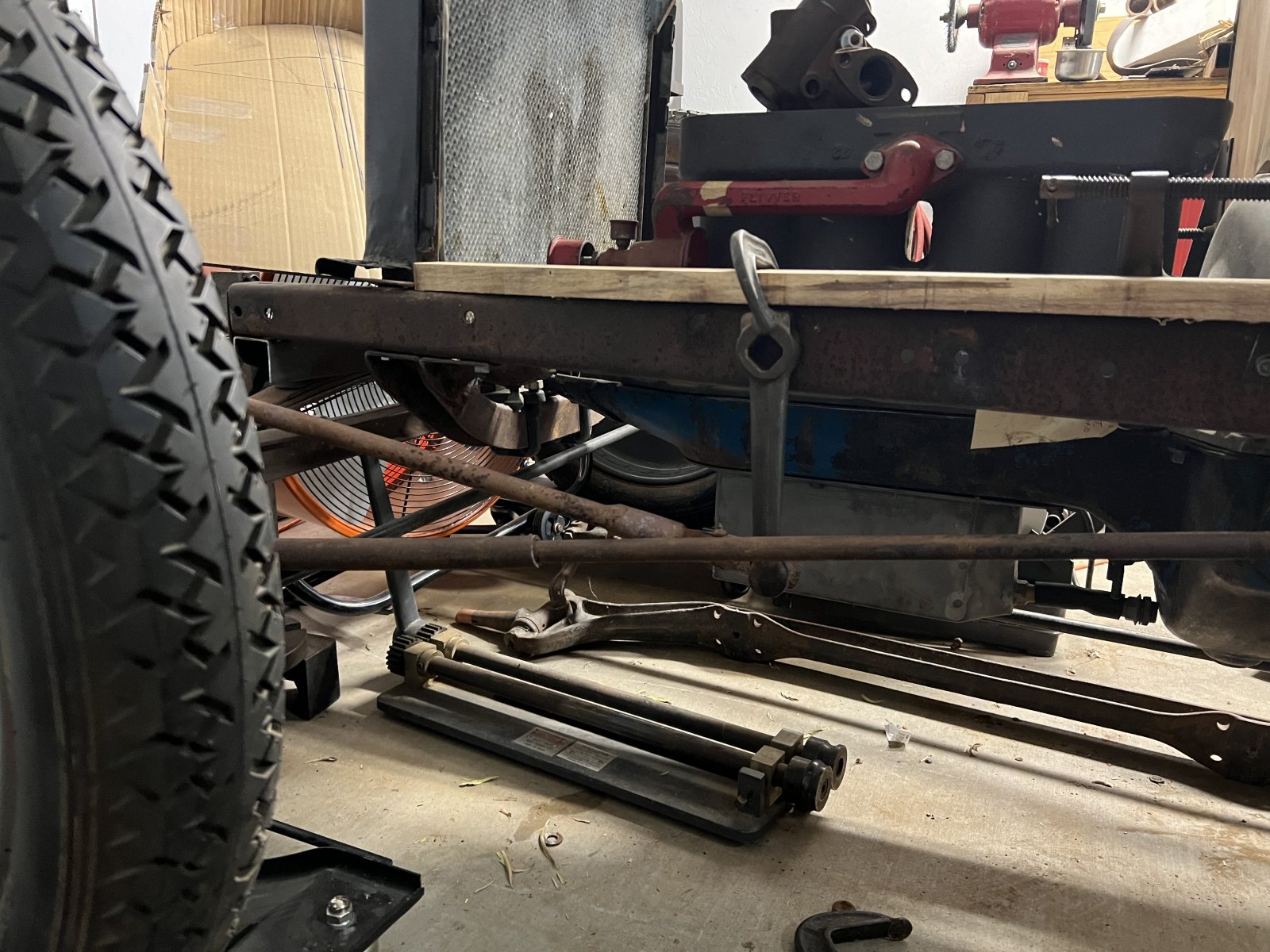

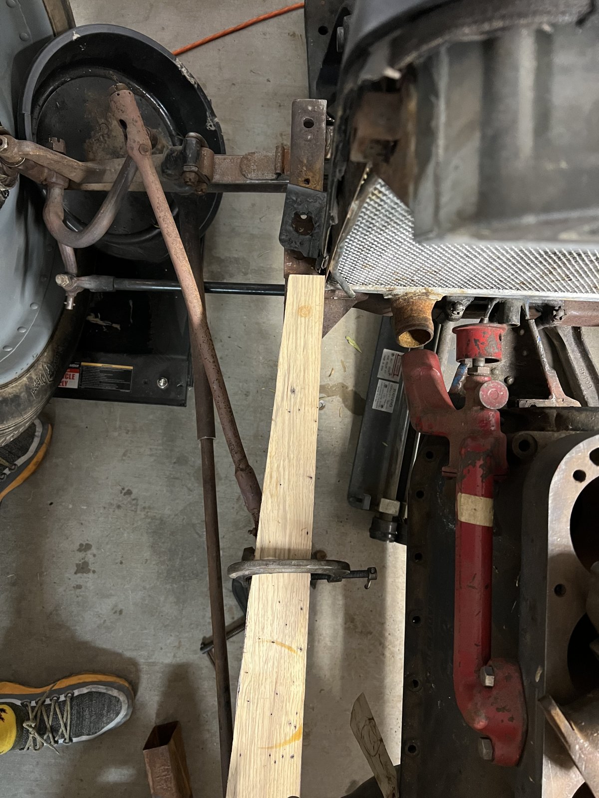

  17. Not particularly happy with this, have to fit it all behind a valence. Maybe side to side is the path.
    happy new years!
