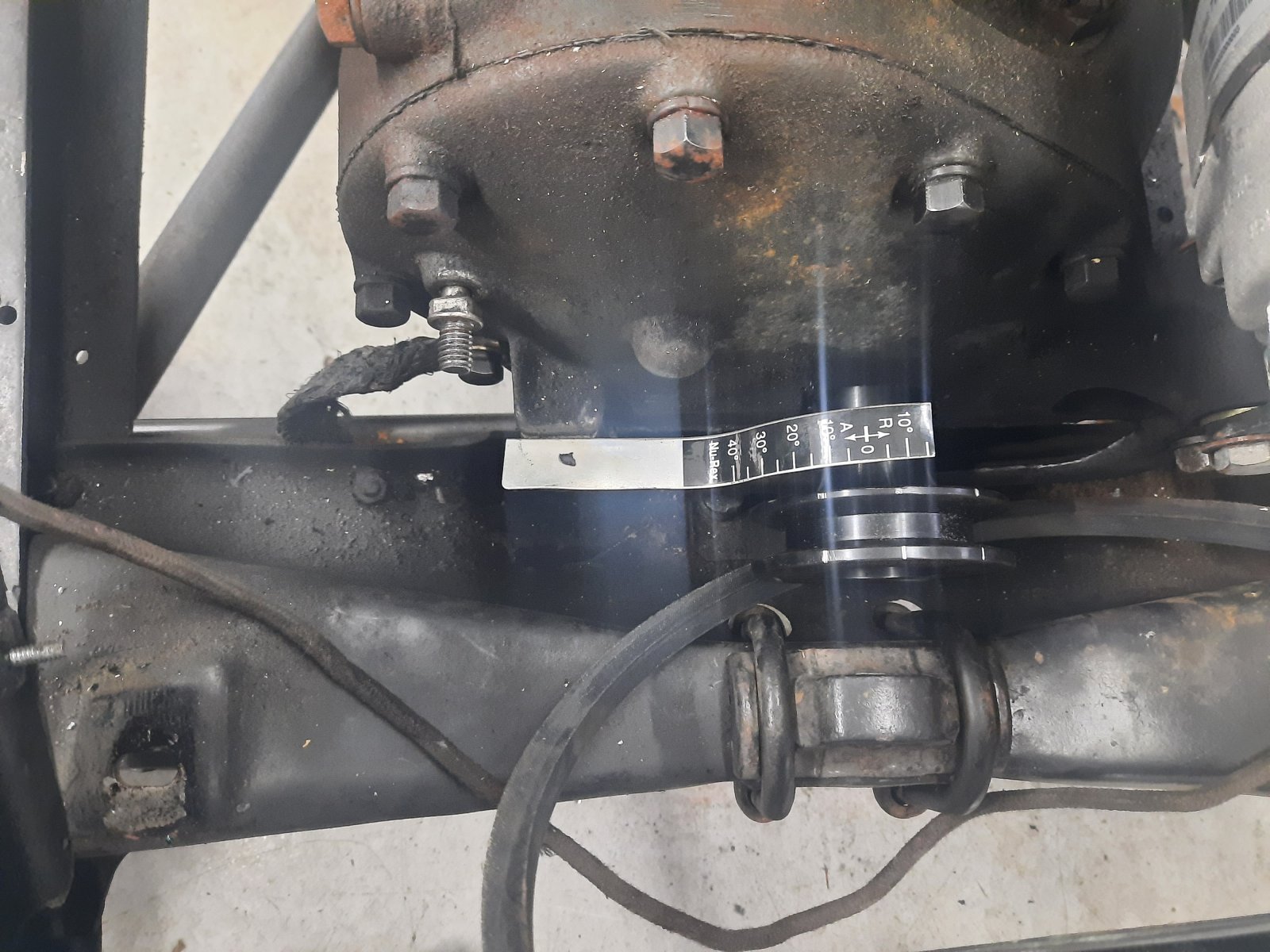

    Is any one else using this combination, a nu-rex timing strip and a Yapp small diameter pulley. I installed these yesterday, set 0 or TDC using the pin and my timing marks do not agree. The pully is premarked for 20 degrees retard and 30 degrees advanced. When the motor is at 0 by the pin, the 0 mark on the pulley is at 9 degrees retard on the nu-rex. Am I doing something wrong, or should I just remark 0 on the timing strip?
    Warren
    Old Dawg likes this.
  2. Dan from Oakland
    Joined: Jan 16, 2009
    Posts: 247
    Dan from Oakland
    Pretty sure the front cover timing pin does not set TDC- it positions the crank/cam at the point where you would set the distributor points to open. Some smart person needs to chime in and tell us what the crank position is when the pin is engaged. You might ask over on Ford Barn.

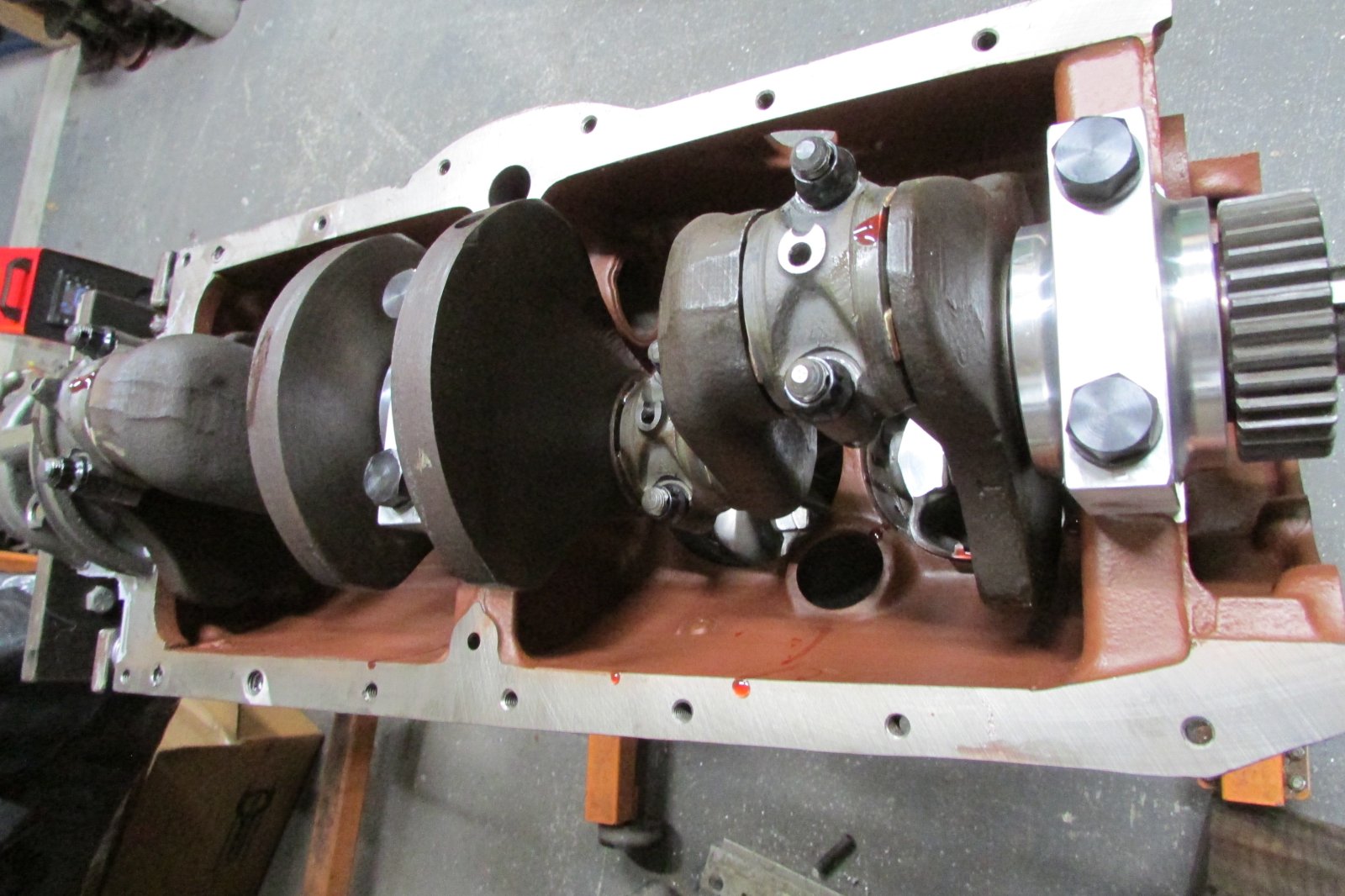

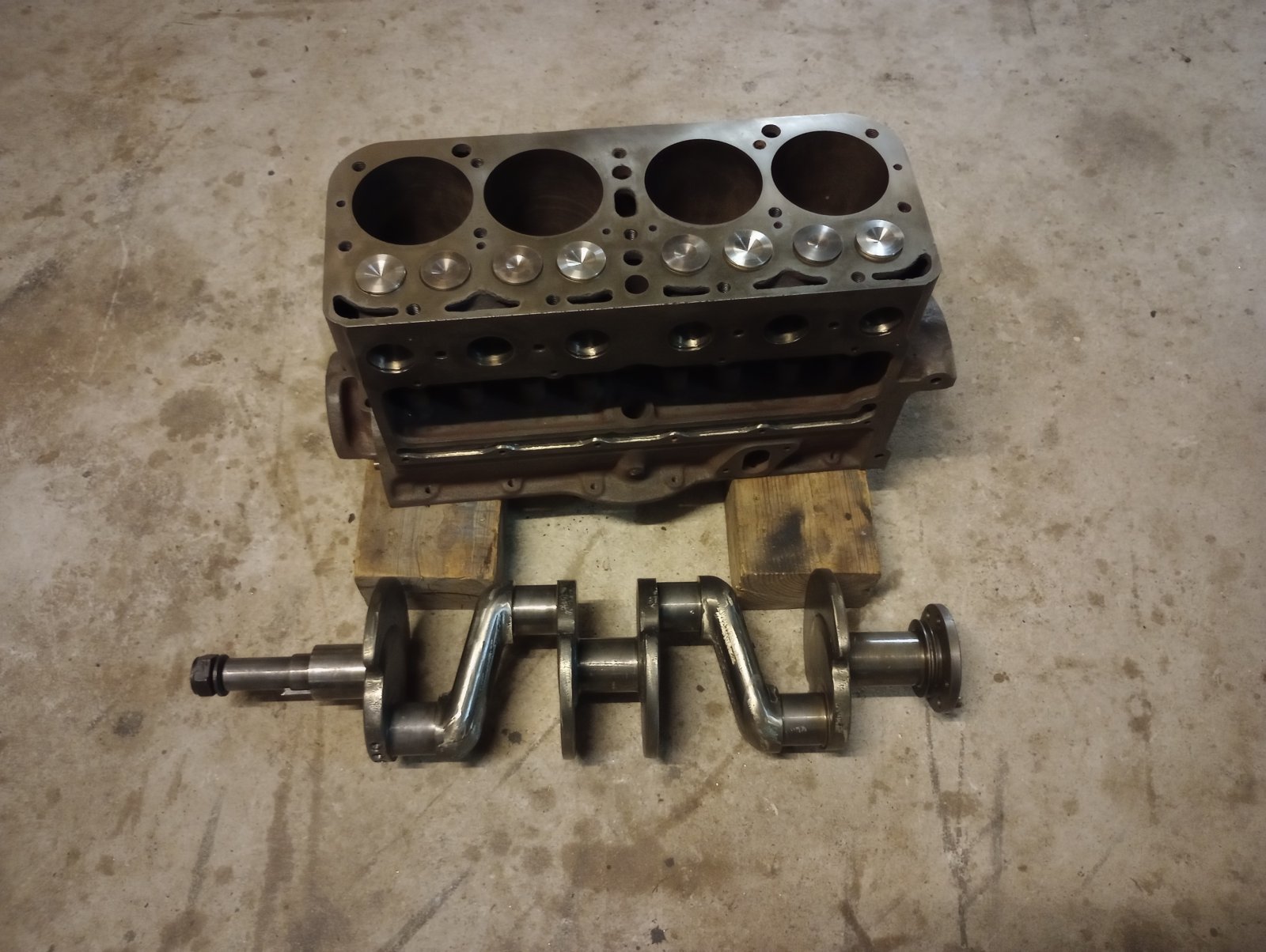

    I dropped into a mate of mine locally & he's putting a B motor together, welded on C'weights, we were chatting about piston options & aftermarket rods,
    What combo have you guys used?
    It looks like 283 pistons are the right bore size, & **** make rods in different lengths but only in A big end sizes. IMG_20240121_213735317.jpg IMG_20240121_213713947.jpg

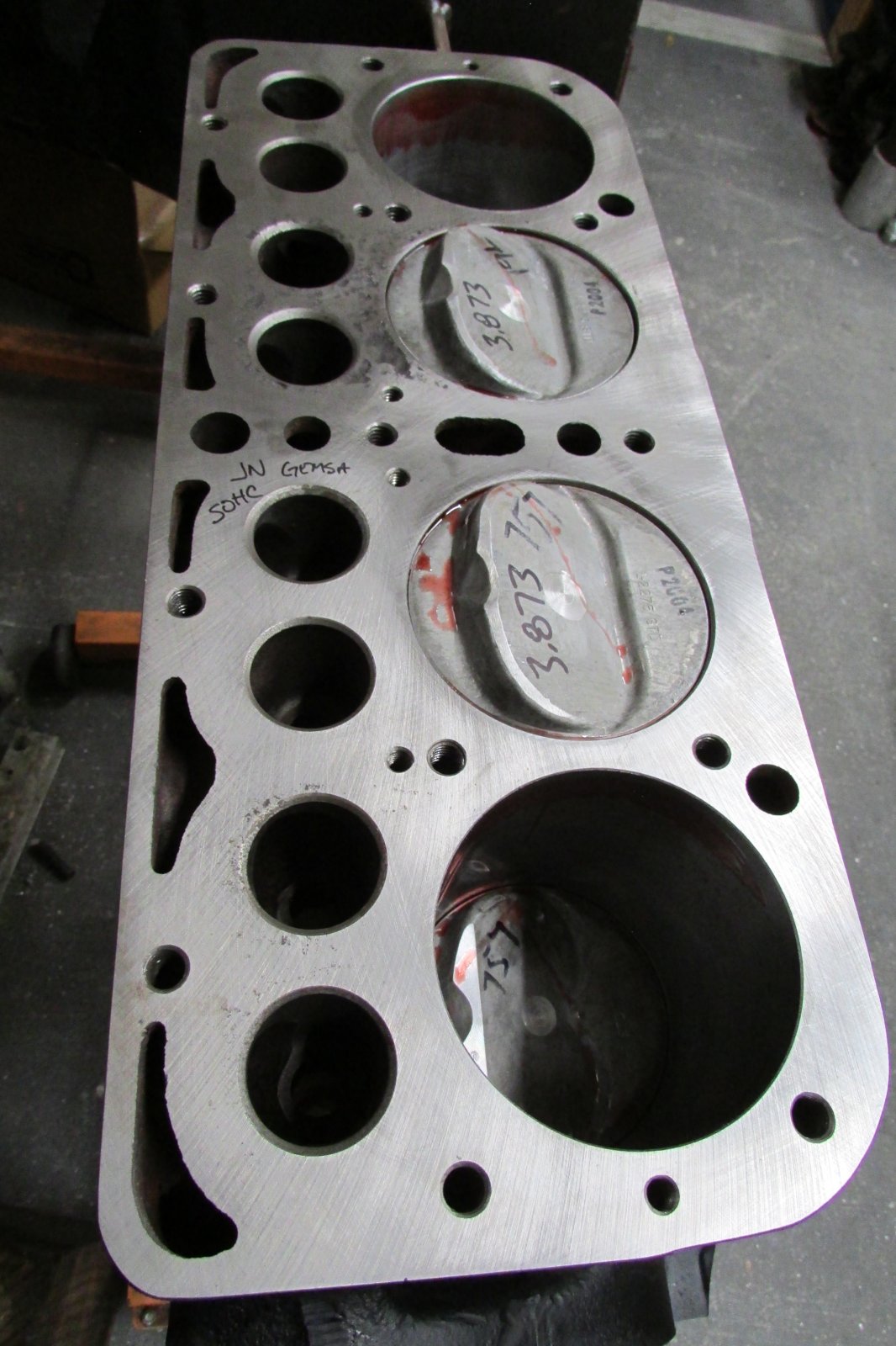

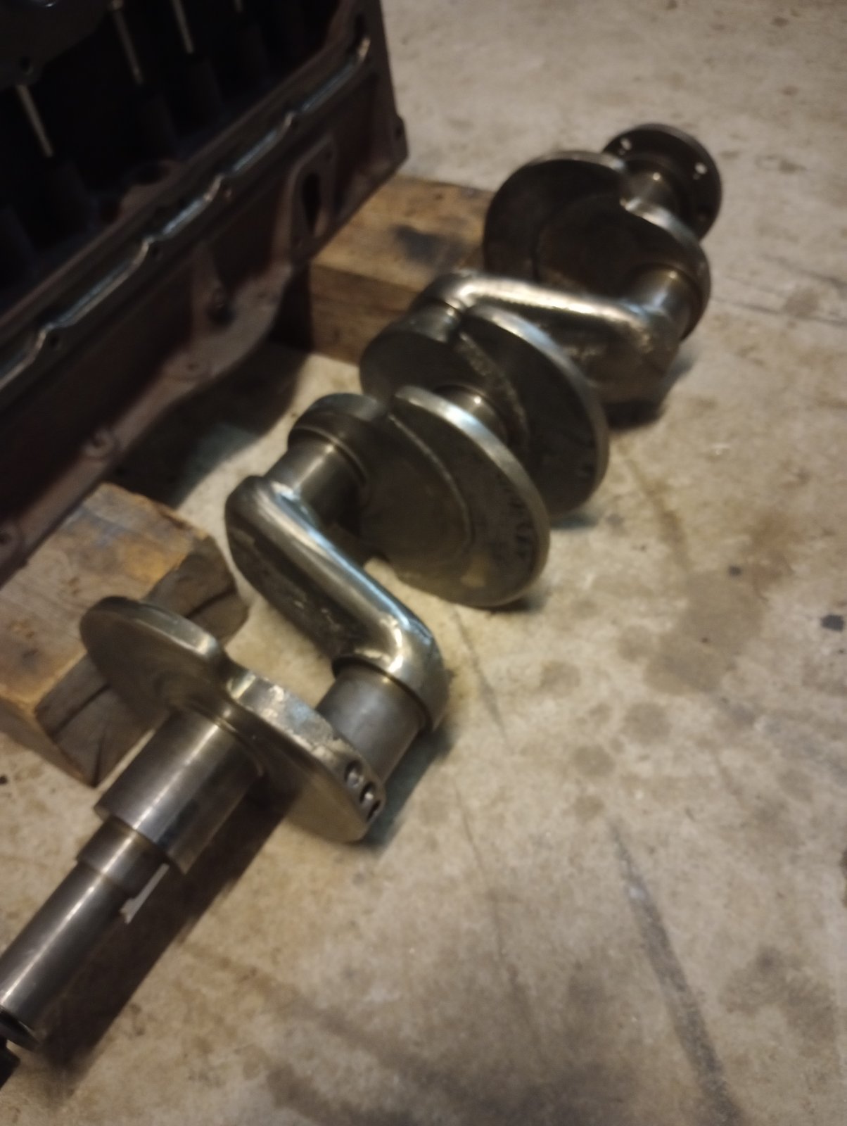

  6. So this weekend was mine to work on my own junk, made pretty good progress.
    This is a old style build, scrounged pistons from 283 Chevy, modified "B" rods etc.
    So, yes 283 chevy piston was proper bore size, but the CH is not high enough to make up compression.
    I found this set, or 1/2 set of TRW 283 11:1 pistons, it should net 9.5-10:1 on the Gemsa head, good enough.
    These rods are bored and honed for Volvo bearings, bushed for Chev pins and narrowed.
    The main caps are 7075 alum, main bearings 1055G TRW CL77 and 2 pc Chev rear seal.
    Of course crank is drilled and welded rear flange. This is going in my coupe with a SOHC Gemsa head.
    So just a few comments, the **** "A" rods are pretty good, I think the crank will be the weak link with 1.5 dia pin.
    I did a motor with them, 4.5 strk billet crank and 11:1 4 port Cragar head, transmissions are now a problem.
    AER Antique Engine Rebuilding was offering "B" rods and this is probably the best bet, especially if they offer it with Chev pin bushing. Crower and others offered them in the past, I hear rumors but not touched any.
    IMHO, pistons will be the issue for 3 reasons;
    1. most modern pistons are now metric dia so look for something like 98.5 dia.
    2. Compression Height, controls final CR, most modern pistons are much shorter than stk Mod "A/B"
    3. Rings package, the modern rings are necessary for better oil control and reduced drag.
    If you are going to race this, custom pistons are the only way to go, I like Ross, get your wallet out.
    Best, John

    Thanks John, great info, my friend's engine will be a street only, bar a possible blat at a dirt drags,
    What Rods did you use in this engine? Stock crank/stroke?
  8. All things said; if you are to be running that engine much over 3,000 R.P.M; put a harmonic damper on the nose of that crank. Without that it is not if; but when you will break the crank back near the rear main & flange!

    The timing pin does not set TDC. This is the best method of getting true TDC - https://www.motortrend.com/how-to/accurately-determine-piston-tdc/
    When pulley diameters are different the distance between each degree will get smaller as the diameter decreases. Find TDC and use the scale that is on the pulley.

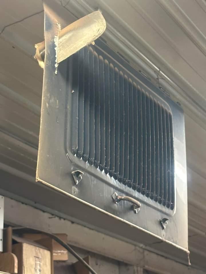

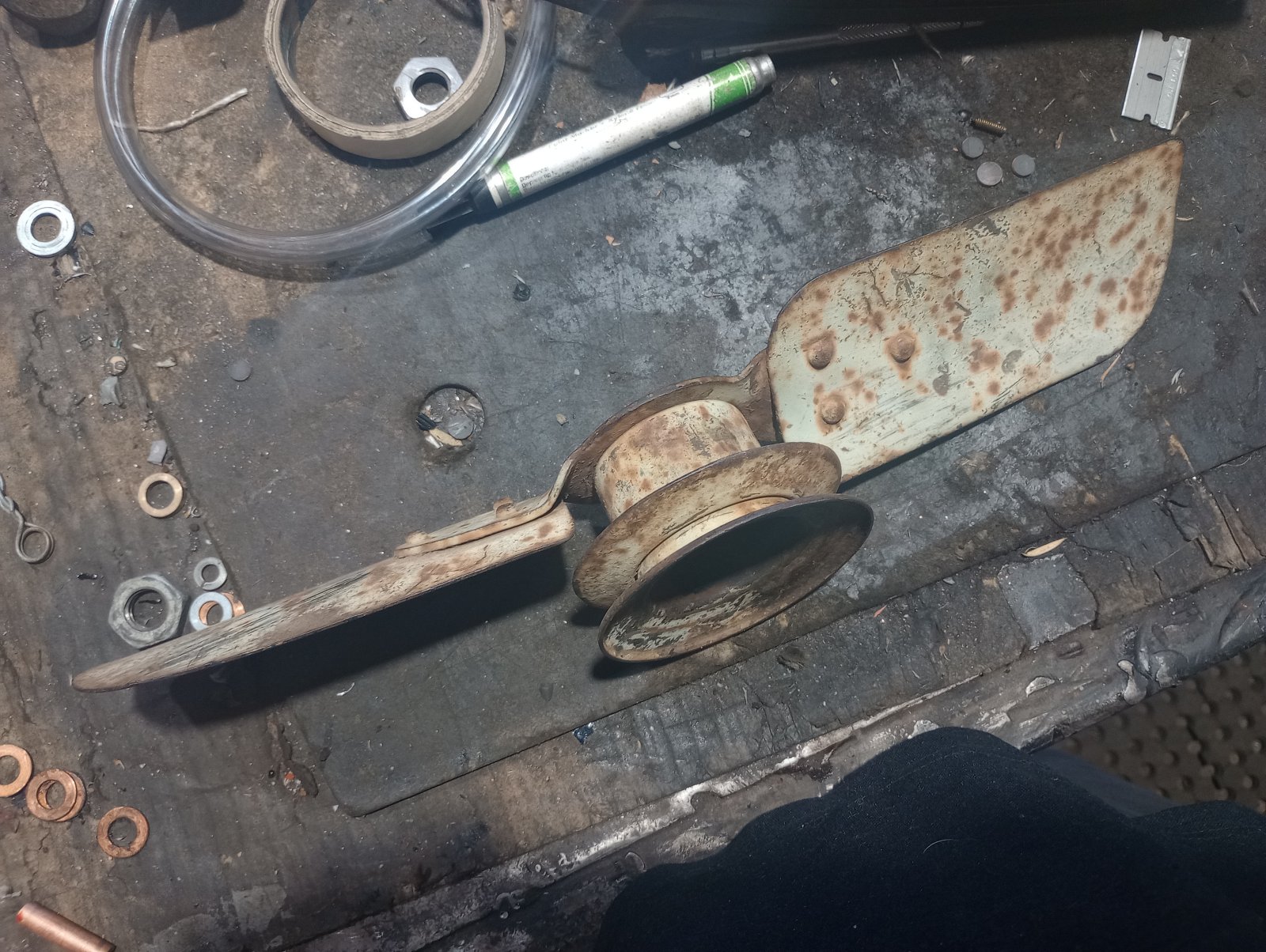

    On another note, anyone seen this style of A fan before? IMG_20240122_111735153.jpg IMG_20240122_111728268.jpg
  12. 29Sleeper
    Joined: Oct 25, 2023
    Posts: 491
    29Sleeper
    from SoCal
    I've only seen 1/2 of one before - but they are notorious for breaking. Buy one of the aluminum ones.
    fur biscuit and GuyW like this.

    I'm not sure I'm following - did the Yapp pulley come with the timing marks? or were the marks transferred from the timing tape? I'm not trying to be a jerk, but the timing tape is only for one certain diameter pulley or balancer...
    Outback likes this.
  14. Outback
    Joined: Mar 4, 2005
    Posts: 3,371
    Outback
    from NE Vic
    Yikes! Is that one of the riveted ones?

    The Yapp pulley comes with the timing marks. It doesn't matter about the diameter of the pulley, 0 degrees is still 0 degrees. The Nu-rex timing strip is stationary and mounted to the front engine mount bolt. The timing pins brings the motor to TDC or 0 degrees, I have the head off. Wait a minute, I was reading somewhere that they used two different motor mounts, one with 9" spacing and the other with 6.5" spacing. Is this correct, because if that is the case, the 6.5" spacing would align the marks.

    I was pretty confident it was a different type of fan, I have a few original pressed/welded types, this is the first I've seen like this with the rivets... Another mate who has rebuilt lots of bangers hasn't seen one before either

    Yes 0 is the same on both pulleys - but diameter does matter when reading degrees. To make it simple draw a circle with a 36" cir***ference then one inside it with 18" cir***ference. 360 degrees on the out side circle will have 10 degrees per inch. On the inside circle there will be 10 degrees in every 1/2 inch.
    The timing cover (is what I ***ume you are calling engine mount) went through several revisions. The B had the timing hole in a different location. https://jmodela.coffeecup.com/t_covers.html

    Yes, I see what you mean. I'm going to get rid of the Nu-rex and make a nice pointer closer to the pulley and forget this visual distortion. The A pin detent was a 0 degrees and the B I think was at 6 degrees.
    Thanks
    Warren

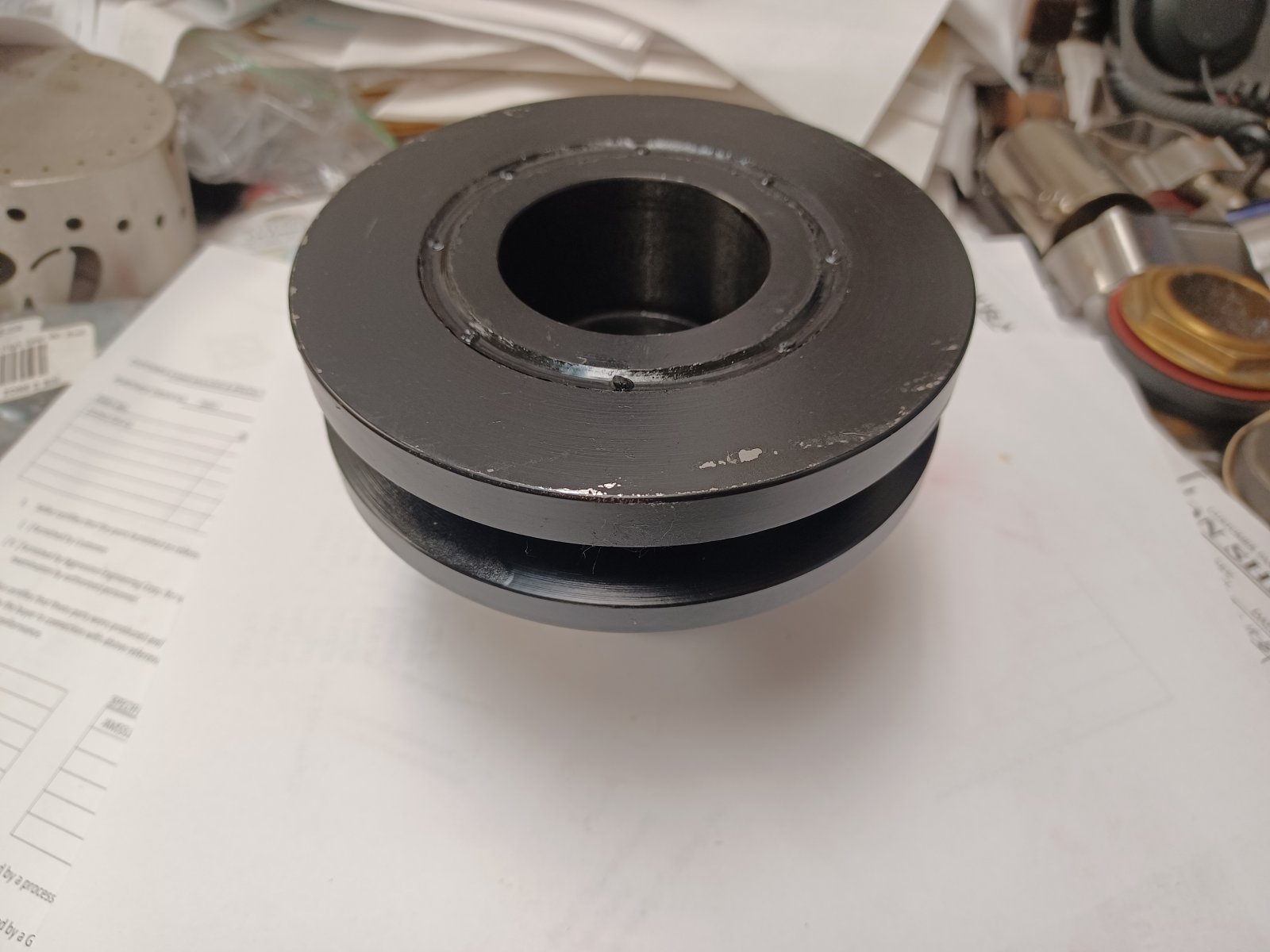

    If anyone is looking for a damper for their engine. The guy in New Zealand has them in stock now.
  25. wuga
    Joined: Sep 21, 2008
    Posts: 720
    wuga
    What diameter, are they degreed, how much, who is the guy?
    Warren
  26. Crazydaddyo
    Joined: Apr 6, 2008
    Posts: 3,372
    Crazydaddyo
    OD is 5", not degreed, $350 delivered, Murry Horn (sorry he is in New Zealand) horn@xtra.co.nz.
    Outback likes this.
