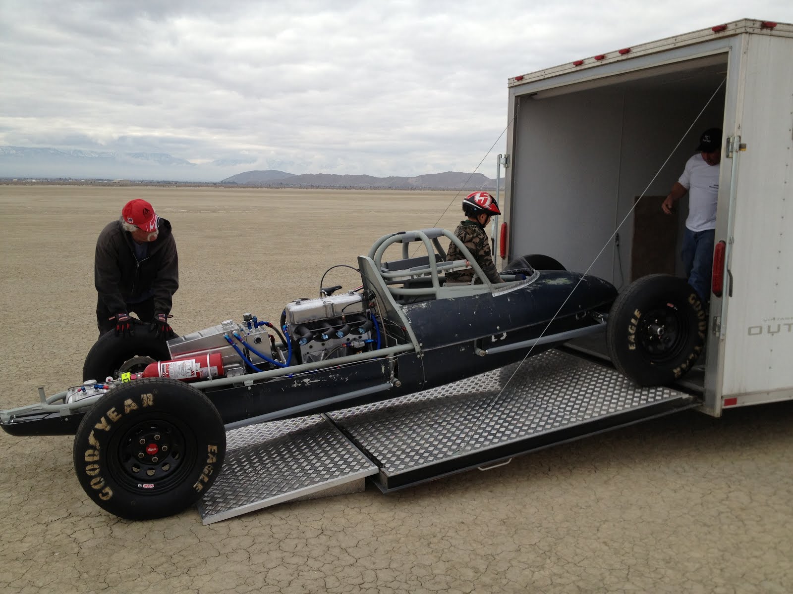

  1. Heres a different looking Banger powered car making its debut at the dirt dyno.
    John
  2. Crazydaddyo
    Joined: Apr 6, 2008
    Posts: 3,374
    Crazydaddyo
    How did it run John?
  3. CDO, not bad at all.
    We had a pretty boring day of it, no leaks or broken anything.
    I hit a depression at about 80 and bumped the inertia switch. Yes, it rattled my head around the cage pretty good too.
    Doing some finishing on the body and getting ready for May.

  8. more pics from debut.
    specs;
    pretty simple, mod B block
    everything else custom built not from Ford
    as Newman said once, "it has been the most fun you can have with your pants on"
    J
