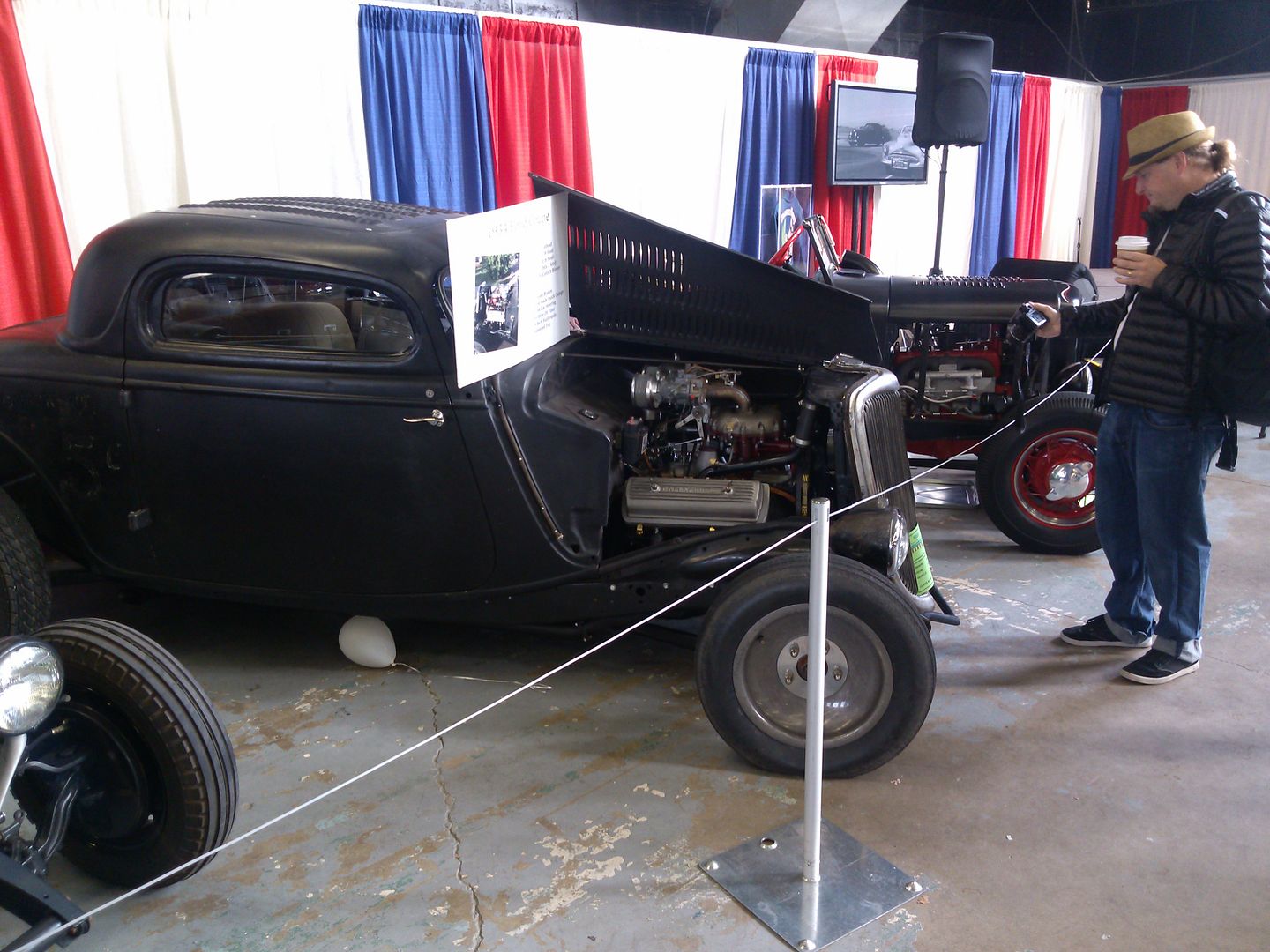

  12. Pictures speak for themselves fellas. GNRS 2013 Banger stuff I saw and the Carl Loveless Roadster from last year 2012 to this year.

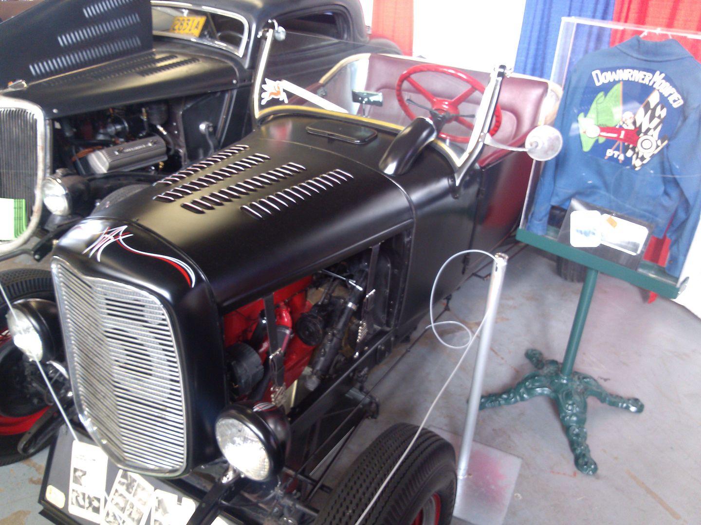

  13. Good article on the Milodon effort. One of my early banger favorites. Apparently the parts run was limited and eventually dried up; did he not pass away suddenly?

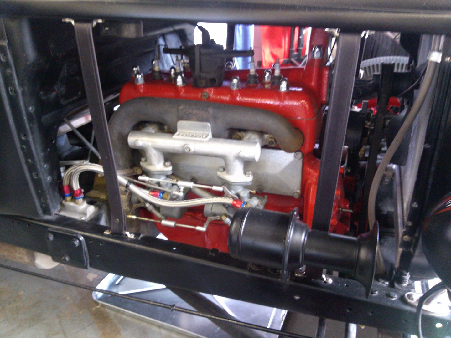

  26. Just a little peak into my banger. Can't really tell much from the pics, but from the outside it looks almost new!
    [​IMG][​IMG]
    [​IMG][​IMG]
    The raw metal in the cylinders appear to be dark gray, as if covered with carbon, but that's the flash doing funny things. The internals actually look really new, with more of a fresh light grat finish.
    What do you guys think?
