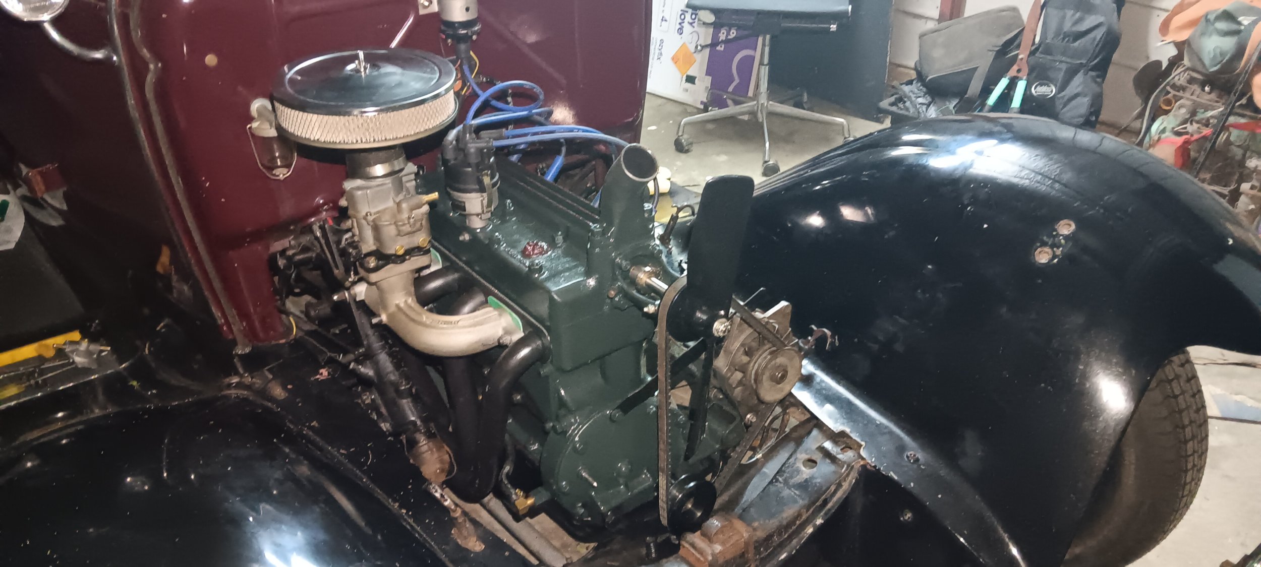

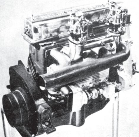

    Dan Price also makes a "Miller" OHV head
    I had a boss that bought a Denver Miller head back in the day and had it installed on an A engine. This would have been 1982, '83. IMG_20250112_084437735.jpg I always lusted after it. They were manufactured in Denver, by the Van Steenburgh Engineering Laboratories, Inc.
    I eventually obtained some Miller OHV conversions have a 'Denver' Miller on a B engine, currently in a '29 A Roadster....it runs real respectful.

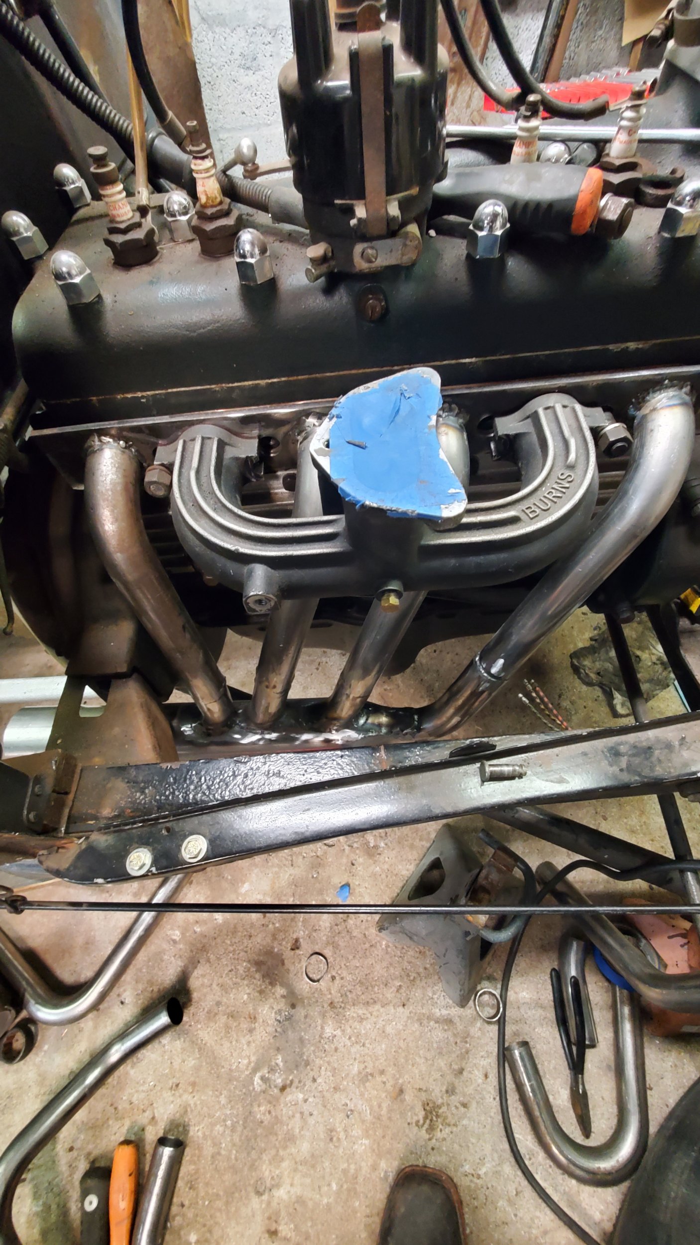

    Had some left over 1 1/2 bends I booger welded up into a header collecting in a piece of 3". All this as preparation for the downdraft intake and 81 carb. Not sure about the performance because the runners are pretty short but I'm happy with the shape cutting the saddles to nicely transition into the "log" was pretty difficult. If I build another I'm going to buy a nice thick flange from Yapp or Dan Price. Lots of issues with my holesaw wandering and making my holes oversized which really made for some ugly welds having to fill a gap.

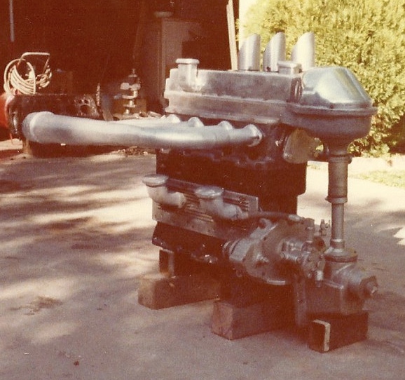

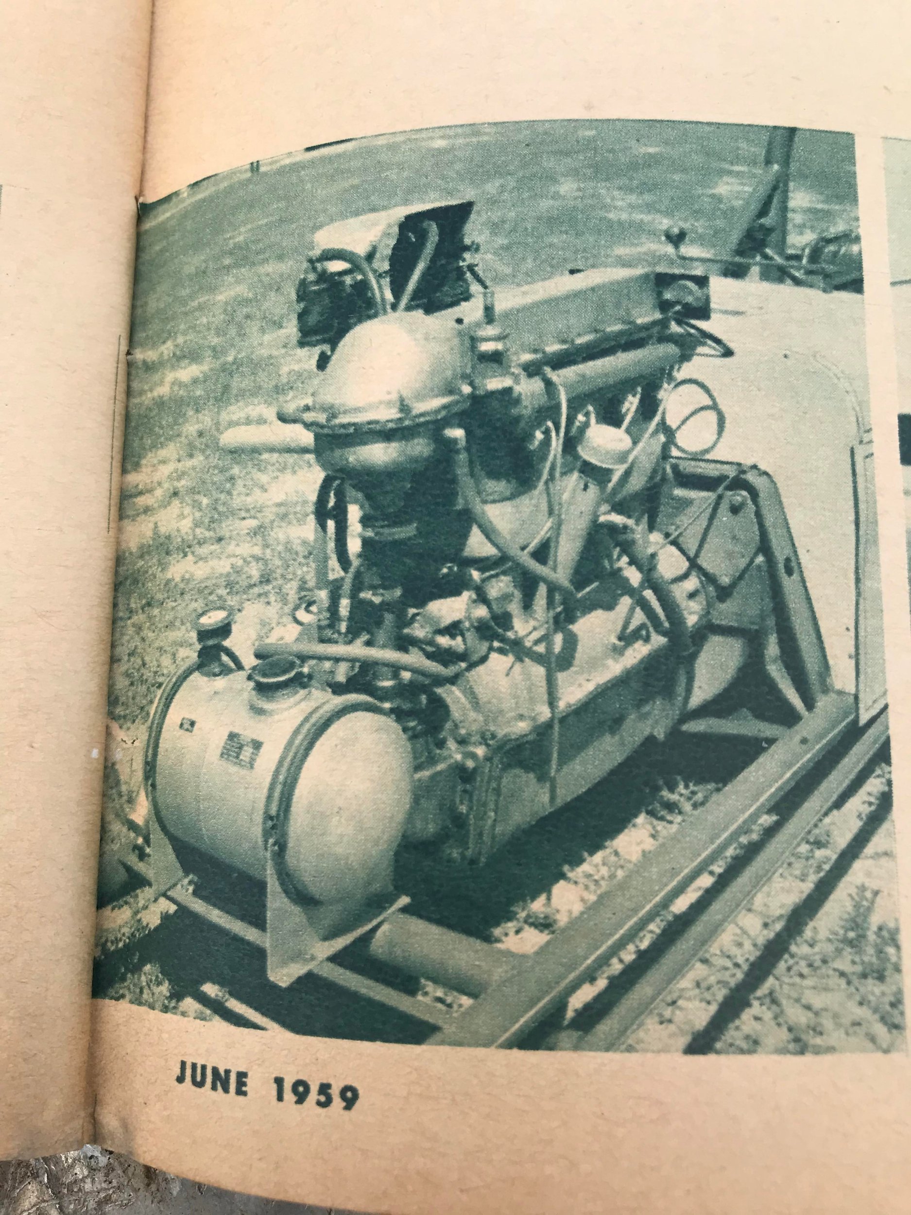

  8. Recently discovered this. Nichols Converted Wills-St. Clair OHC Case on top of a cragar head. Can someone explain this?! 269804339_874140323256264_7841948224763247158_n.jpg

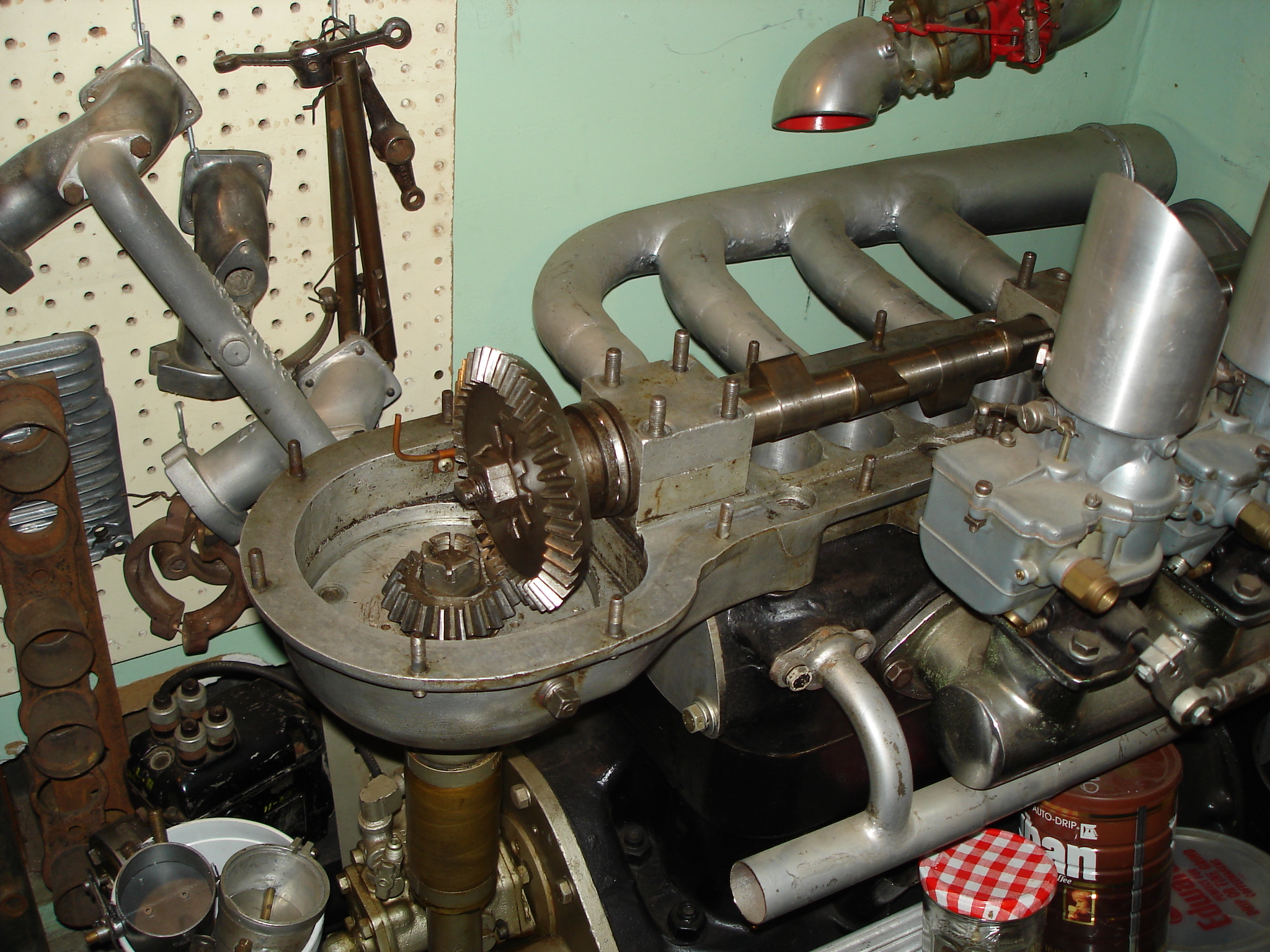

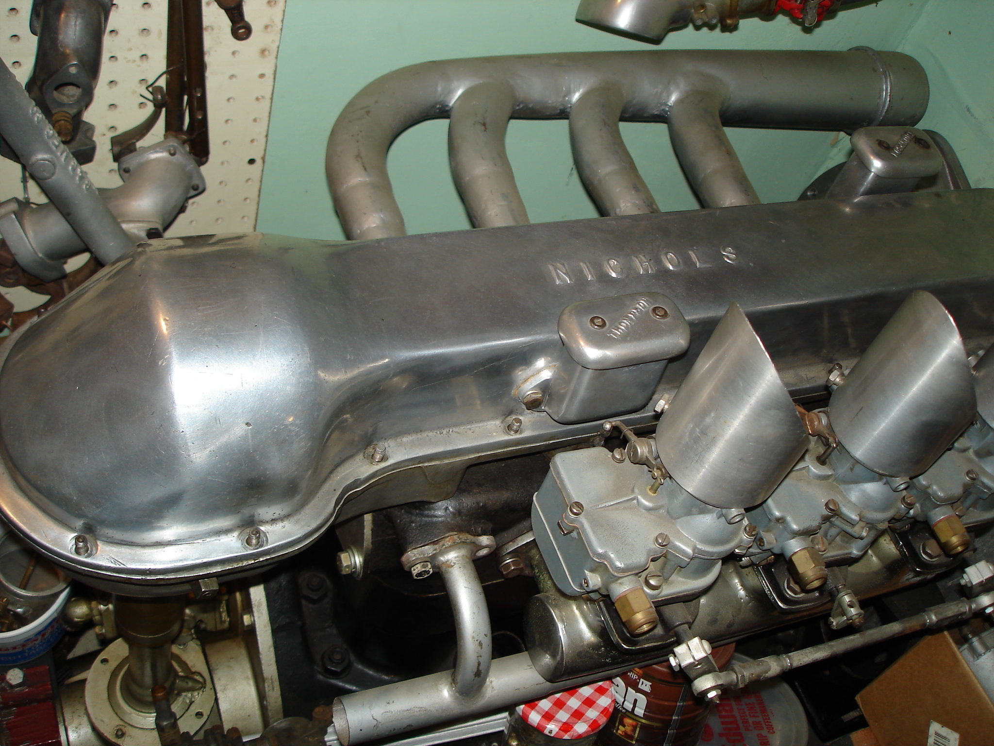

    Reason, I have that engine. It was used in the Merrymen car club (Long Beach) dragster. When I got it the Cragar head was not salvageable, it also came with a McDowell. The cam case and drive are Nichols, there are no Wills St. Claire parts in it. Here are some pics with the McDowell head. Scan.jpeg page3.jpeg DSC04893.jpeg DSC04891.jpeg
  11. holy cow, that is wicked cool! How many were made?
