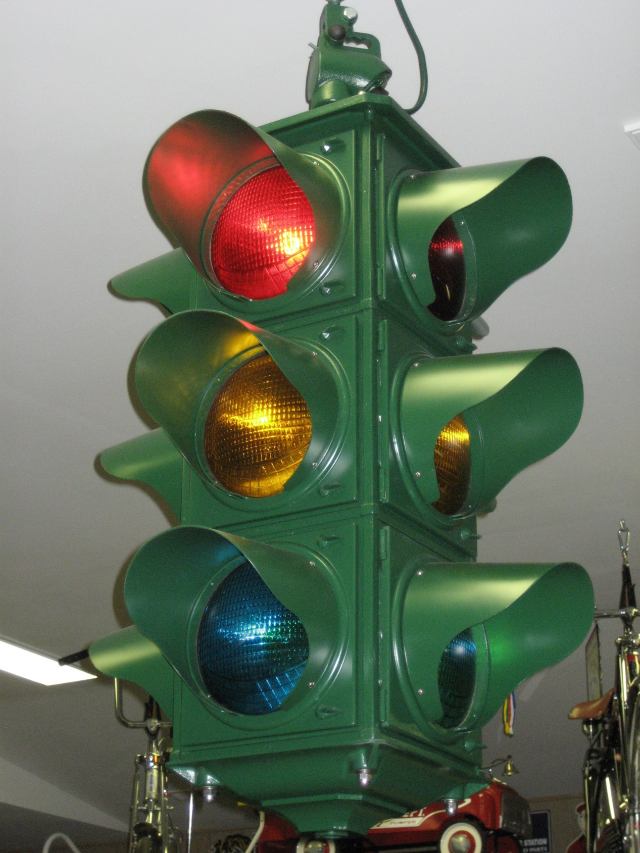

  16. When I got this 1940's Crouse-Hinds 4-way traffic light it had a half-moon chunk broken out of the lower cover. I took some aluminum foil and made a mold from the opposite side of the cover. I mixed a batch of JB Weld and filled the mold which I had taped to the broken cover. A few hours later I removed the mold and was amazed at the repair. After primer and green paint, the repair is invisible! Good stuff.
