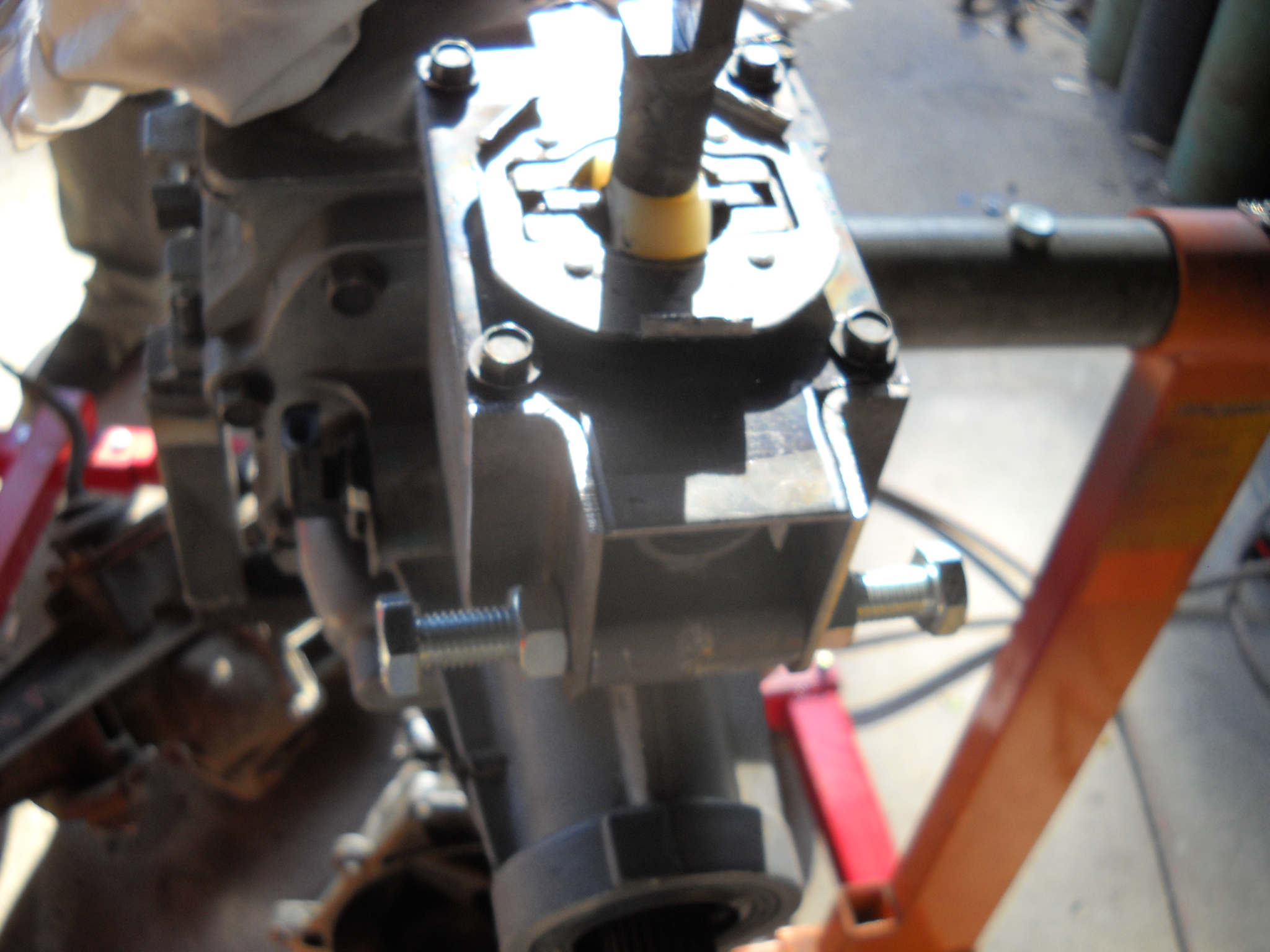

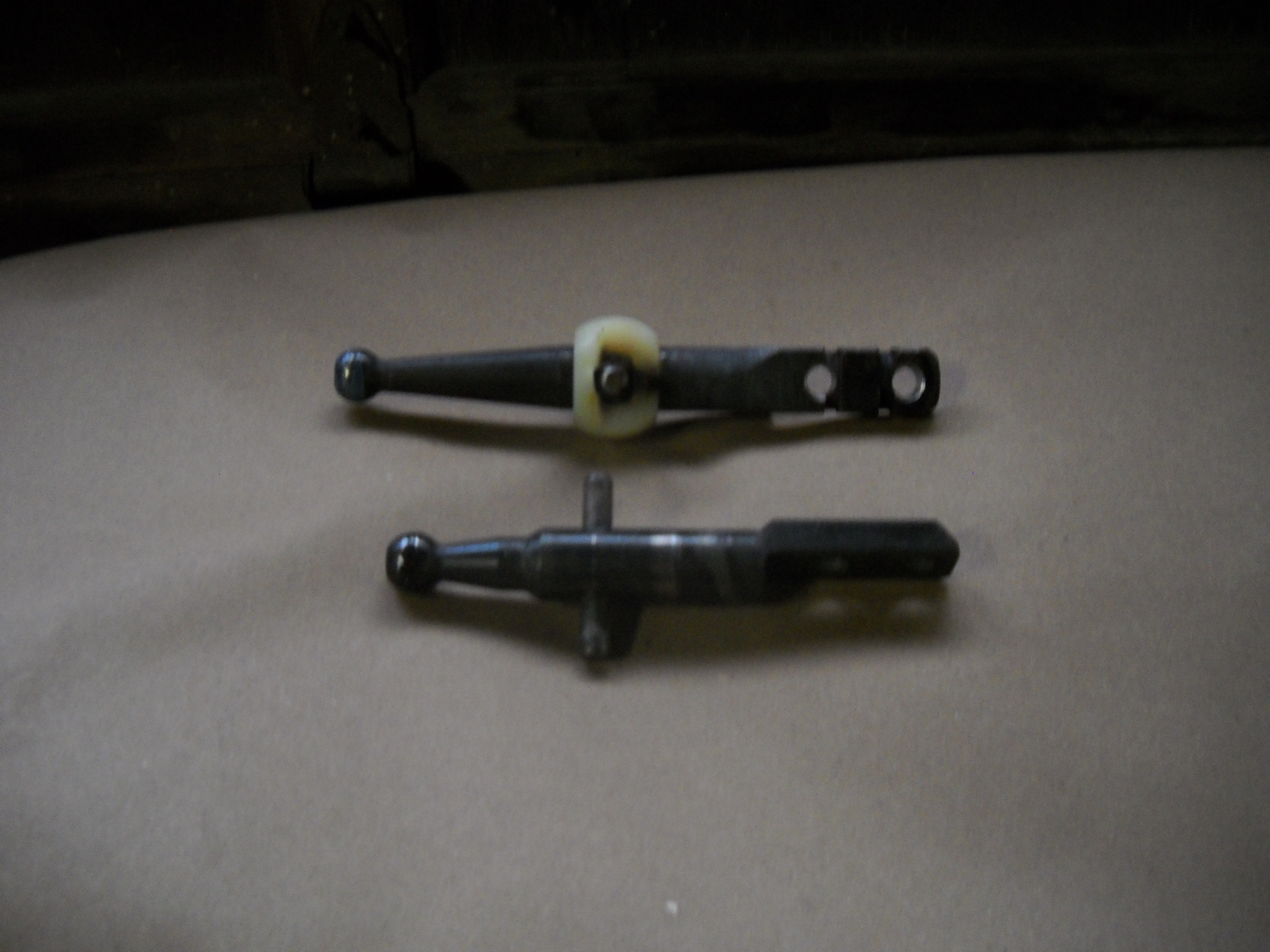

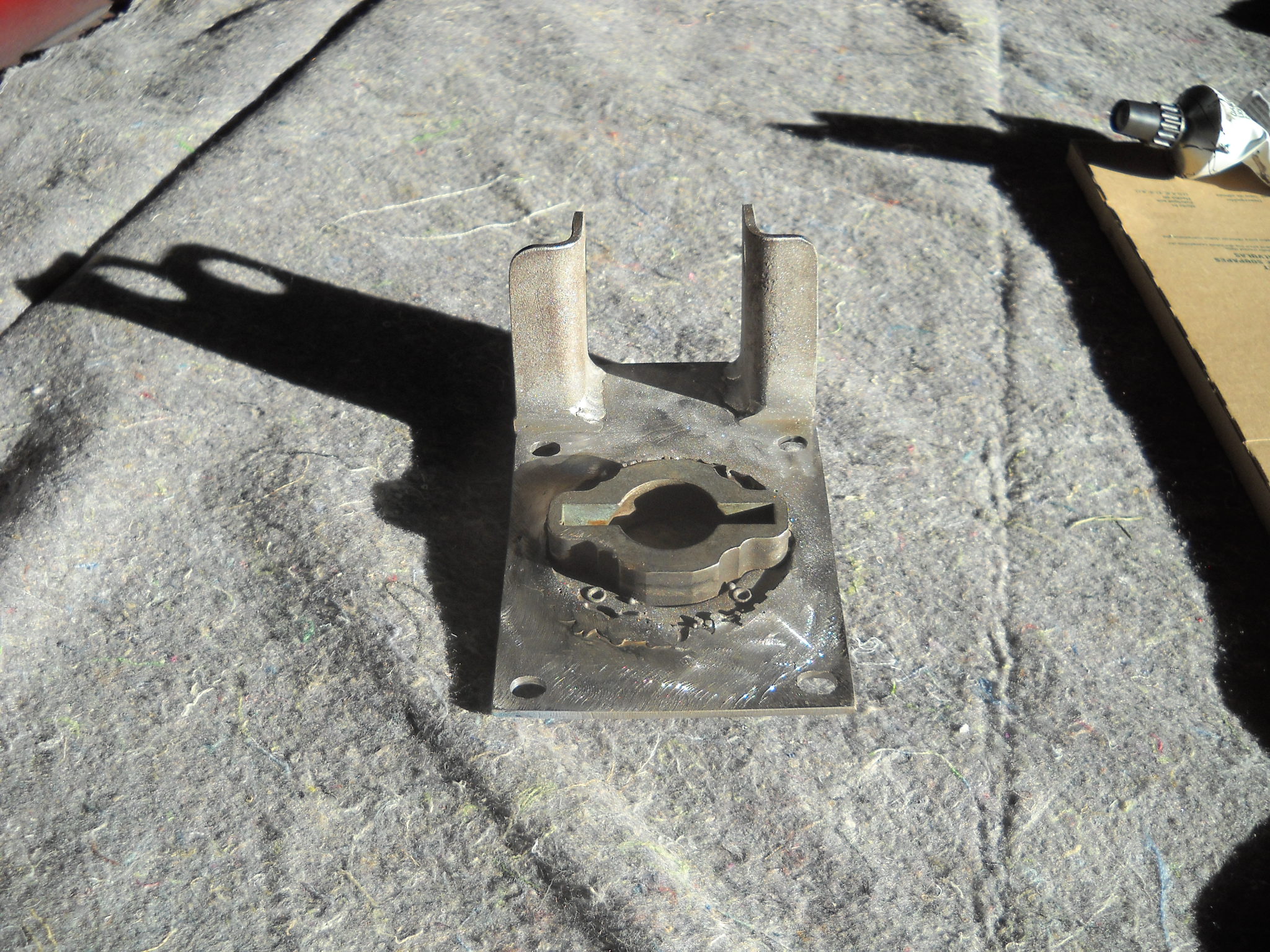

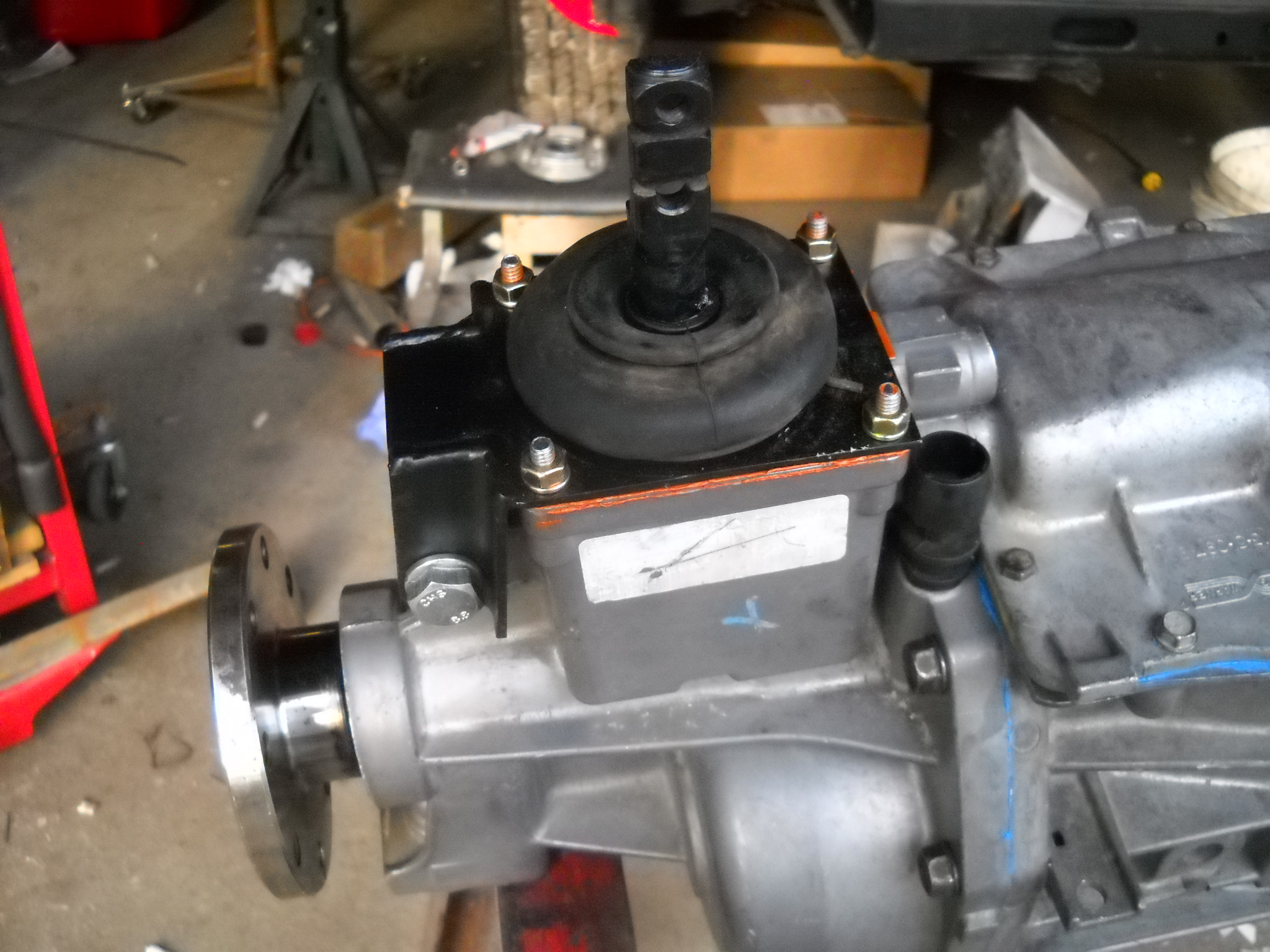

    I just finished building a T5 for a 64 Chevy 4x4 C10. It has a divorced transfer case, so a short T5 for a two wheel drive would work. I found that the 2004 to 2007 Mustang with a 4.0 V6 used a T5 that is only about 14" long, and has a drive flange on the back the same as the one used on an 8.8 rear end. The only problem, it is set up for a remote shifter. The shift tower location is similar, but not the same as a S10, so I set about modifying it for a direct shifter.
    Under the remote shifter there is a shifter block, the same one used in Jeep, and S10 shifters. I had a jeep shifter on hand, I modified the bottom of the shifter to be similar to a Mustang lower shifter. But the pivot pin in a Jeep shifter is 1" higher than the one in the Mustang. So you coupld use the Jeep lower shifter, and a spacer to mod a Mustang shifter for a short throw. In my case the truck has a long lever, so the shifter throw will not be that short, but I needed the extra length to reach the shifter block.

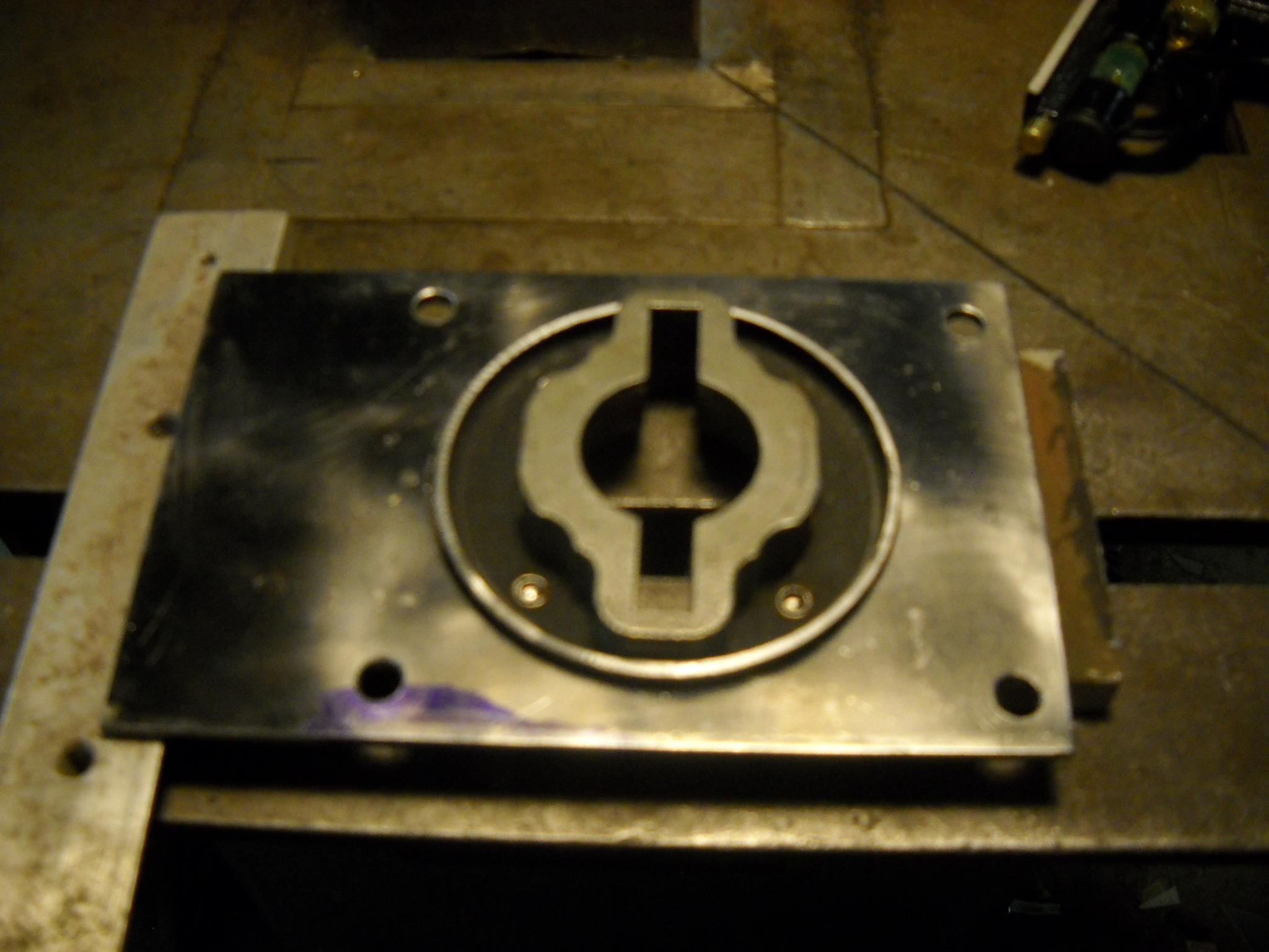

    I cut away all of the Jeep shifter base, and shortened it for this transmission. I then fabricated a new base that would fit the bolt pattern on this trans, with a hole in it for the Jeep tower.

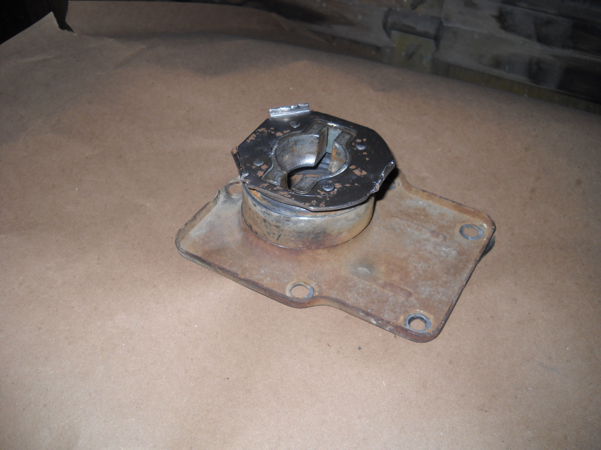

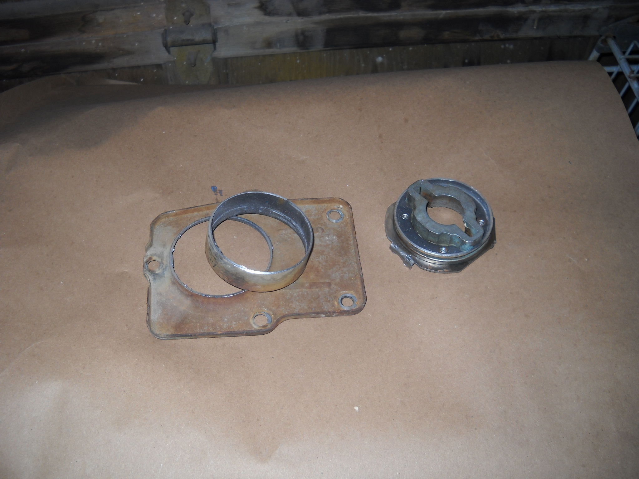

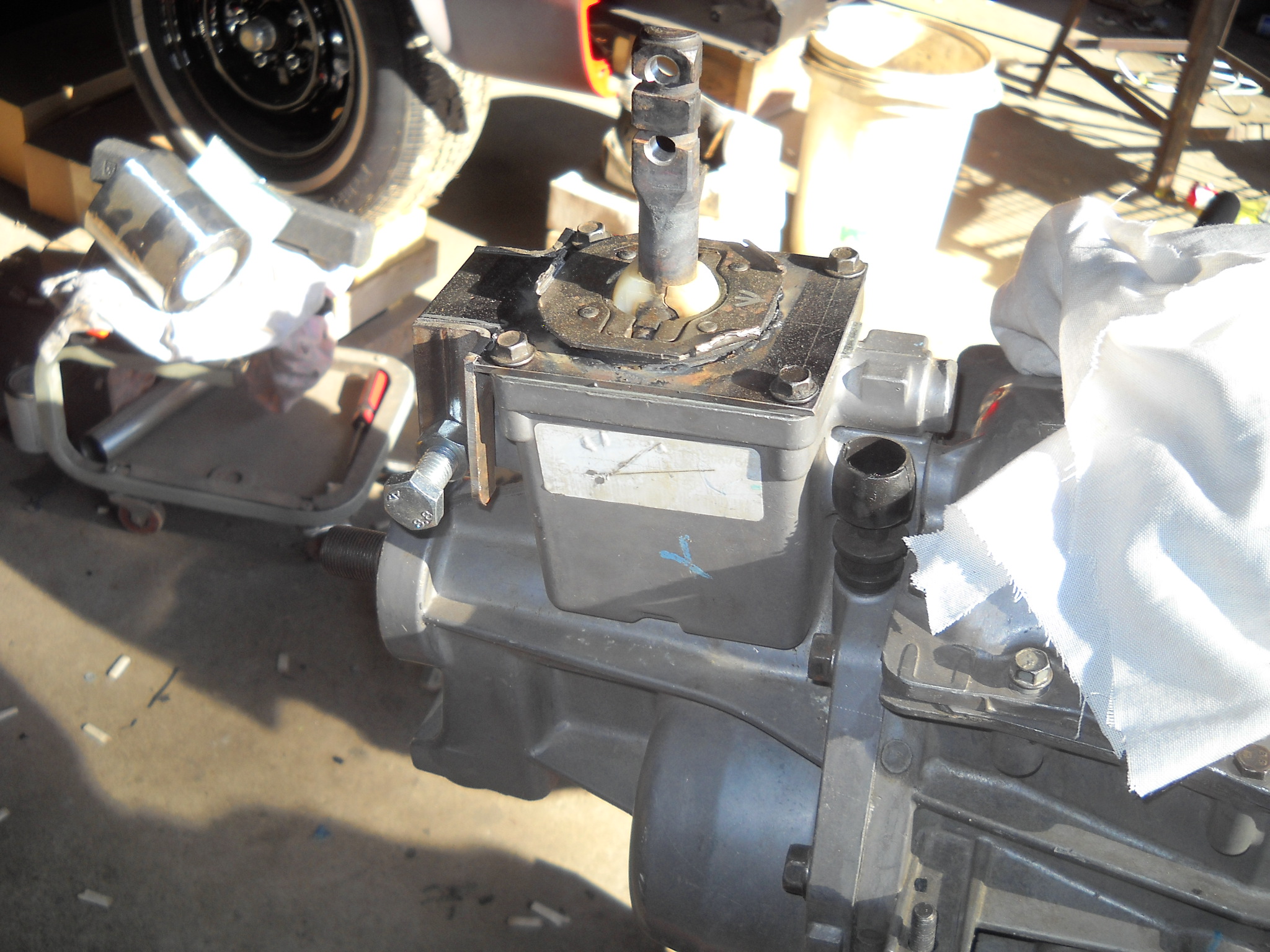

    I then welded the Jeep tower into the fabricared base. Since the bolts holding the base on this trans are 6mm rather than the 8mm bolts on the direct shifters, I retapped the holes to 1/4 20, and installed studs to go as deep as possible. I also added braces to a boss that normally holds the remote shifter. The Jeep boot went right back on.

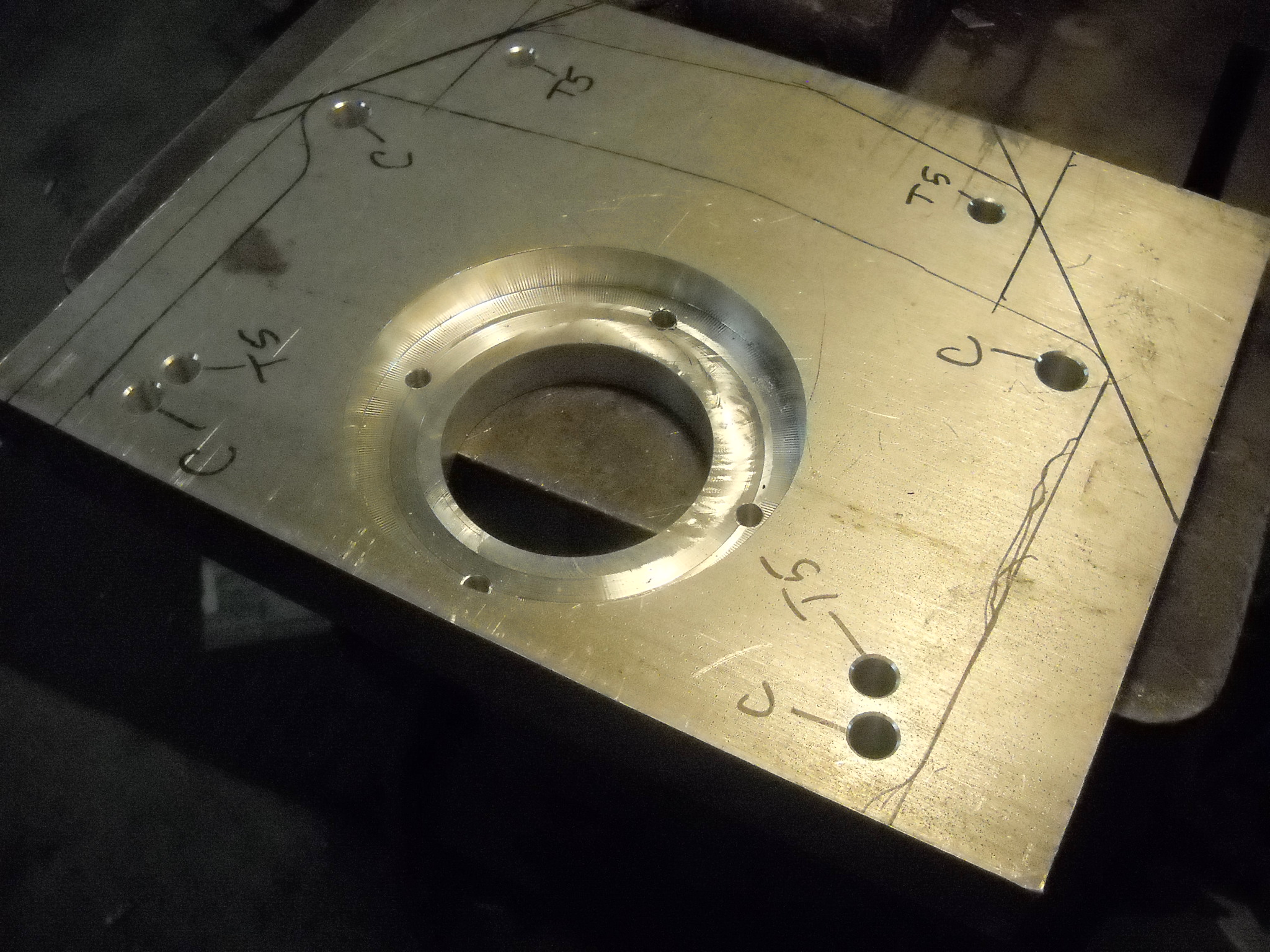

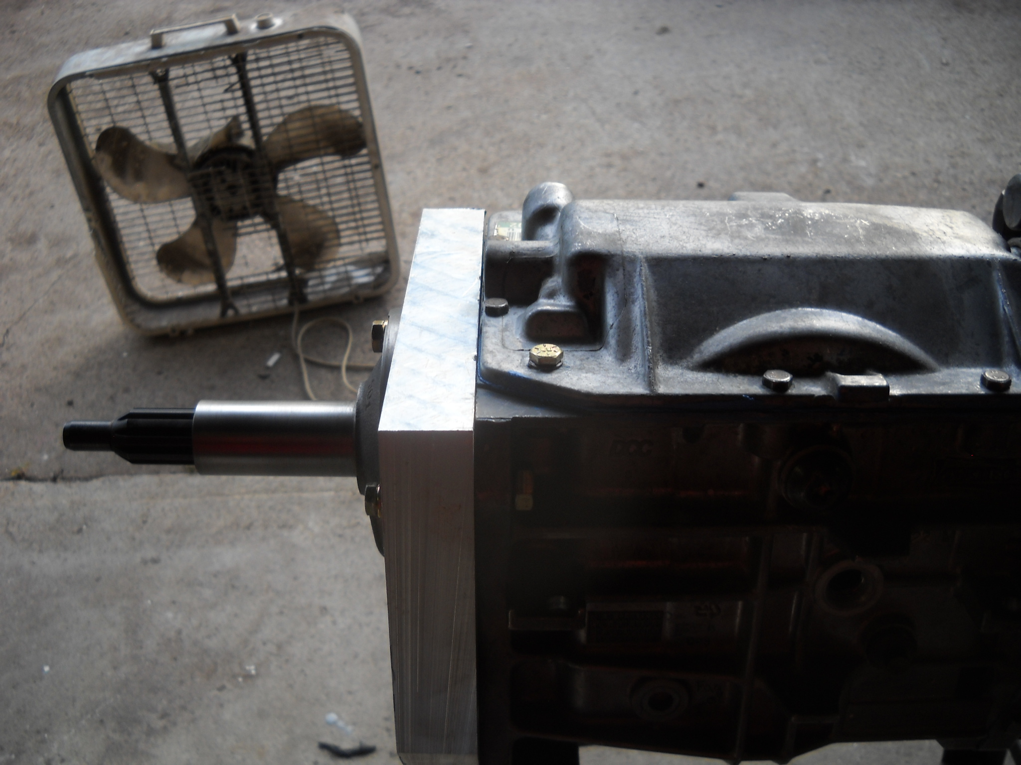

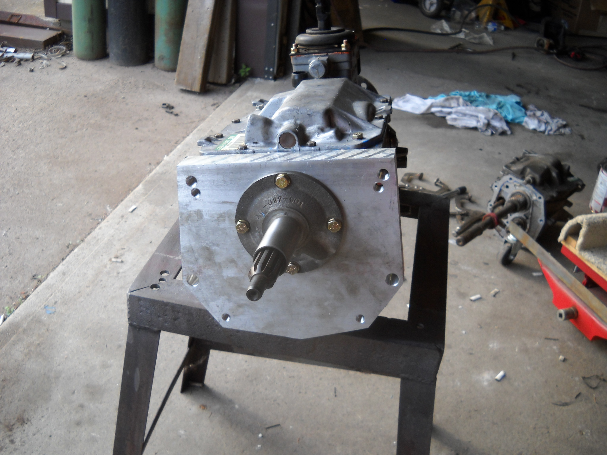

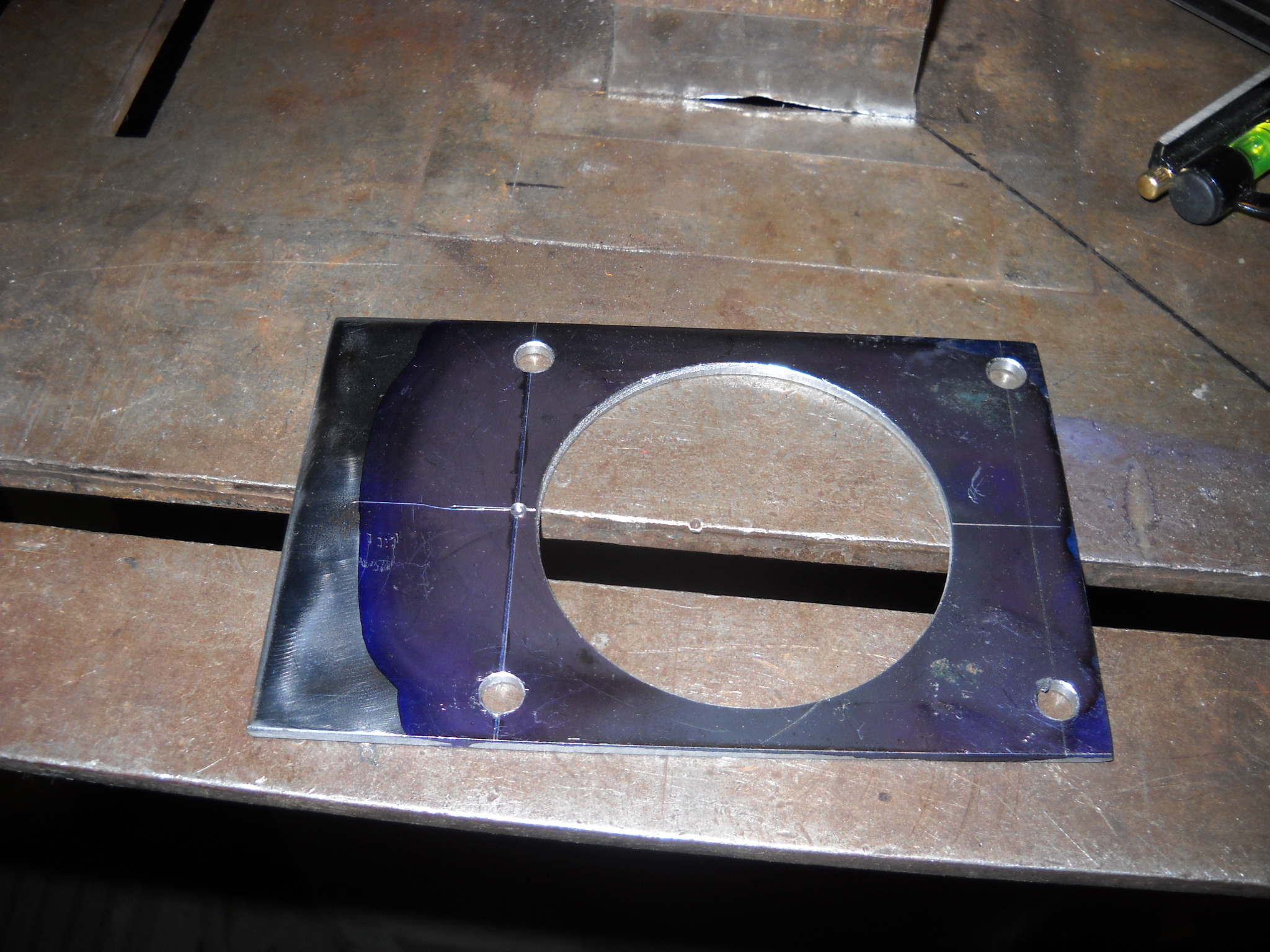

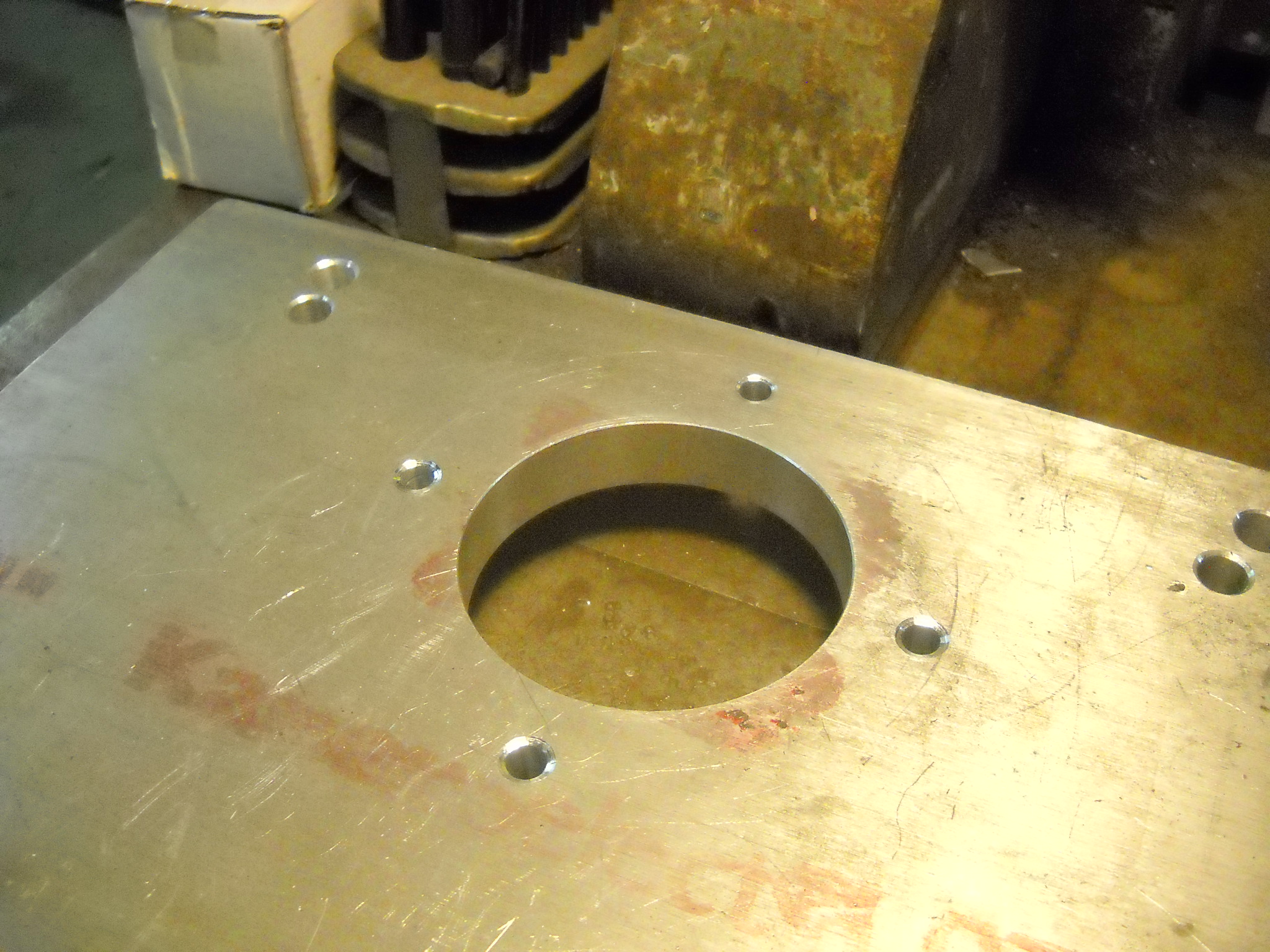

    Now I needed an adapter. The later Mustang T5 has a input shaft that is 3/4" longer than the Fox Mustangs. Also the pilot is smaller, but it is the same size as a Chevy pilot. I cut down the front bearing retainer so it was only about 1/2" thick. The adapter has to be 1.250" thick, I counter bored it to fit on the cut down bearing retainer. I bored the front side to fit a Chevy bearing retainer from a SR4 trans since it was the right size for the throwout bearing. I then drilled the adapter for both bolt patterns. The top bolts are too close to use bolts, so Idrilled out the bolt holes in the bell housing to 1/2", and used studs with nuts on the inside of the bell to hold it in place. I tapped the holes for the T5 to use the stock Ford bolts. 004.JPG 007.JPG 010.JPG View attachment 2655422 013.JPG

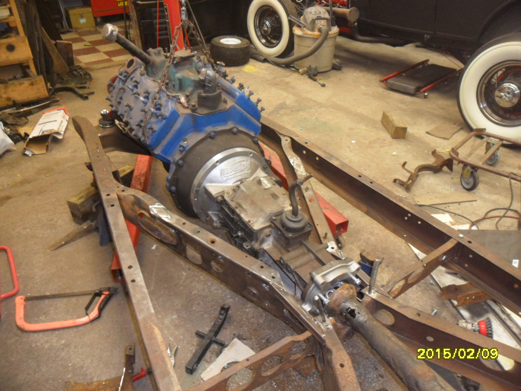

    Here's a picture of my '40 frame with a 4x4 s10 T5, it's not quite done ... welds to be ground, a little more metal work to be done, paint etc... crazydaddyo's adapter is under the top cross-member hoop in the first pic...
    forgive the mess, I clean when stuff gets in the way or I start losing track of other stuff
