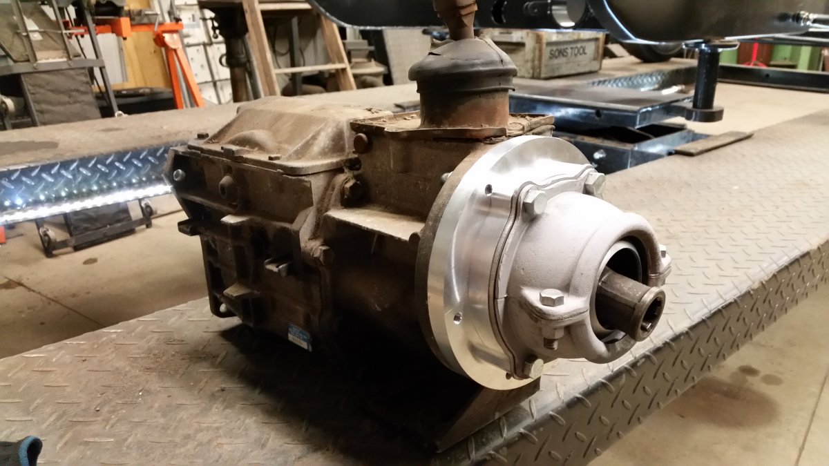

    I just finished building this one.It fits a Chevy torque tube.

  7. enjenjo
    Joined: Mar 2, 2001
    Posts: 2,767
    enjenjo
    from swanton oh

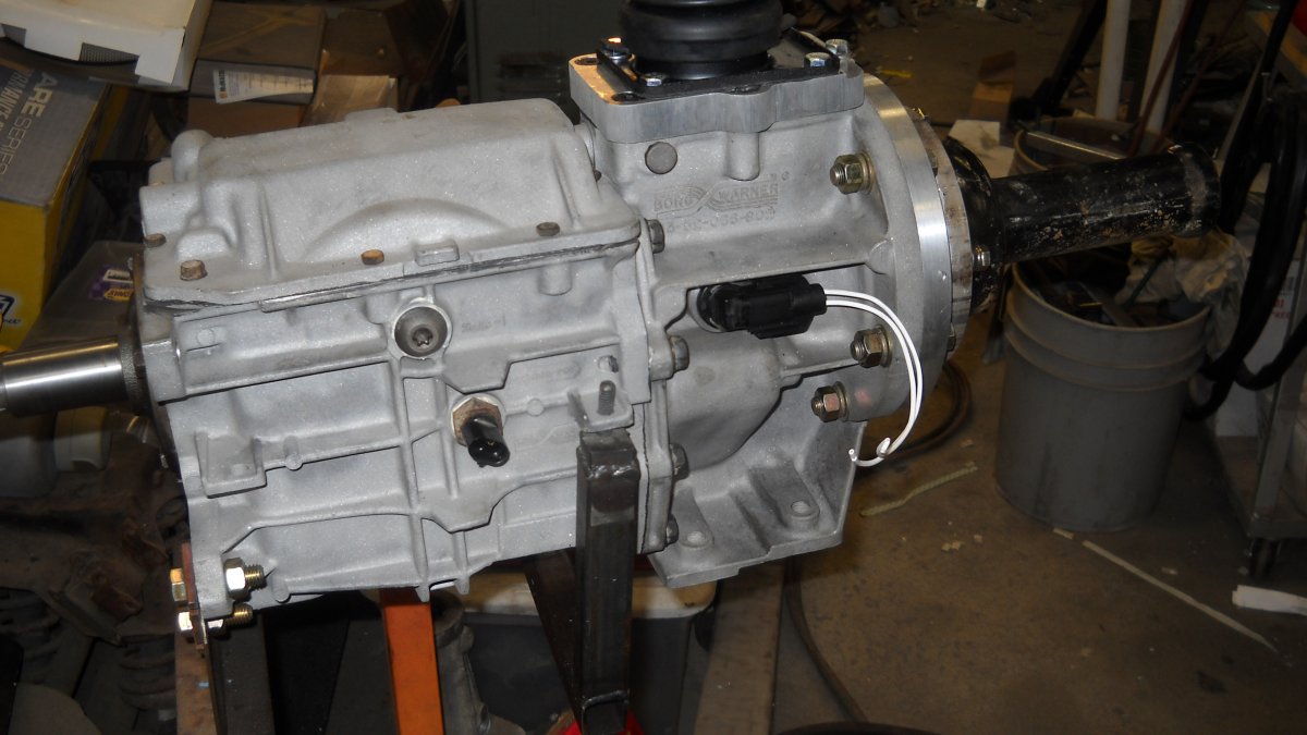

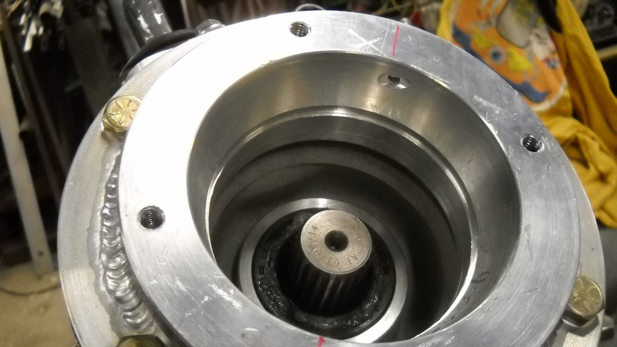

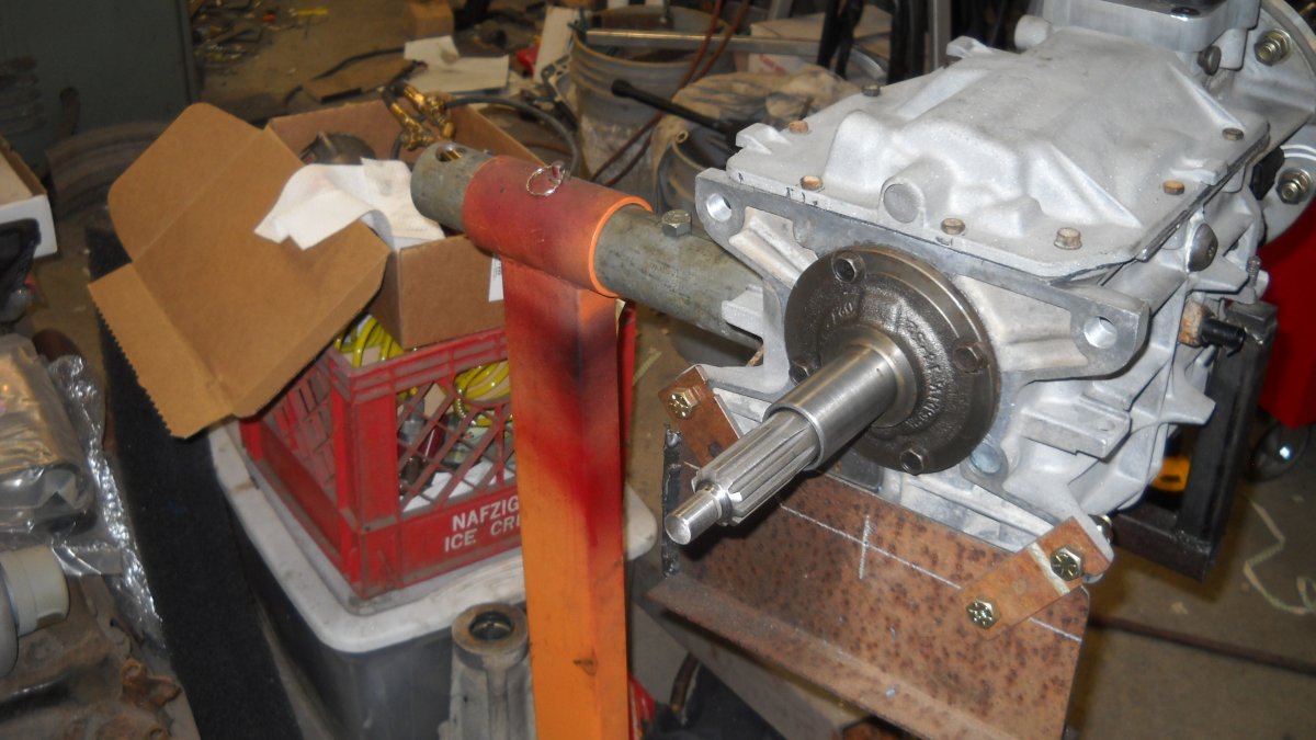

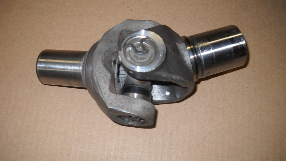

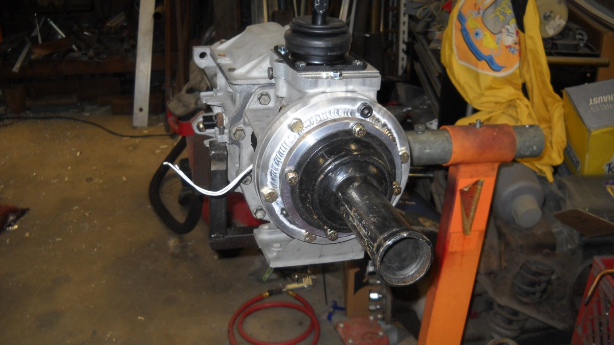

    I can make more, but it's not simple. Machine work needed on the adapters and the mainshaft. This trans is built on an S10 case with a shortened Jeep 1 1/8" input shaft to match the old Chevy clutches. It bolts up to a Chevy truck bell housing, after boring out the center hole in the bell housing, and shortening the throw out bearing sleeve. All the gears are from the S10 with a Jeep mainshaft and 4x4 adapter. The mainshaft has to be turned down at the rear from 1.406" to 1.386", and the splines recut deeper to fit a Toyota Tundra 23 spline yoke. The yoke has to be shortened a bit too. The yoke on the driveshaft side, I took a late model yoke that would fit a 1310 Ujoint, and bored it out to fit the splined part of the original Chevy yoke, pressed them together, and TIG welded it on both sides. If you can find one, a 41 to 46 Chevy 3/4 ton truck yoke will work without modification, but you then need a different Ujoint. I could not find one.
    There are two adapters needed, one to hold a bushing and seal for the Toyota yoke, and a second one to adapt the Chevy torque tube to the Jeep housing. This one has to be bored with a ball cup to fit the Chevy torque ball, and drilled for the ball retainer. I used two pieces, and welded them together because I did not have one piece thick enough.
    I used the S10 detent block, and shift tower with the Jeep lower shift lever as this allowed me to move the shifter forward 1" from the stock position.
    You could do the same with a Ford torque tube, but it's simpler because the torque ball is reversed, and a seperate piece, and will bolt on the adapter.
    This one is using an electric speedometer because there is no place to put a standard mechanical speedo drive. I used a Ford VSS, and machined a reluctor wheel out of a crankshaft timing gear
    bct, Crazydaddyo and brad2v like this.

    Great work. I have a jeep t5 on my stand as well. I have been working on a solution for the ford v8 torque tube. I think I am going to machine my own yoke for the trans side and use the original ford torque tube yoke for the drive shaft side.

    Here are a couple pics of my jeep t5 to ford v8 torque tube adapter. I used the original ford u joint, made a spline adapter and drilled and tapped the jeep output shaft. It will work exactly like the early ford torque tube transmission as far as the yoke side goes. I made 2, if anyone is interested, I have one complete set up I would sell. You use your yoke and clamshell. PM me if interested. More pics to come. Thanks.
