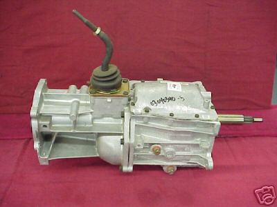

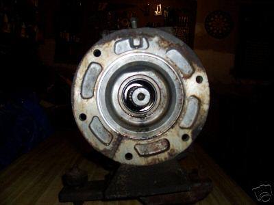

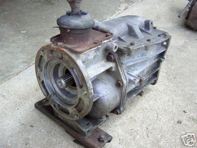

    Finally one of the $64 questions I've been waiting for someone to ask (I've already pestered him with the 20-questions routine) - what yoke to use. ;)
    Whipping up the aluminum plate is pretty straight-forward work - how to go from the 4WD S10 output to the early Ford U-Joint is the trick. I'm not familiar with the 4WD S10 ****** (never had one in my hands), but the Jeep one has a seal that requires a shaft with a seal surface (like a slip yoke in a regular 2WD application - except it's an odd spline). It makes sense the S10 would have a seal too, but I honestly don't know.
    FWIW, you can either start off with a 4WD S10 (or Jeep), or you can swap the output shaft & tailhousing from a 4WD S10 onto a 2WD ******.
    Here's a couple pics - You can see the length difference between Jeep & S10 4WD applications. You can also see the seal for the Jeep version.

  29. Ernie or Crazydaddyo,
    Could you tell me the overall length of the Jeep T5 casing pictured?
