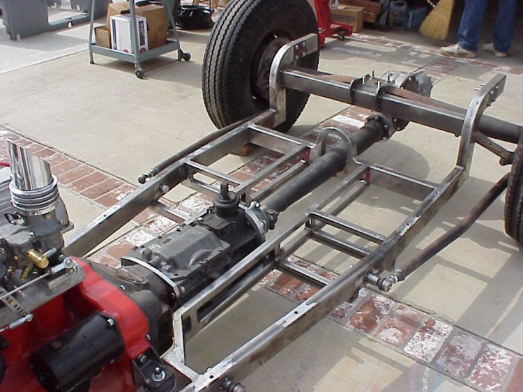

    Bill,
    From front face to rear flange is 15". The S-10 4wd is @ 20".

    I'm using a stock Model A bellhousing with an addapter plate I made.
    Mac,
    Your adapter is expensive because your adapting a front wheel drive engine to a different trans. You would have that cost regardless of which trans you used.
    There are several options for adapting a T-5 to a banger or V-8

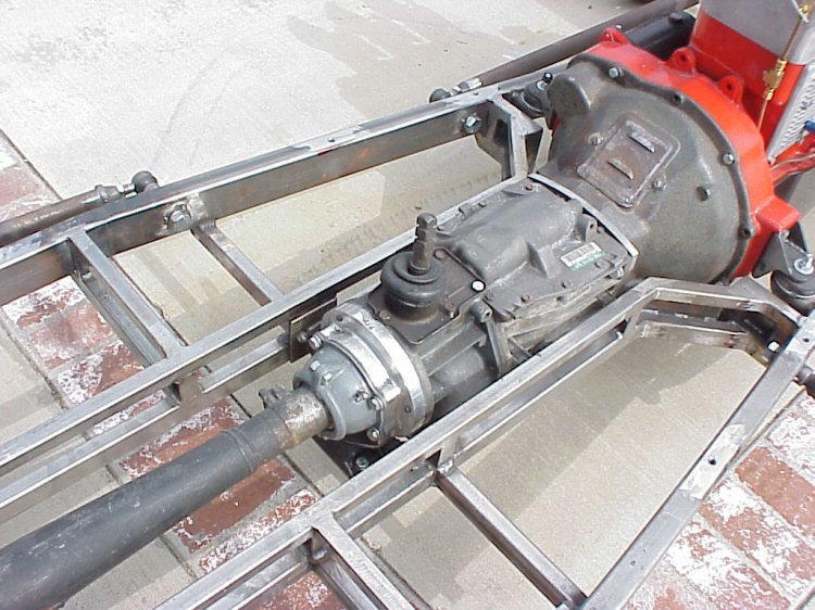

    hey daddyo for refrence could we see pic of your trans adapter plate

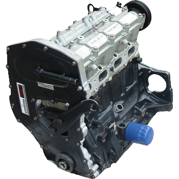

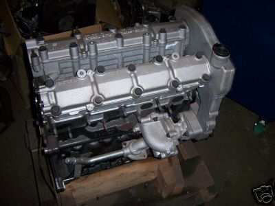

  23. Crazydaddyo,
    Yeah, I know, but I was looking for an engine that captured the idea/look of a Fronty DOHC, and the Quad4 does a nice job...
    Here's the Fronty
  24. And the Quad4

    Sorry, I don't have a picture of the plate by it's self. The plate is 1/2" thick and bolted to the stock "A" belhousing through the stock trans mounting holes with 1/2" flathead socket screws. I bored a hole to register off of the front bearing retainer. I cut the plate to the shape of the T-5 mounting flange In this case the Jeep T-5 (same as Ford T-5). Then transfered and taped the mounting holes for the T-5. The bearing retainer for the T-5 is bigger then the locating hole in the "A" bell housing so I had to indicate the hole in the addapter concentric to the hole in the bell housing. Once located, I doweled the adapter to the bell housing. Other wise it makes aligning the trans to the clutch almost imposible.
    Here are some pictures of the ***y. and a CAD layout of the plate.

  28. sko_ford
    Joined: Sep 27, 2002
    Posts: 3,010
    sko_ford
    cool thats much simpler then waht was rooling around in my head
