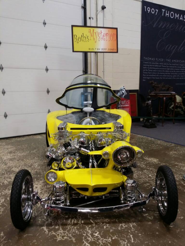

    I was at a charity Christmas party at the Stahl Collection in Chesterfield, Michigan on Wednesday.
    I was SO EXCITED to see this!
    The Stahl Collection contains some amazing, rare and valuable vehicles, memoribilia and automated musical instruments.
    Jeff's Mysterion drew a crowd!

    WOW! Finally found out who bought my car! Thanx for the photo. I so hope he puts it on display so people can enjoy Ed's genius.

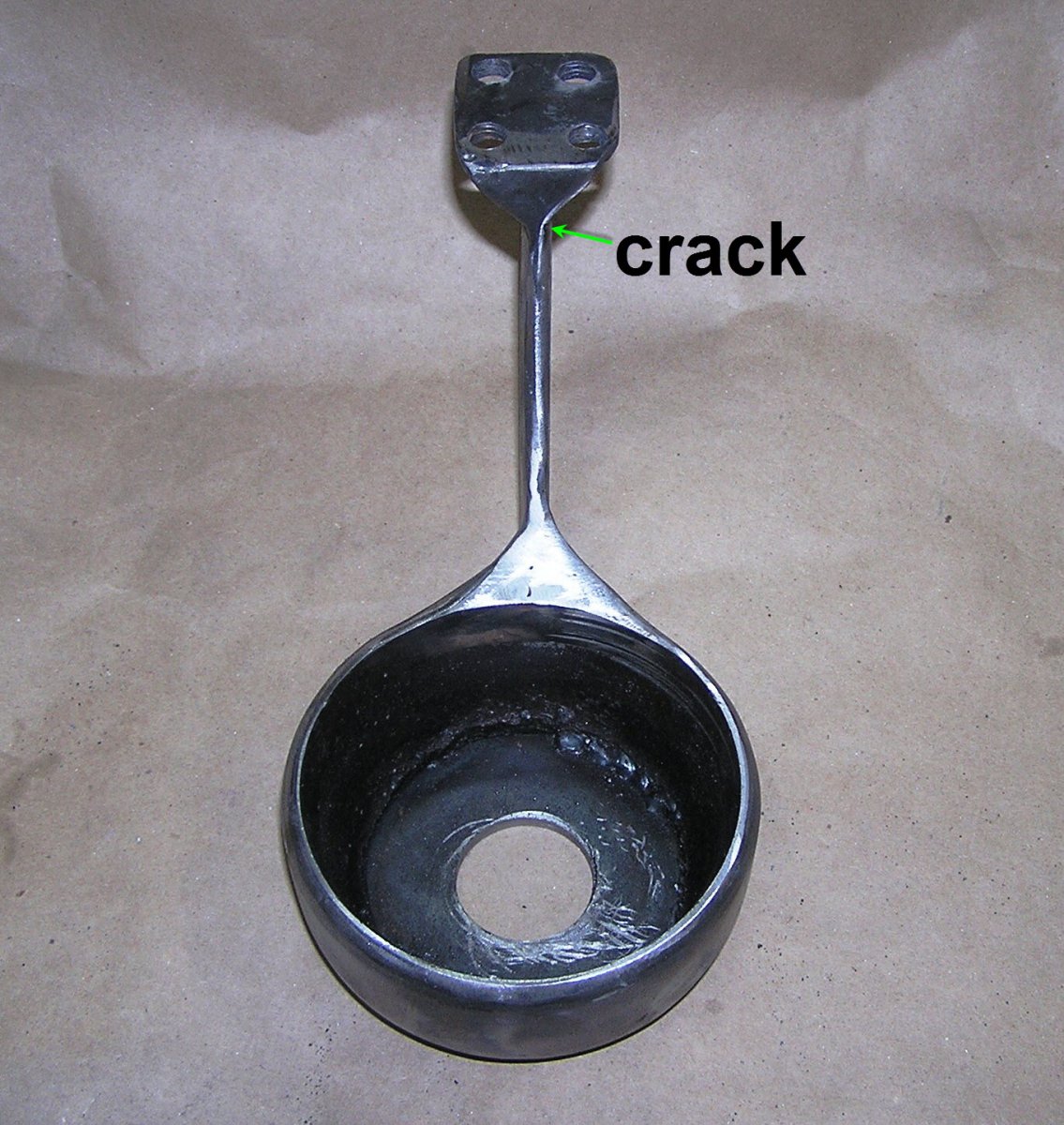

    I've been in contact with the mechanic at the museum talking about the car. He had a lot of questions (I knew he would!) about how it goes together. Most gratifying is that he wants to consult with me on any changes they need to make to be sure those changes don't compromise the authenticity I strove for. He said they museum is thrilled with the car from the owner to the janitor! It appears it couldn't have gone to a better home.
    He said they did find a crack on one of the spring hangers that bolt to the rear axle. I had gusseted those brackets to avoid that but he said the crack started below the gusset. It was on the p***enger side one to which bolts the pan-hard bar and the side forces of that bar on the bracket from the bouncing 2000mi trip in the transport truck initiated the crack. We discussed a fix to beef up that member to prevent further such damage. The bracket on the other side of the car was fine since it doesn't receive that side loading. Trucking show cars is really tough on them! We also decided it would be good to set the frame on blocks during shipping to unload the delicate suspension on this car. They are going over the car with a fine toothed comb to beef up weak points to prep it for a lot of trucking around the country to various exhibitions.

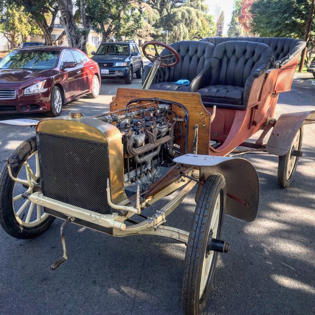

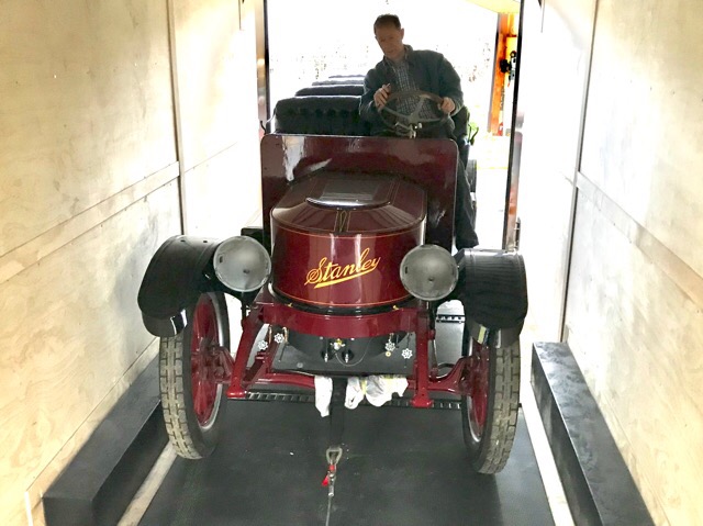

    But a hauler should never tie to a spring hanger.
    They should use axle straps to the axle or frame.
    They should not tighten down against the suspension,
    if it is set up properly - it should be allowed to travel freely
    up and down.
    I routinely transport fragile vehicles - some are over 100 years old.
    I fasten at (4) points minimum & pull towards the center,
    this keeps the vehicle from being pulled apart.
    Putting the frame on blocks & fastening down against the suspension
    still puts a load on the suspension - if the vehicle falls off the blocks
    it can shift inside the trailer and get damaged.
    It is better to block all (4) wheels from the side to the trailer walls
    to eliminate side shifting - you can also block the front & rear wheels
    from moving forwards & backwards.
    If you are going to provide tie down points to the car - bolt or weld (4) points of attachment to the four corners of the frame.
    1904 Ford Model B - the only unrestored original of (5) known
    1915 Stanley Steamer 12 P***enger Mountain Wagon - one of two hauled last year - there are less than (10) remaining - I have transported four total of those - about $2.5 million valuation for all.
    Jim

    They did tie to the axle, not the hanger. The bouncing in the truck swayed the body on its springs and the pan-hard bar stiffened that spring hanger so it stayed still while the body/ch***is bounced up, down and slightly sideways with no shock absorbers in the rear to dampen the stresses. That was a fatigue crack, not an overstress failure. Mysterion was NOT a well designed automobile but was a superbly designed piece of art. This defect is easily worked around for future hauling. The museum mechanic has a lot of good ideas to modify the design while not affecting its authentic appearance.

    But that car has been transported countless times - sometimes chain binders are use in transport - sometimes hooks are used to any secure looking point of attachment.
    It is a good idea to have an engineered & designated point of attachment for transport purposes on any custom built vehicle.

    That's the approach they are taking. With the beef I built into the repro ch***is and with the more beefing they are adding I imagine it will be fine for the duration. Back in the day Ed was cranking out a car per year for Revell so he didn't have time to give these issues any thought.

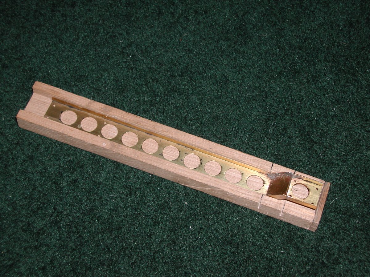

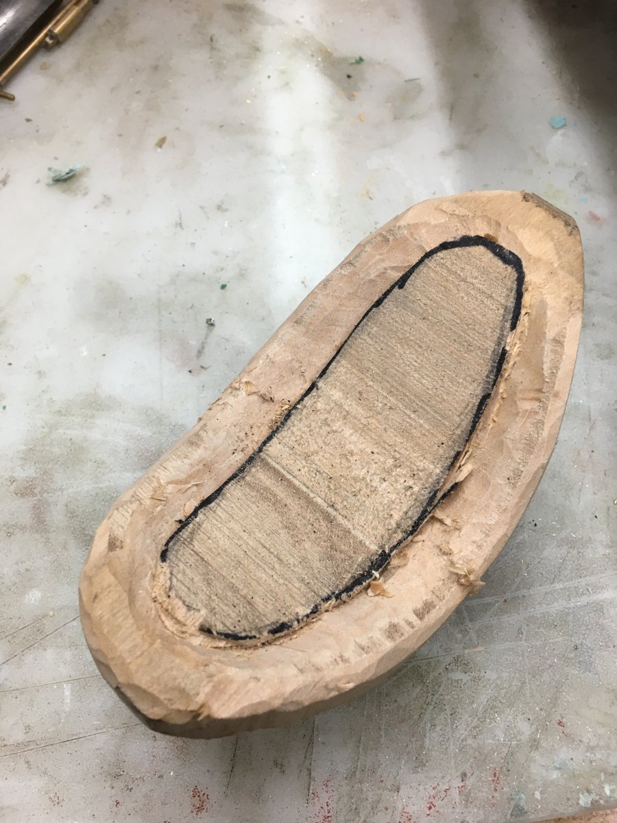

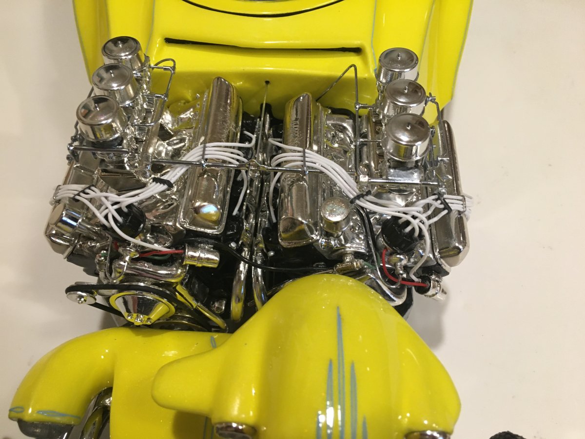

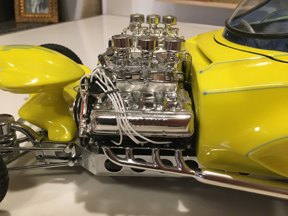

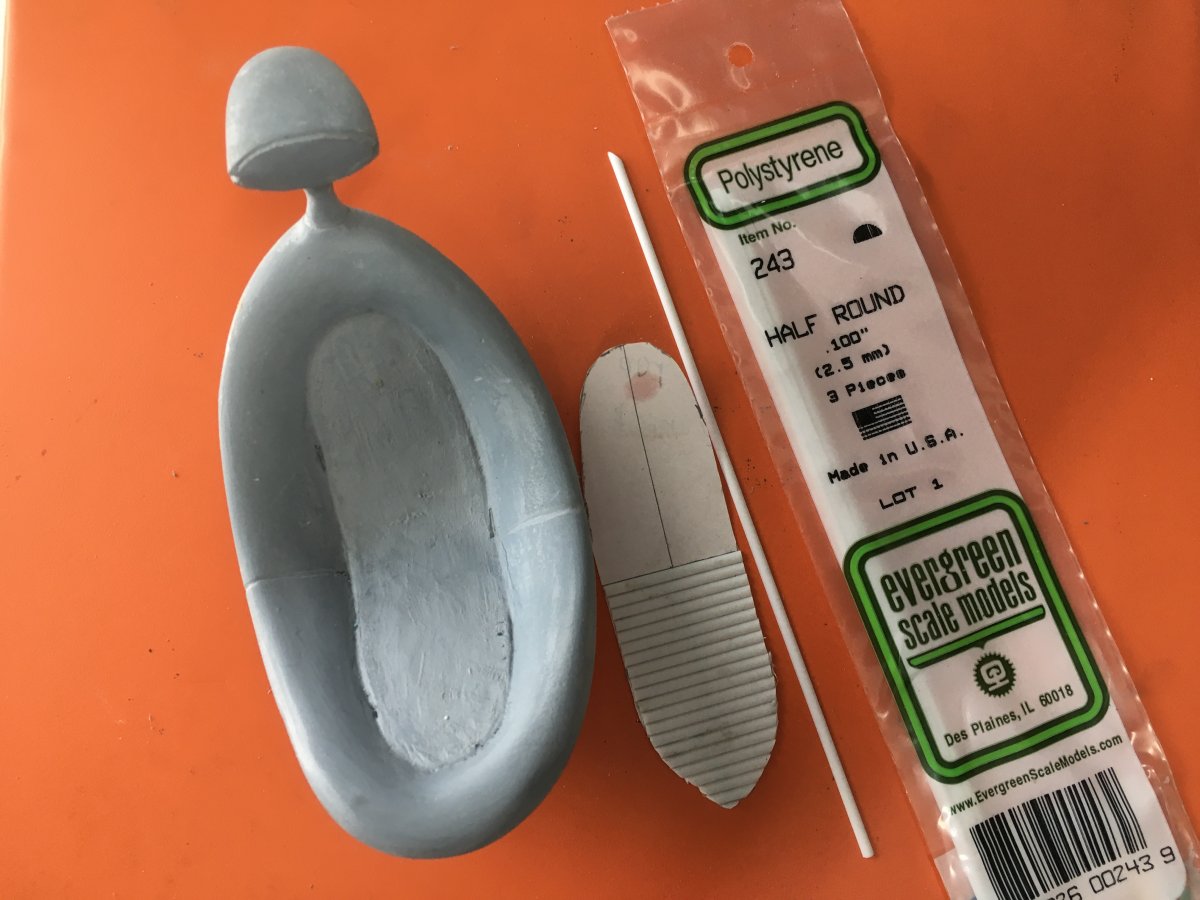

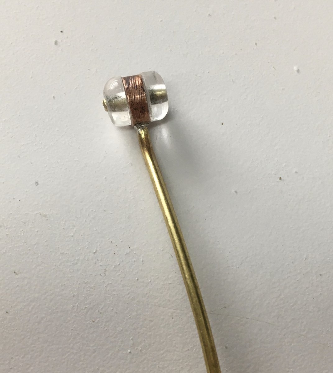

    I just finished my 1/8 scale model of the car. I actually started the model in 2001, years before building the 1:1 version. I made the fiberglas body and nose and bubble top, engines ******s, frame rails but hit a wall making any other parts since I found I didn't know enuf about the car. After the big build I was confident to finish the model. I was asked by Mark Gustavson who runs the National Model car Museum in Salt Lake to give a presentation on the model at next May's GSL Model Contest and convention. This will be the final contest after a couple decades run. I am very honored.

    Oh man!!! that is wonderful!!!!

    Holy ****!!!

    Jeff, you just blew my mind, awesome!
    Simply amazing detail!

    You Sir have an obsession ...That car was beautiful then and it's beautiful now.

    Mark there"s your shifter!! Well knob wise. :D

    It aught to be pretty good. Been working on and off on it for most of 20 years!!!

    I am lucky to have been blessed with good patience. Started this model in 2001, worked on it for a few months, then put it away until this year. Never considered not doing it, God willing. Don't see the burden of the big project, am able to only see the task at hand; carve a seat, solder up a spindle, etc., etc. I keep making parts until I can't think of any more to make, stand back and look and viola! a finished project!!
    I also make it a point to NEVER care about the cost or time involved. I spend money on a project if I have it, don't spend if I don't. Unfinished projects sit around until I have the motivation to attack them. Usually takes a motivation like Mark Gustavson asking me to display the model @ the GSL model show in May. Or the wife saying a honey-do has to get done!
