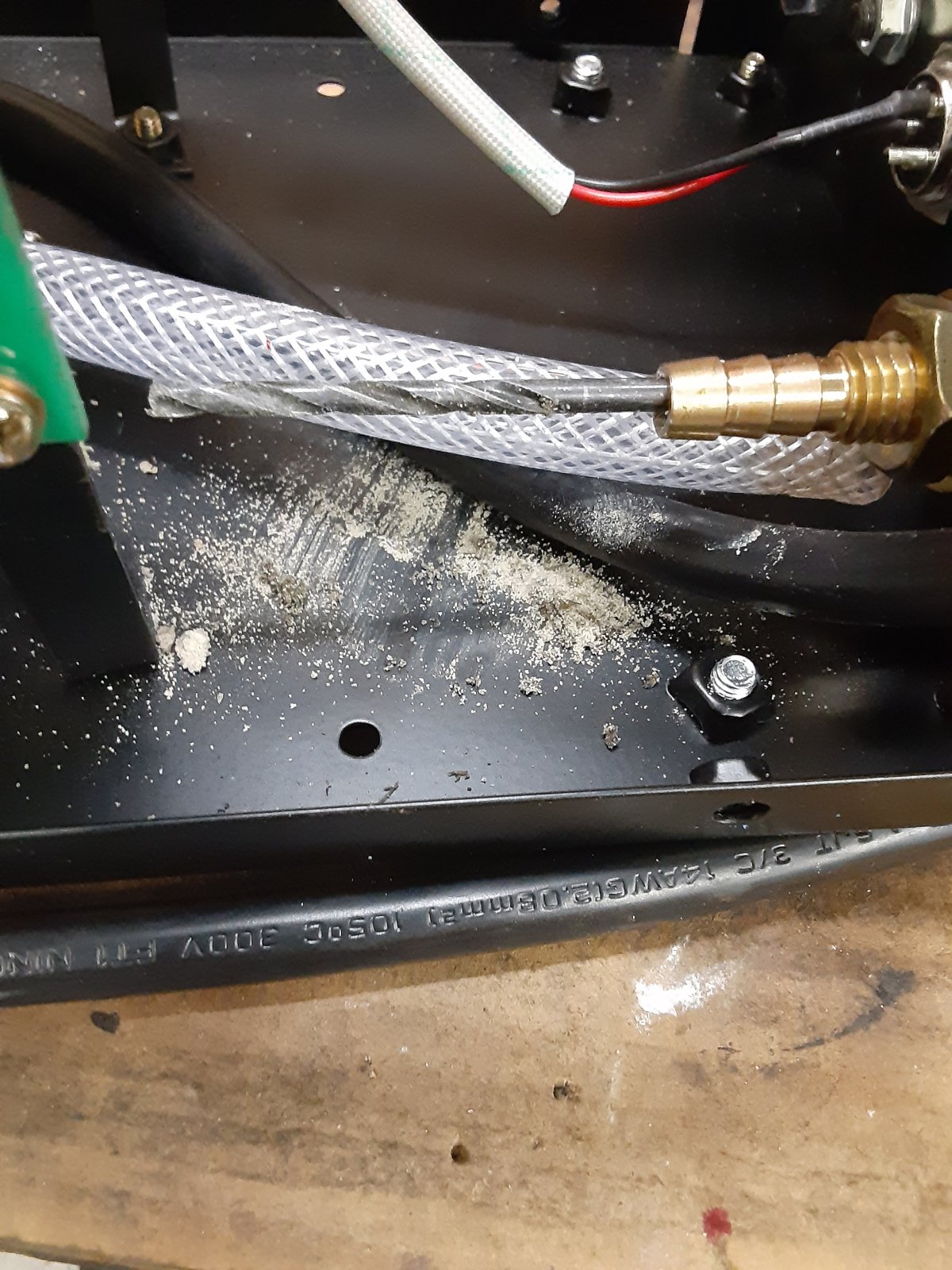

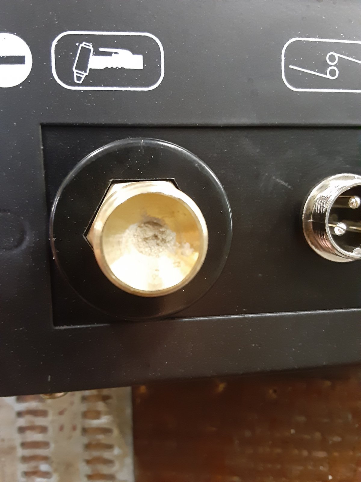

  22. AGELE55
    Joined: Jan 4, 2018
    Posts: 669
    AGELE55
    Dammit Lloyd ! This is all your fault...lol. I bought a new el cheapo plasma cutter off of Ebay and was way impressed with it ... until a couple weeks later. I tried to use it and ****... a bright white "lifeless" arc. Troubleshooting revealwd no air flow. Further investigation and I found a damn mud dabber nested in my air line. What are the odds.
    Had to dis***emble and blow out the hose and internal gizmos. Works 4.0
