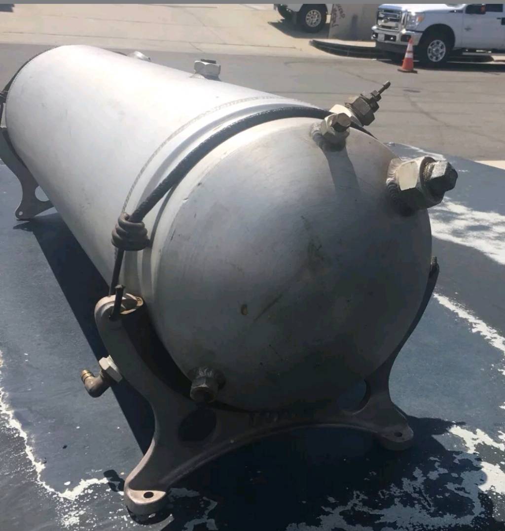

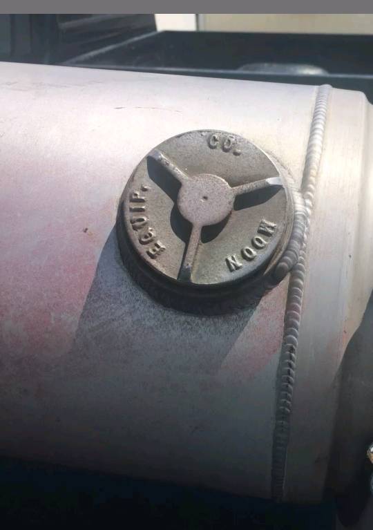

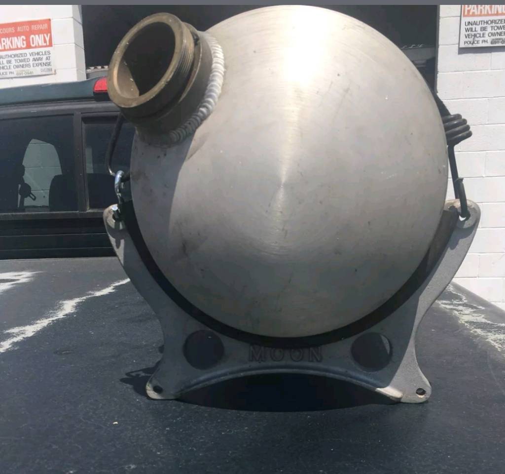

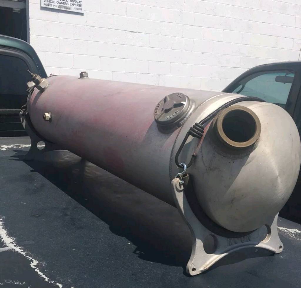

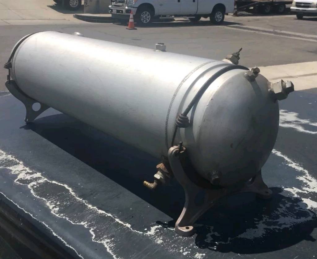

    Purchased a cool oversized Moon tank which came with a neat story. Going to use it as my fuel tank. Dean Moon made it for his engine dyno set up. Cool info....
    Hey Jerry ,
    ok so my Uncle, Alan Welch, had a engine balancing business named Automotive Balancing Service which goes back to the 50's. His Partner Richard Bauman also had a mail order engine shop named Speed O motive which was sold to George Ullrich in the early 90's. So My uncle purchased the dyno From Dean Moon so he could test some motors that they would be selling through Speed O Motive. this was in the late 70's and I remember that dyno room and that ol tank with several others set up there. I was about 10. I will try to track down some old photos but to be honest don't know if we have any. To bad cause that would be great all around. So the mail order shop was sold and both Alan and Richard have p***ed on. Years ago that dyno was parted out as it was old school stuff by then. The tank was all that remained from that program. My pops has been cleaning out some stuff from his shop/man cave and yea now it's going to a great home.

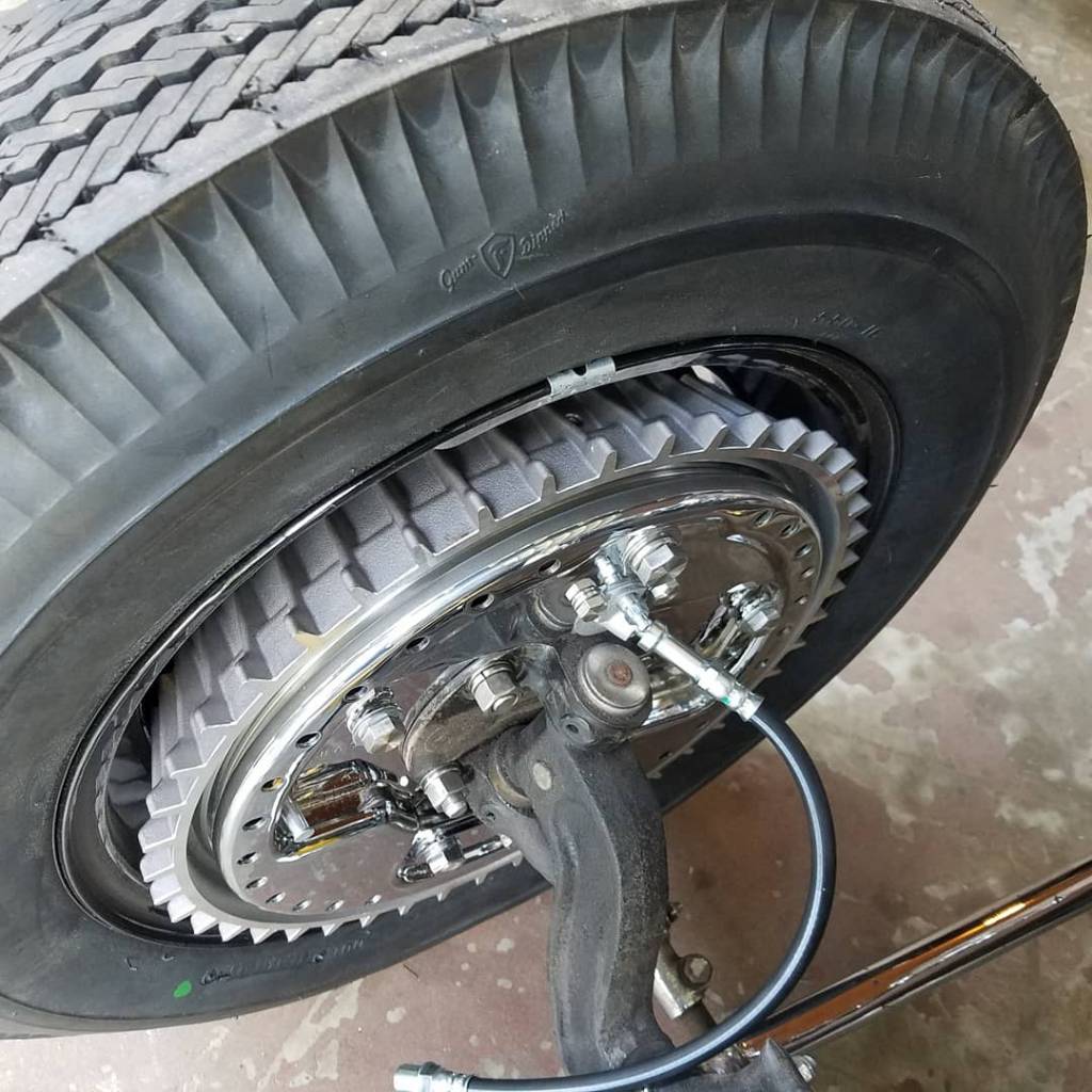

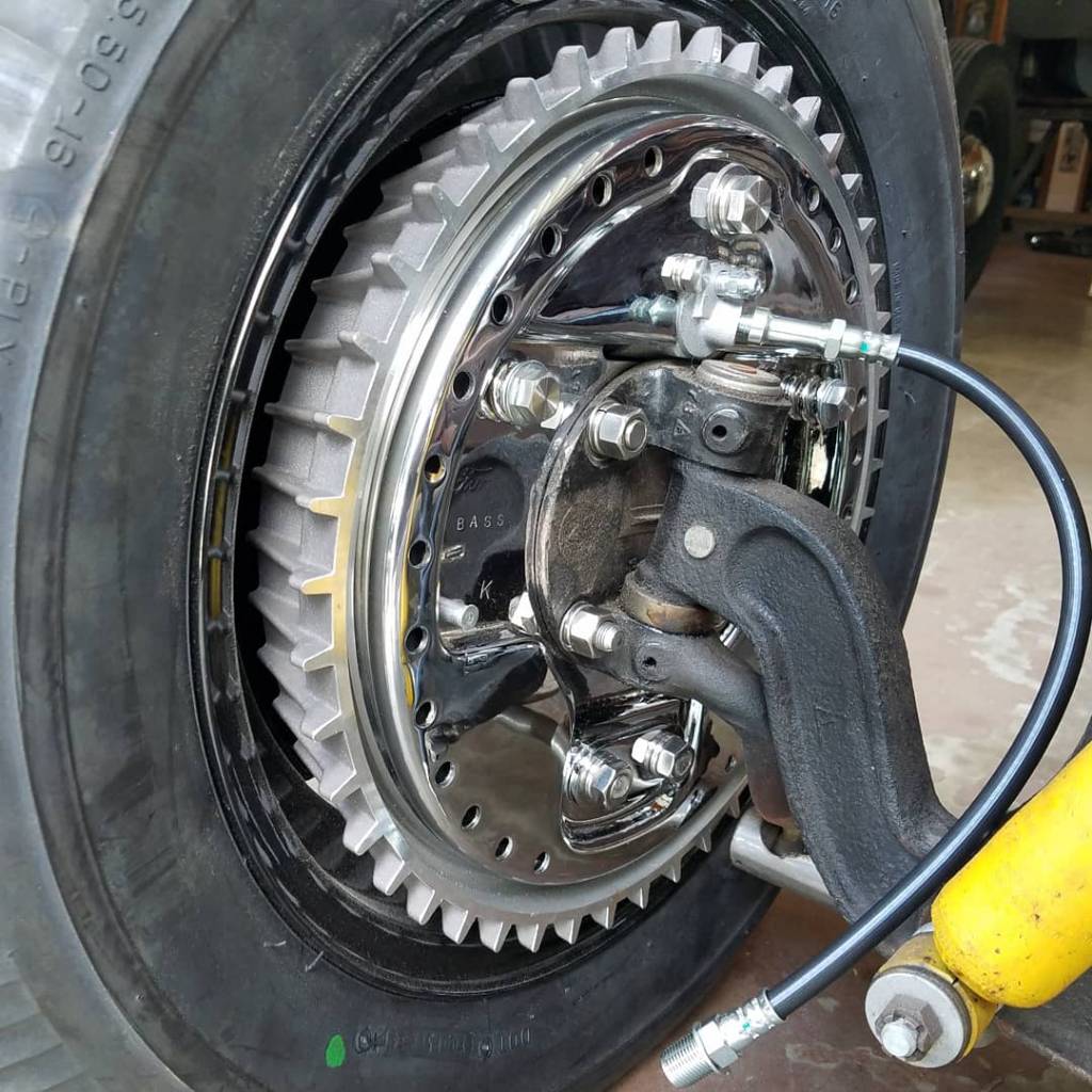

    Boling brothers finned edge drums came in today. It's a neat product they are making. Steel drum with Buick sides. They fit right over top a stock 40 hub with no machine work needed. They should work great with the B*** brakes. IMG_20180806_122915_197.jpeg IMG_20180806_122915_184.jpeg 20180806_122202.jpeg

    I’ll be watching how the drums perform. I’ve had my eye on this for a little while for my 32pu.
    Your brakes are turning out beautiful!
  10. HomemadeHardtop57
    Joined: Nov 15, 2007
    Posts: 4,340
    HomemadeHardtop57
    Thanks, I've heard good things about them and they look very nice. I have heard that sometimes that these drums will need to be checked and turned a bit, even though they're brand new so I will have them checked. The drums themselves are the MT ones. Boling Bros. machines and presses a new cast Buick outer on overtop and pins it to the drum for safety. Its a great idea. A buddy of mine purchased a pair when they first came out and they seem to perform very well on his car. The B*** brakes basically function as good F1 units so they should work really well.

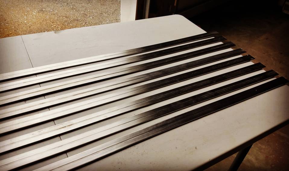

    I was also able to make a bit more progress on the homemade Pines grill insert IMG_20180806_174301_989.jpeg

    Did you see how I flattened the sides of a 7/16” stainless tube for the center strip for my pines clone?
    I will weld the top and bottom pieces into it

    My outside piece is an original stock insert I got for a hundo. Most of the bars were messed up or missing. I hooked up other HAMB’rs with what was salvageable and was off to the races on this project. I’m confident that the Pines were at least a 1/2”. I am now planning on making a more accurate outside for ct1932ford from scratch if I could find out how thick they really are.
    You let me know or I’ll let you know?
    I made my bars out of copper(gonna piss on’m) with my bead roller. It’s all on my thread.

    The moon tank that was on Dean Moon's engine Dyno showed up today. At first I didn't think it was going to fit in the car because it's huge. It actually tucked in nicely right behind the seats
    Threw it in and mocked it up
    IMG_20180808_170317_528.jpeg 20180808_143327.jpeg 20180808_143452.jpeg 20180808_135257.jpeg

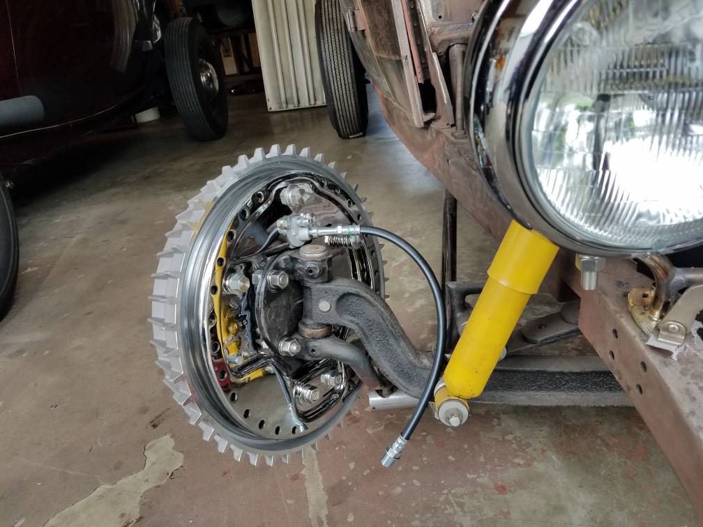

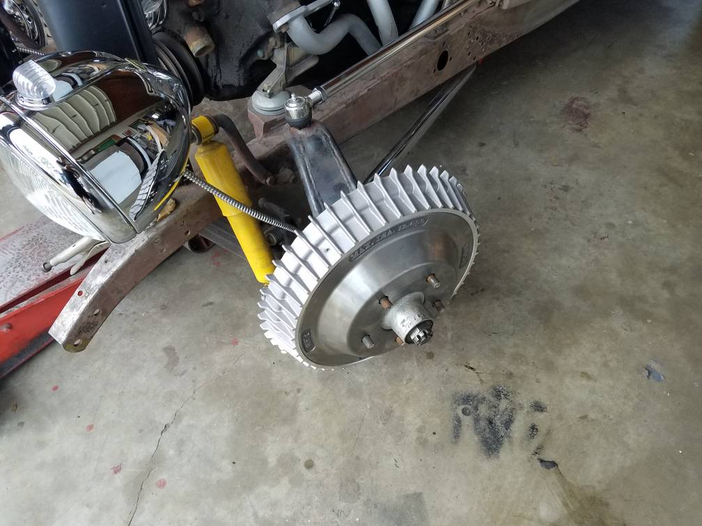

    Got a set of 40 hubs set up with new bearings and seals. Wanted to see how the brakes and drums fit up when hung on the spindles. Seems like everything fit up nice.

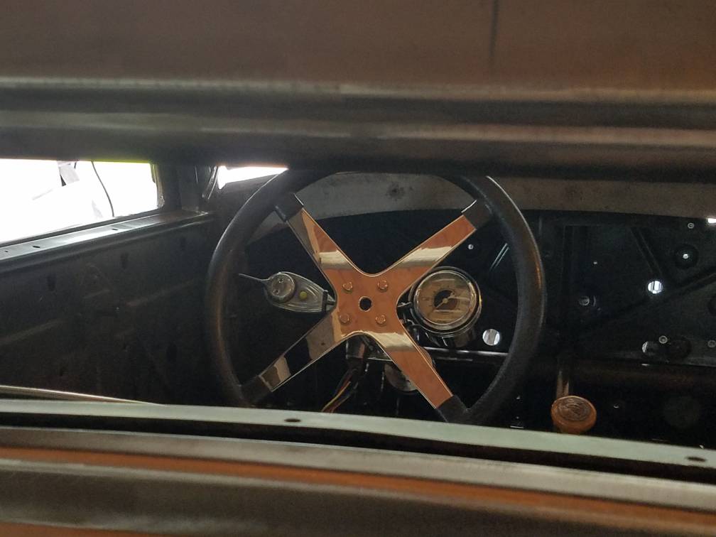

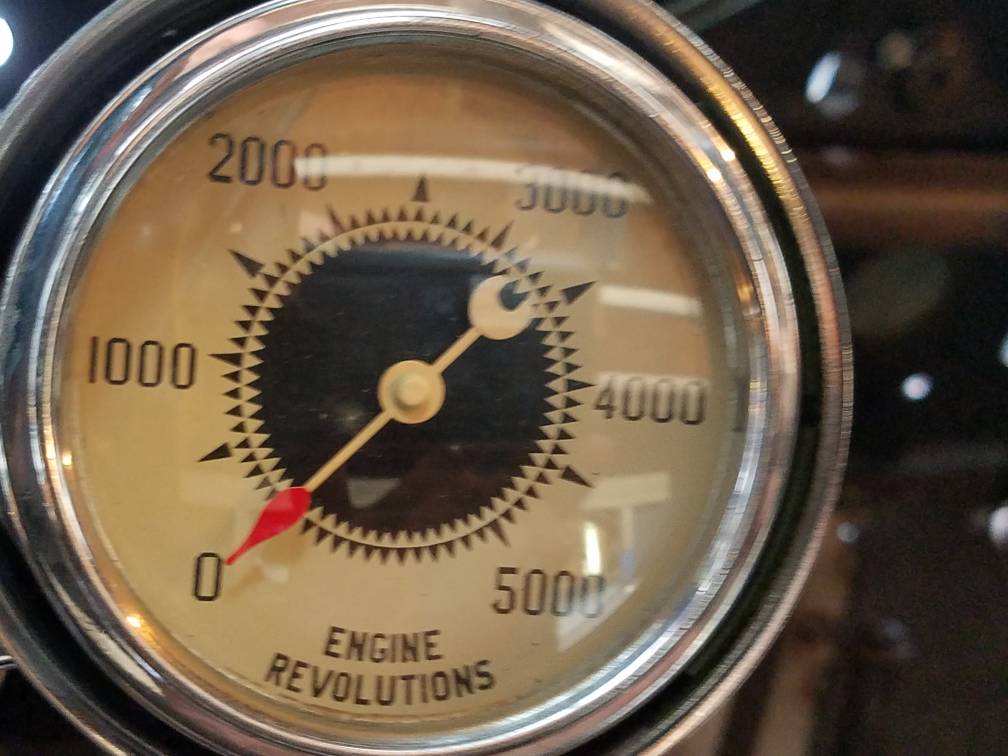

    Mounted my tach in a neat old chrome cup, I believe the tach is early thirties Auburn 20180813_160841.jpeg 20180813_160726.jpeg 20180813_161517.jpeg

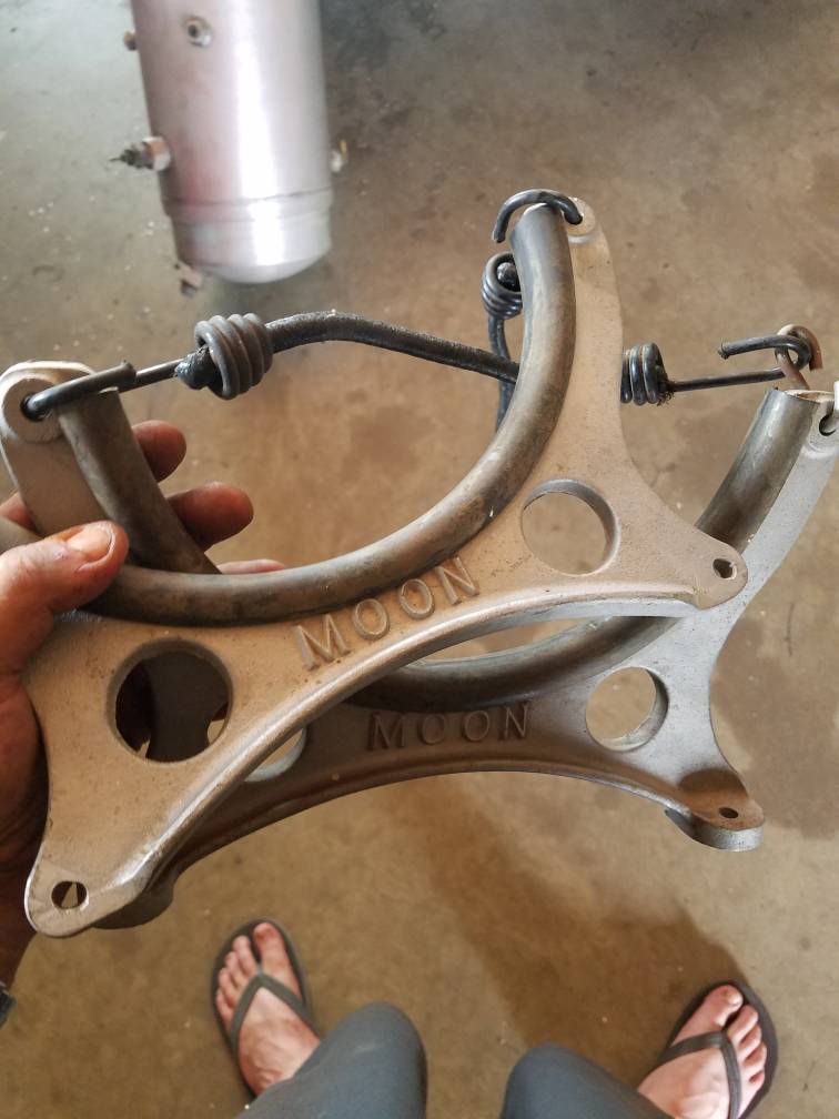

    Made up some original 50s style spring hold downs enclosed in some clear tubing IMG_20180820_204333_700.jpeg
