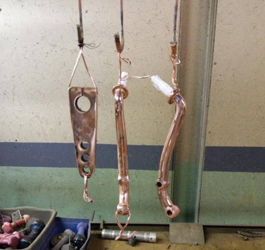

    Shock mounts all sanded down, polished and prepped for Chrome Screenshot_20181126-132850_Messenger%20Lite.jpeg IMG_20181126_133426_003.jpeg

    So is this a color direction change or is there some two toning going on here as that seems a different shade than the greenish paint a couple of pages back...I'm color blind so maybe it's just my eyes...
  7. HomemadeHardtop57
    Joined: Nov 15, 2007
    Posts: 4,340
    HomemadeHardtop57
    A friend of mine actually had his car painted the green color I was originally thinking. It's actually a modern color on a modern car. I saw the car in person and hated the color. Lol. Brownish something was actually my original pick.

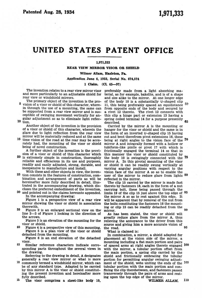

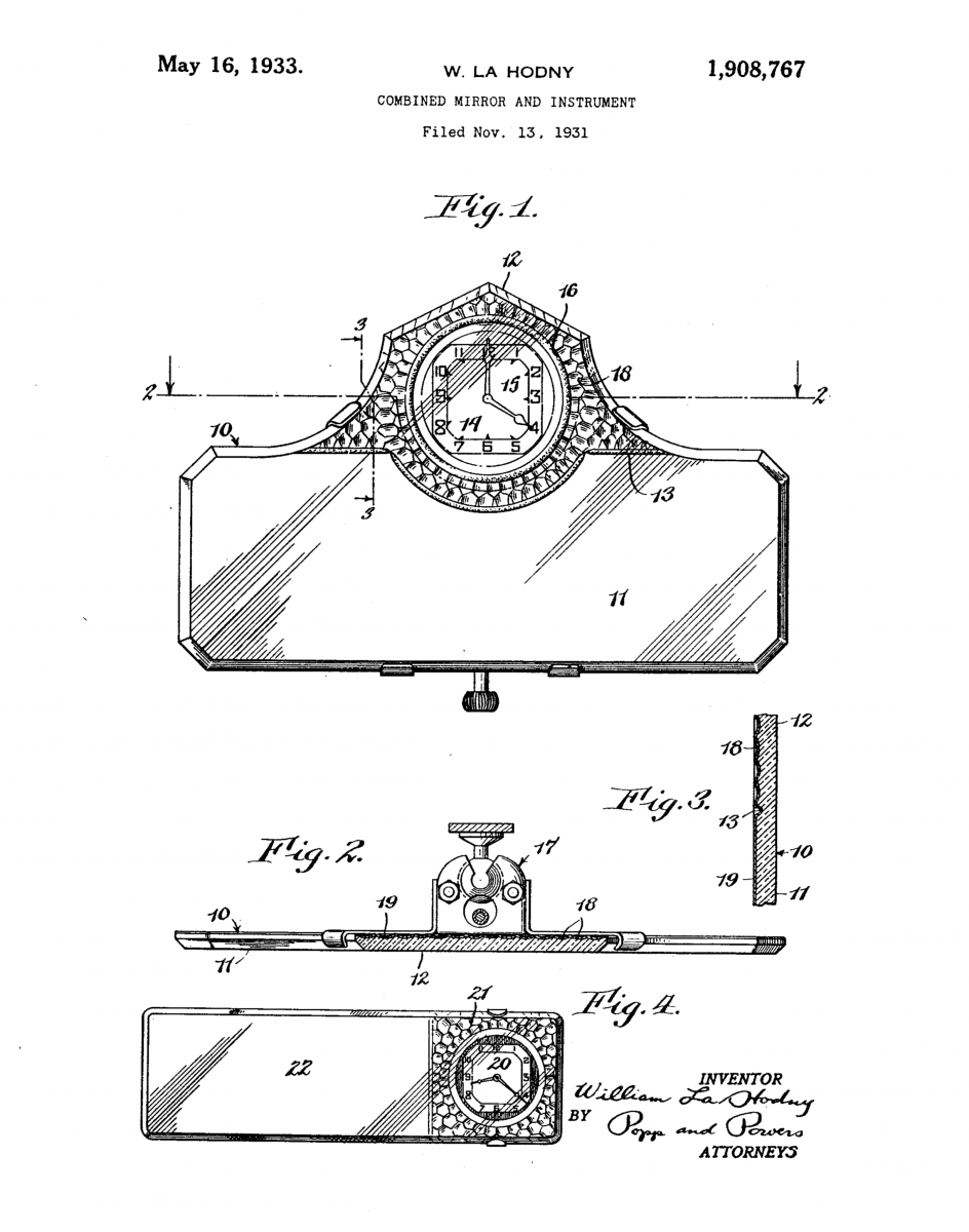

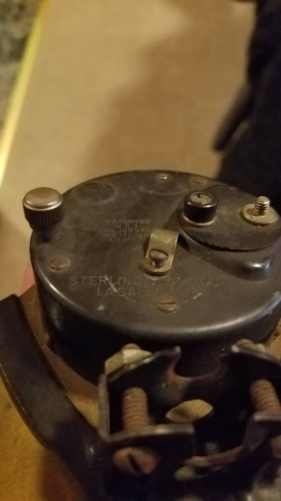

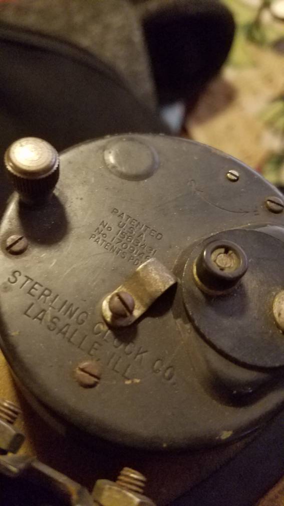

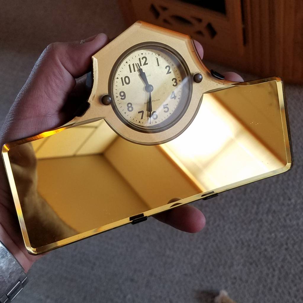

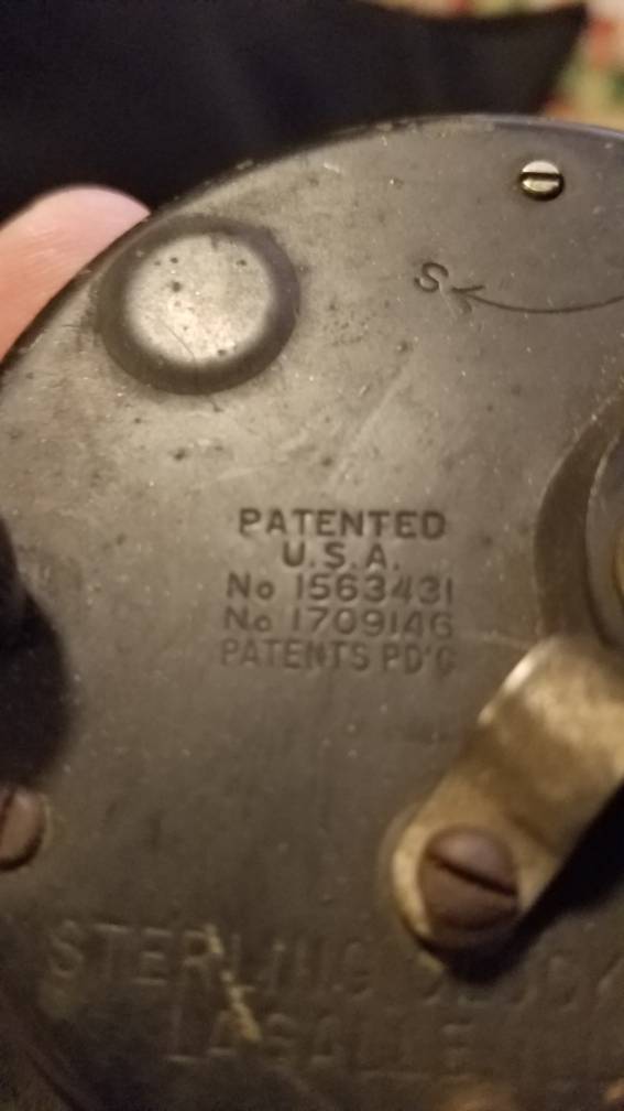

    A great deal of stuff we use on these Hotrods resides in archives of patents...
    I have had some success finding stuff here and there and well this is not exact but no doubt designed by this fellow and yeah it's pretty close in time frame. Does yours have a similar winding mechanism? Is there possibly a legible patent # on the back?

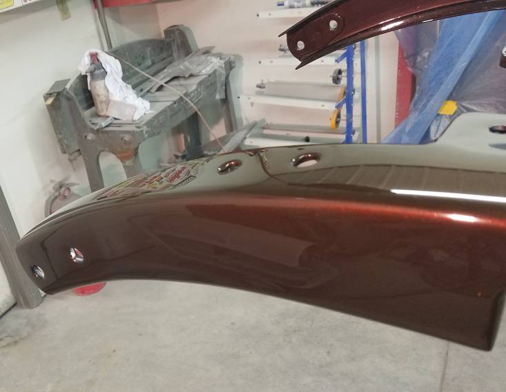

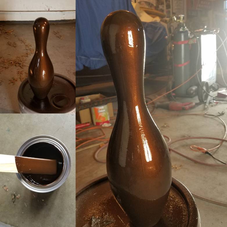

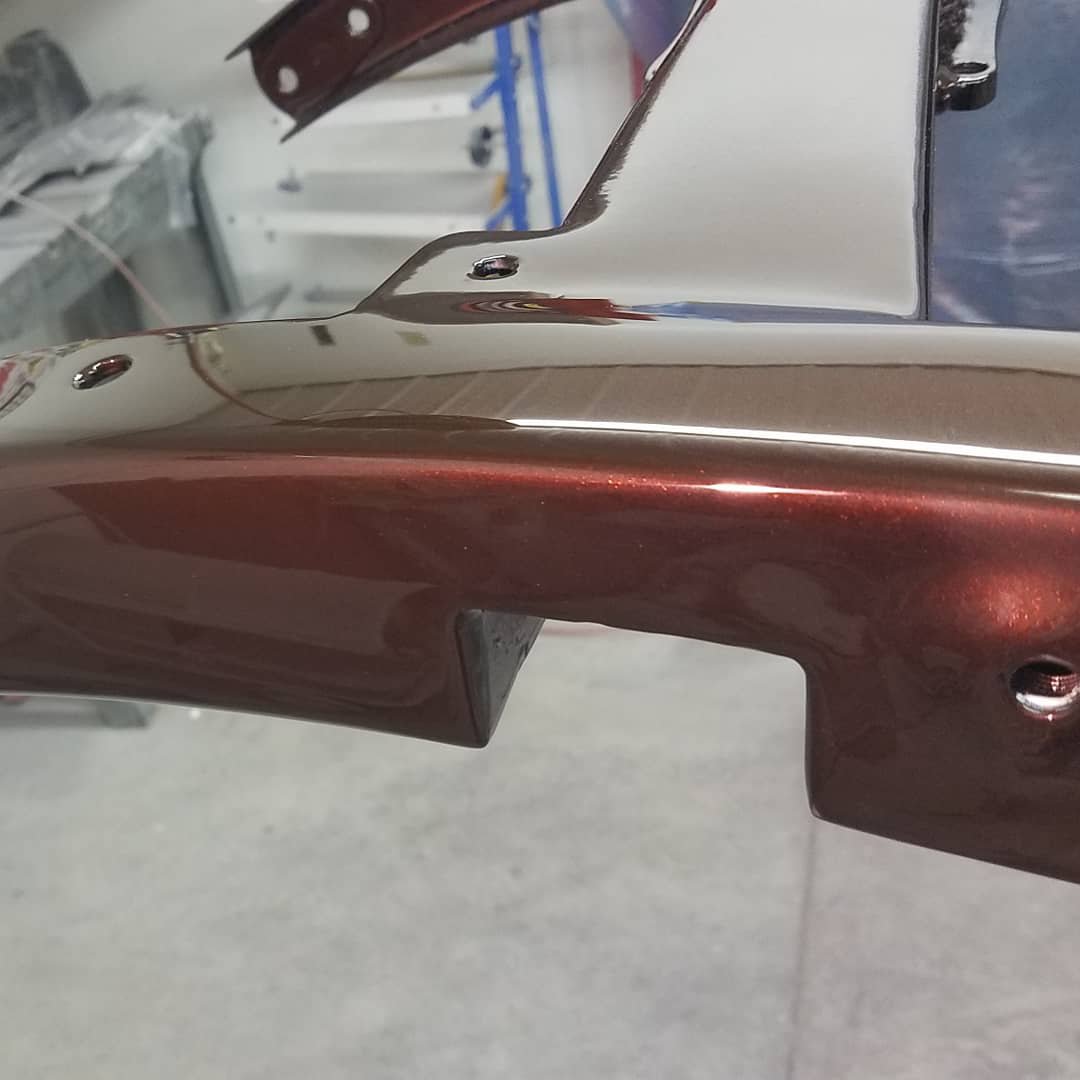

    First coats of base on. Its a dark brown bronze that brightens up when the light hits it FB_IMG_1543696601888.jpeg IMG_20181201_154044_633.jpeg FB_IMG_1543696336172.jpeg FB_IMG_1543696437992.jpeg IMG_20181201_154044_640.jpeg

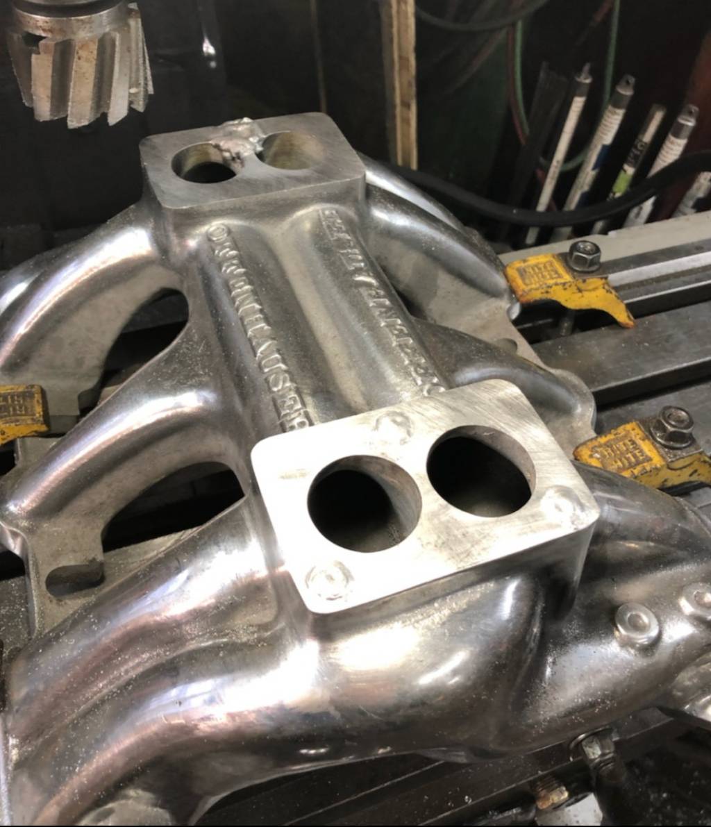

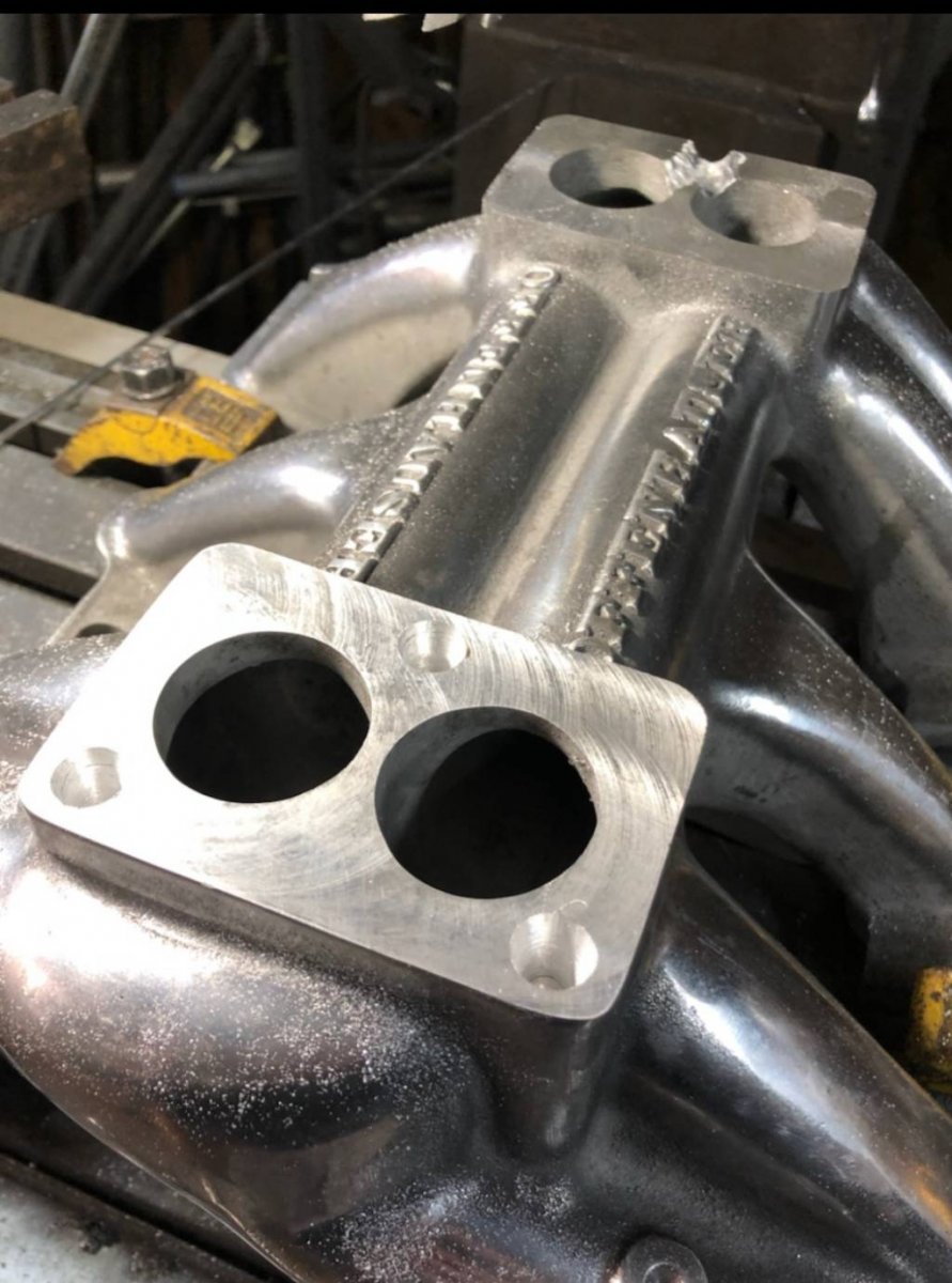

    The carb plates on my intake were staggered height and angled really hard. I think this may have been a boat intake possibly. I decided to mill them flat... but the stud holes had to be filled, redrilled straight and then tapped. Milling the rear plate flat cut into a vacuum port that was drilled into the back of the intake. That will get repaired, blended in, and everything cleaned up. All the alterations will be invisible when the intake is polished. These are a couple in the process pictures I'll post up a pic when finished Screenshot_20181206-104638_Messages.jpeg Screenshot_20181206-104624_Messages.jpeg

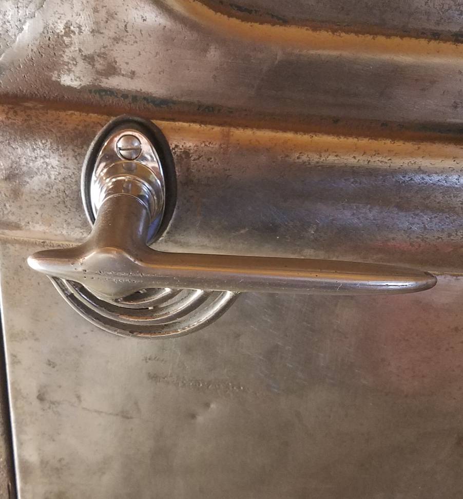

    I adapted my Chrysler door handles to 32 bezels with some whittling around. Neat door handles with an art deco look 20181201_150055.jpeg

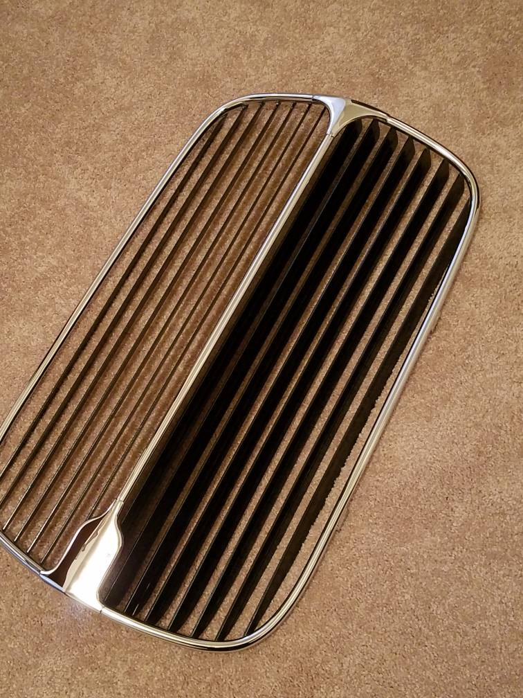

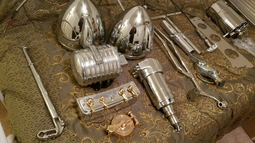

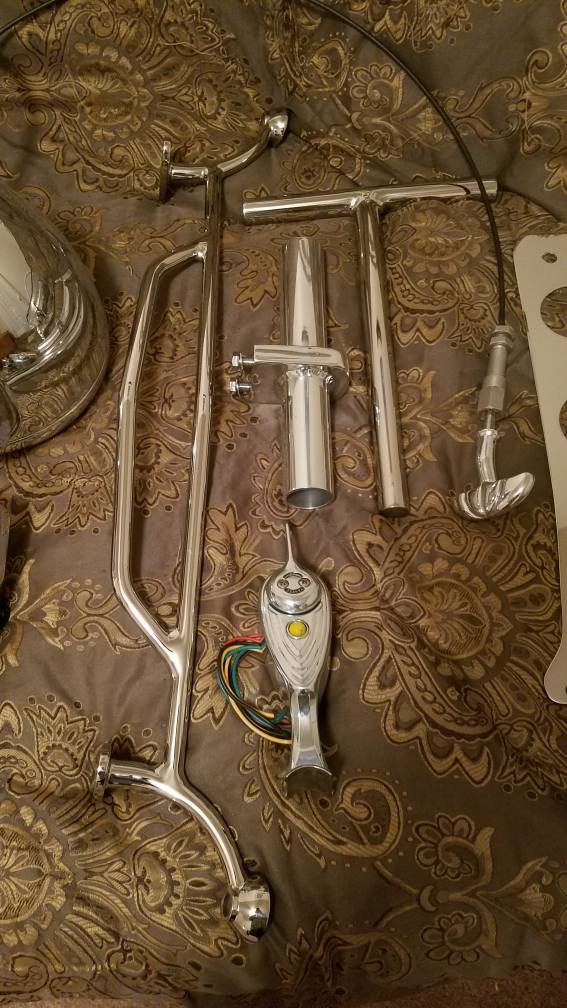

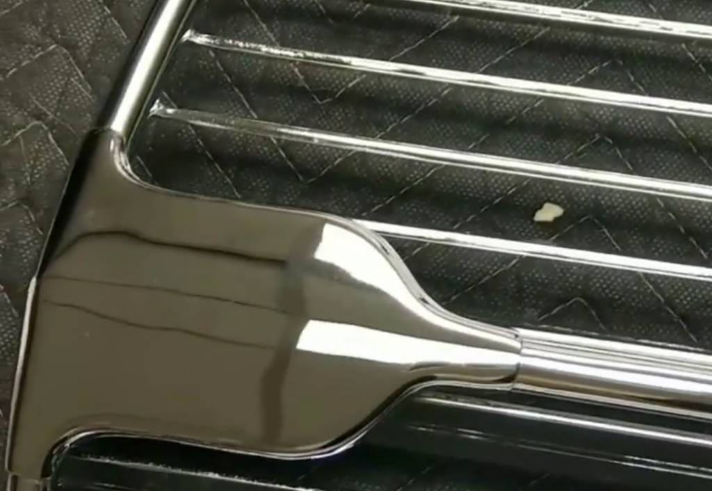

    Some parts back from plating. So hard to get good pics of Chrome IMG_20181207_163546_867.jpeg IMG_20181207_163546_863.jpeg IMG_20181207_163546_850.jpeg 20181207_155606.jpeg

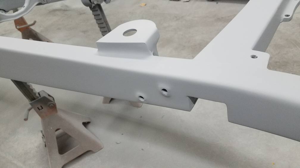

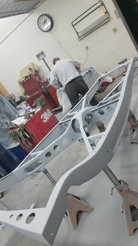

    The frame is cut and buffed and ready to come home. IMG_20181207_183220_023.jpeg

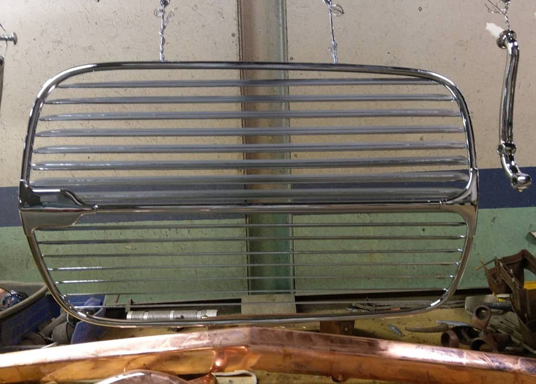

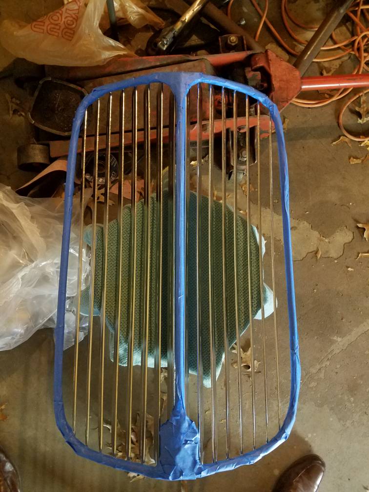

    Pick up the chrome parts today and did some work on the insert. I taped off the Chrome plated perimeter and blacked out the bars.
    20181208_145556.jpeg IMG_20181208_164758_179.jpeg 20181208_163818.jpeg IMG_20181208_164758_176.jpeg
