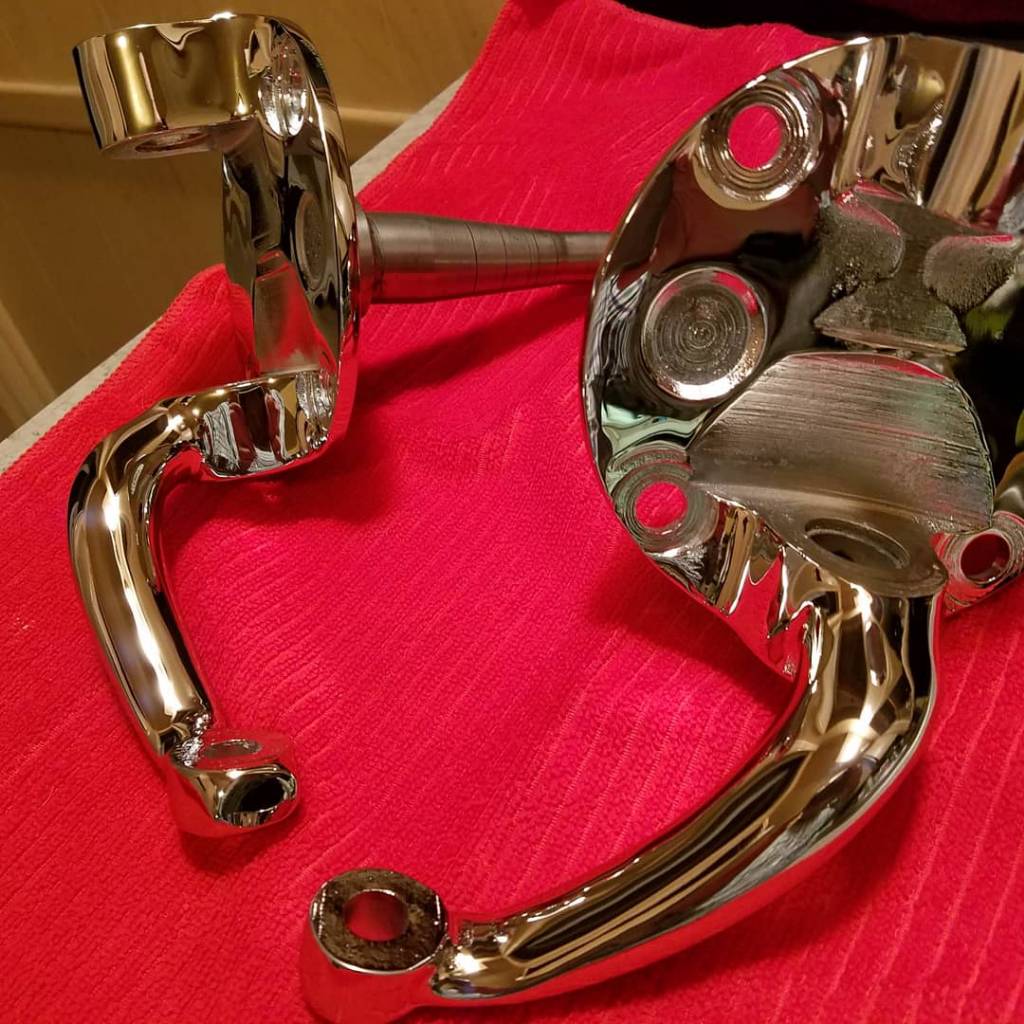

    More Wow Factor...BIGTIME...geeze that all looks purdy snazzy...That steering arm looks like a Salvador Dali Hotrod Creation...:D
    loudbang and HomemadeHardtop57 like this.
  3. Runnin shine
    Joined: Apr 12, 2013
    Posts: 3,385
    Runnin shine
    Like “melting clock”?
    He definitely did paint with what appears to be chrome effect or like acid before Leary came along.
    All this chrome is trippy.
    loudbang and Stogy like this.

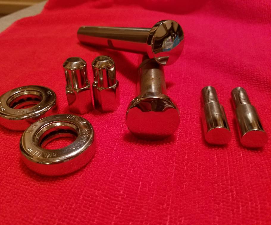

    ART Metals in Ohio makes some really excellent quality front kingpin bearings that they plate and put into a nice kingpin kit that is all dolled up too IMG_20190111_204704_285.jpeg

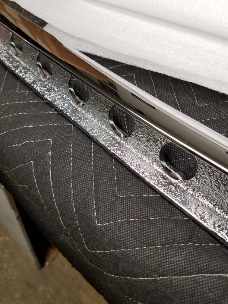

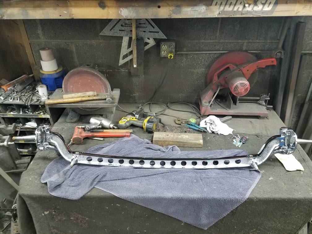

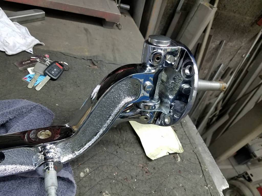

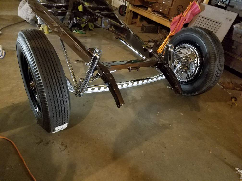

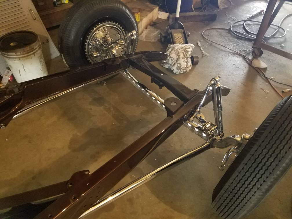

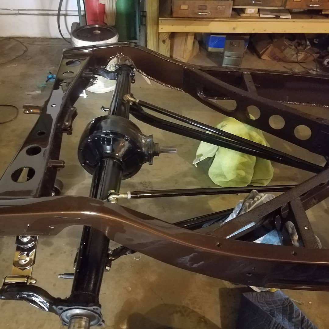

    Started ***embly on the front end today. The axle has very thick chrome plating on it so a couple of the holes needed to be dressed and cleaned out for stuff to go together. Koz gave me a hand cleaning out the Kingpin and king pin lock holes and we put everything together. Definitely a two-person job when things are shiny. Looking good so far. IMG_20190114_190346_399.jpeg 20190114_184629.jpeg

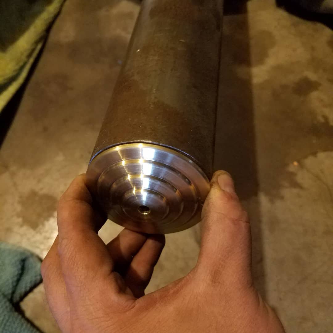

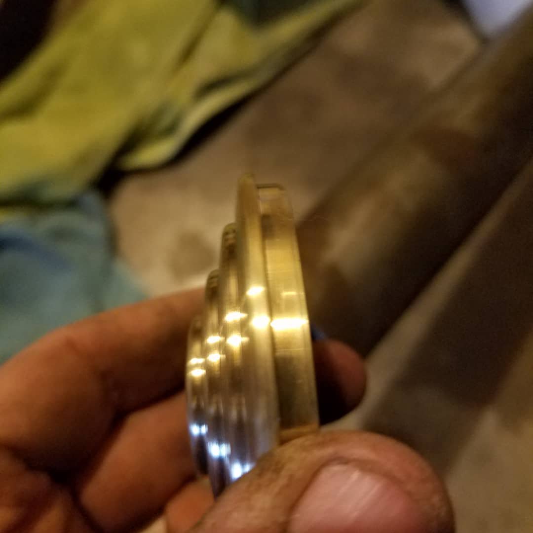

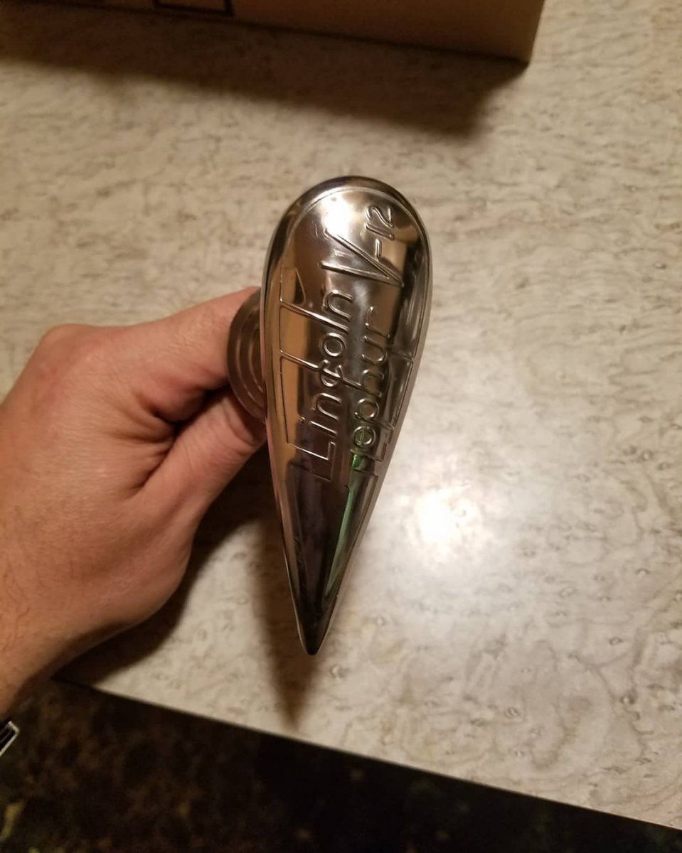

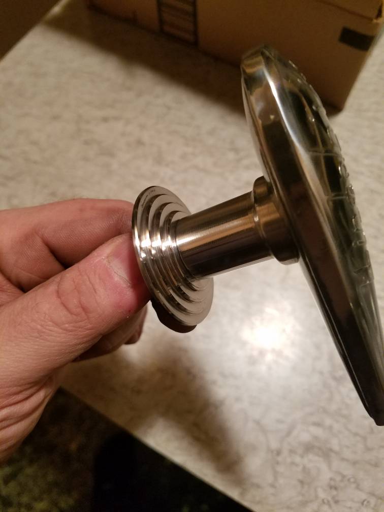

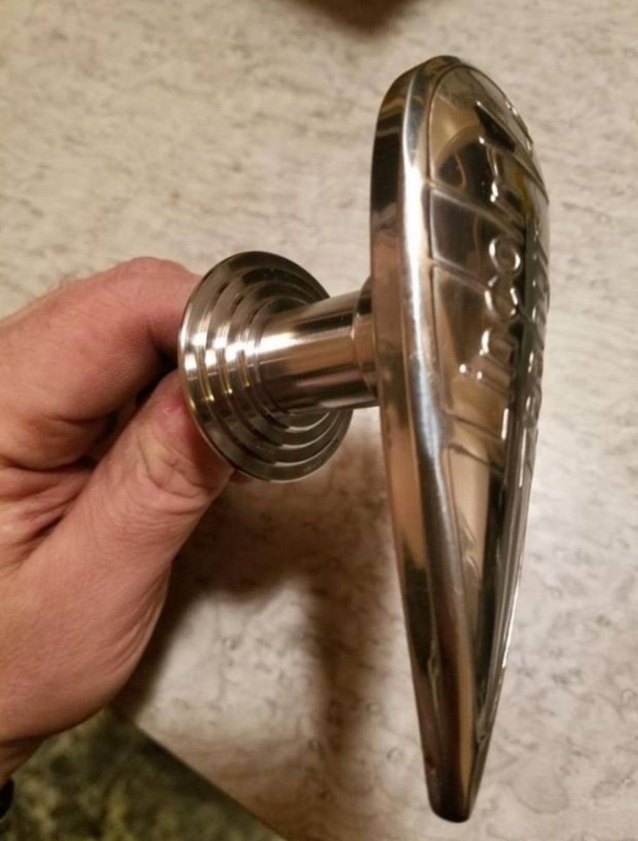

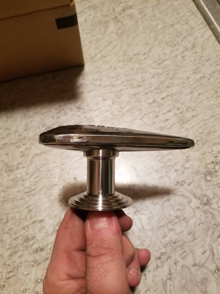

    Finished this up yesterday for my trunk. This was a parts handle. Peeled the skin off and straightened the face as best as possible, made a new back collar piece, and a waterfall style base. A polish and some backround paint and it will be back from the dead. I will make matching waterfall pieces for my inside door/window handles when I sew up the interior. Screenshot_20190115-174200_Messages.jpeg 20190115_173623.jpeg 20190115_173644.jpeg IMG_20190115_174840_384.jpeg Screenshot_20190115-174342_Instagram.jpeg 20190115_173704.jpeg 20190115_173719.jpeg

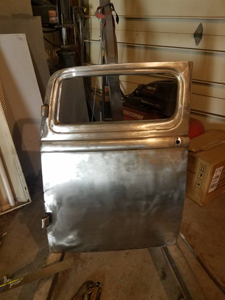

    Gutting the doors tonight of the latches and regulators, bagging and labeling hardware, and finishing up sanding them down. I was going to try to get away with not blasting these and just having the body shell done of the car, but I dont know. Going to have lots of time tonight getting what's left of the paint off the edges and back IMG_20190117_192533_896.jpeg IMG_20190117_192533_894.jpeg IMG_20190117_192533_897.jpeg 20190117_190340.jpeg

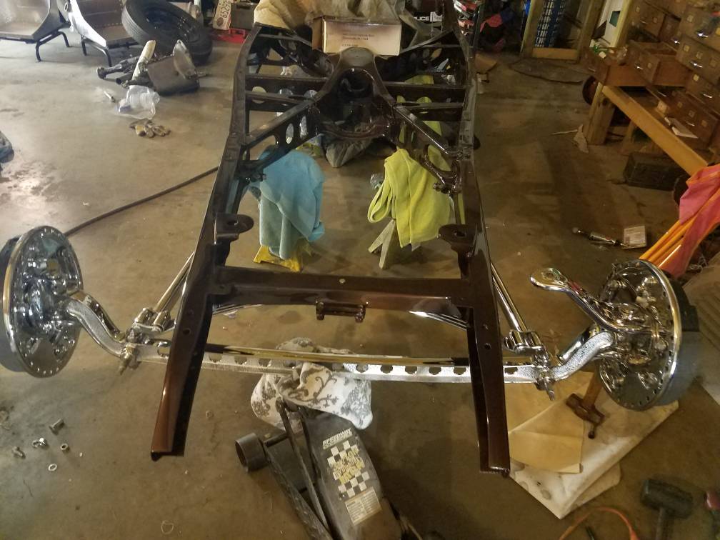

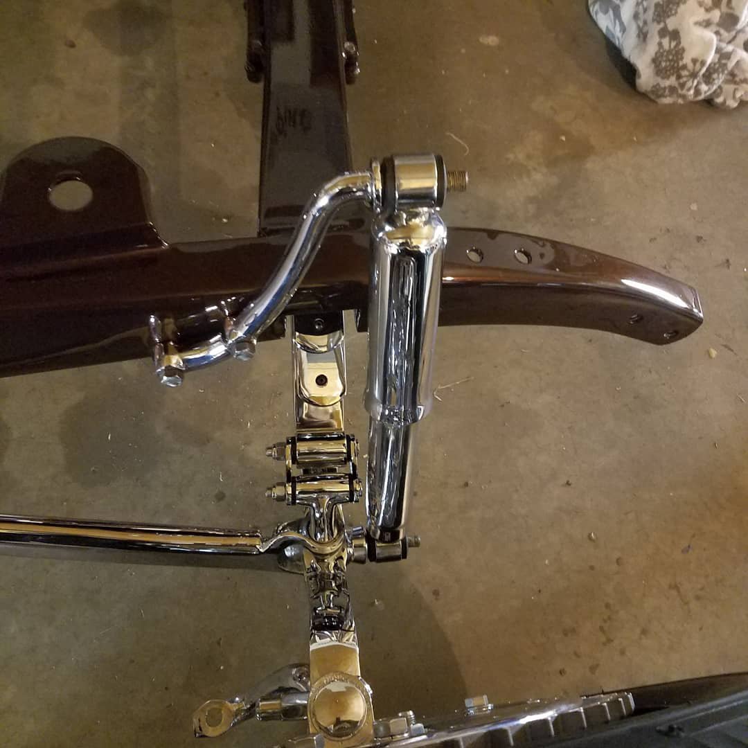

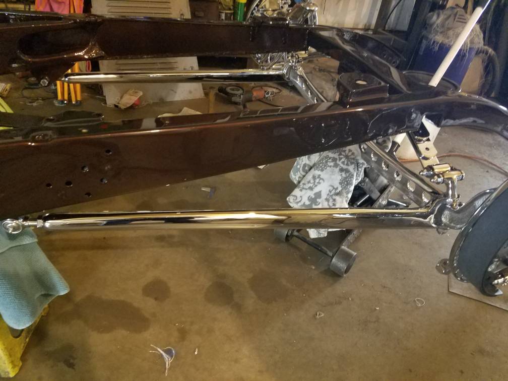

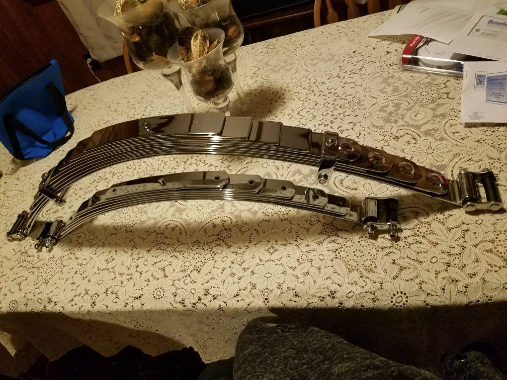

    Last of the suspension parts came back from plate tonight. Hopefully I'll have a rolling ch***is by the end of the weekend. 20190118_181642.jpeg
    Sent from my SAMSUNG-SM-G891A using The H.A.M.B. mobile app
    ls1yj, brEad, Shadow Creek and 3 others like this.
  19. loudbang
    Posts: 40,351
    Yikes you better hope mama doesn't pop in and see those "CAR PARTS" on her embroidered lace tablecloth. :eek:

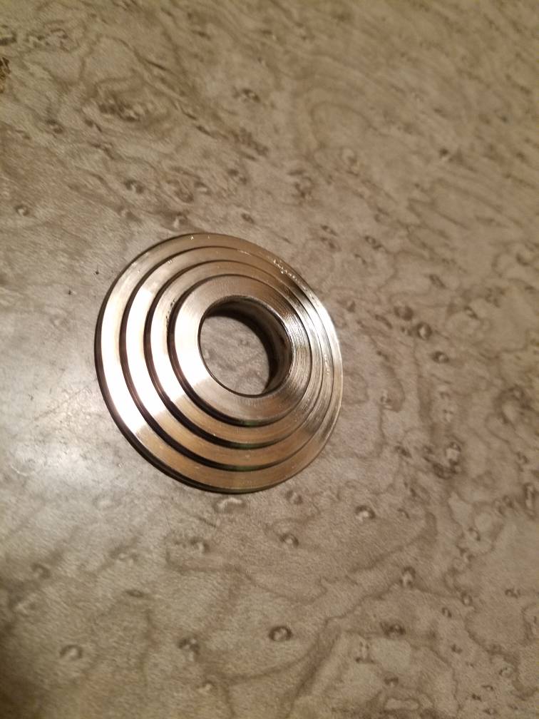

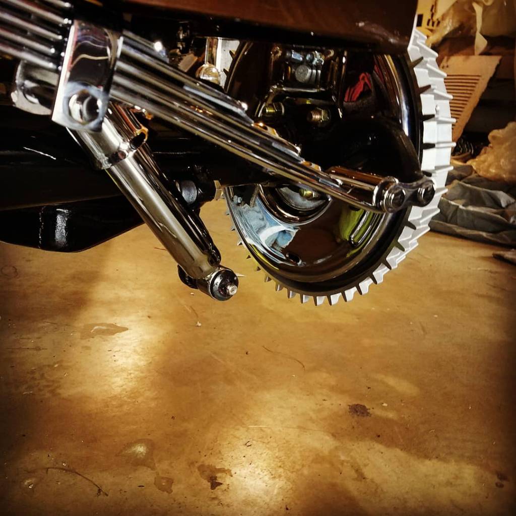

    Wishbone to axle spacers made up in the lathe. They sell steel ones but nobody makes them in stainless. IMG_20190119_105925_288.jpeg

    Took a few minutes this morning also and Polished up my handle. I sanded it down last night with some really fine paper and then hit it with the wheel today. IMG_20190119_132650_504.jpeg
