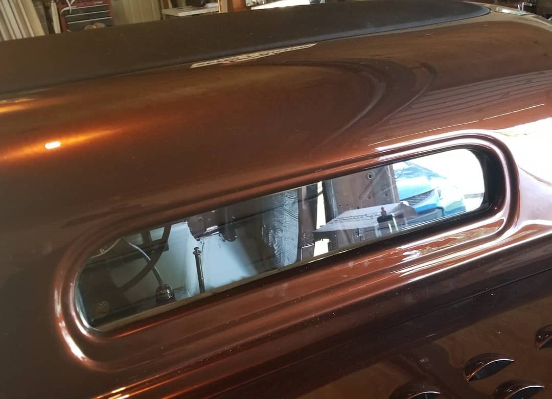

    Looking fantastic. Was great meeting you at Jalopyrama. Hope you make it to York
    Bob.
    Stogy, loudbang and HomemadeHardtop57 like this.

    That top looks like **** Gerwer did it! Nice work!
    Stogy, loudbang and enloe like this.

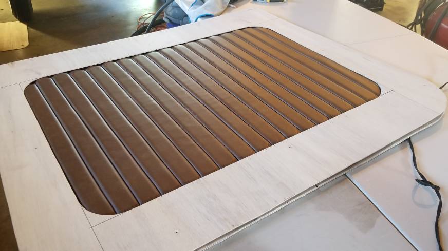

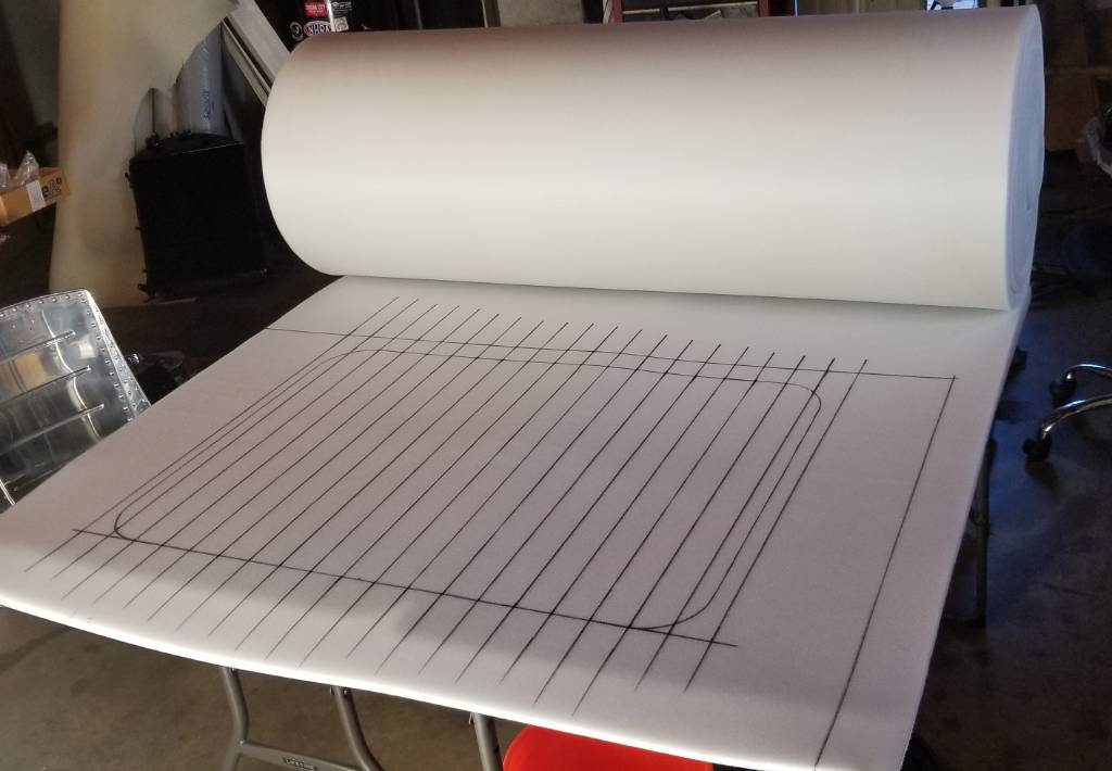

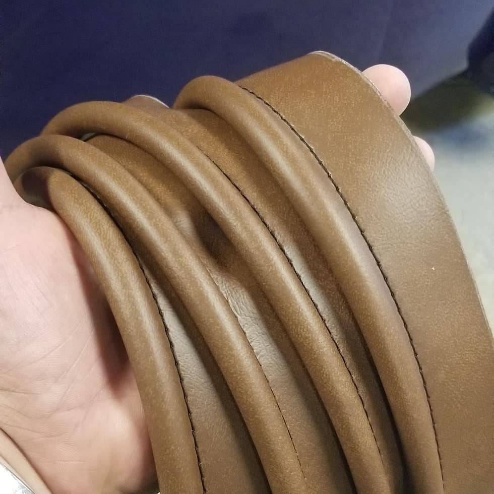

    Had a little time tonight so I cut a small piece of fabric from the roll I'm going to use to upholster my 32 and practiced **** Gerwer's way of doing real roll and pleat. A little more difficult doing it this way because all of the measurements are different, but the pleats get nice and deep. It has been a while since he showed me so I needed to practice. This fabric should work out nice. IMG_20190522_221832_652.jpeg 20190522_214524.jpeg

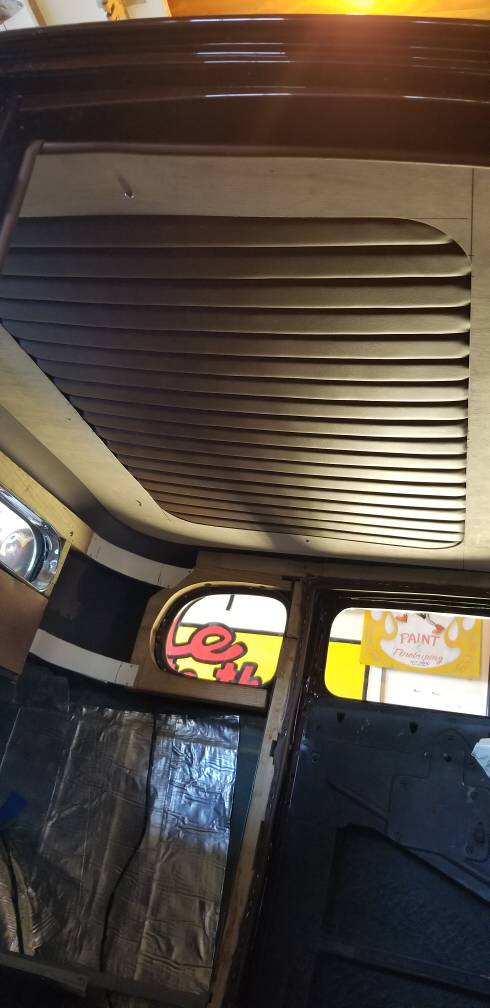

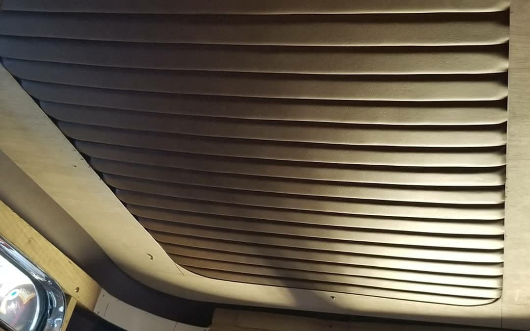

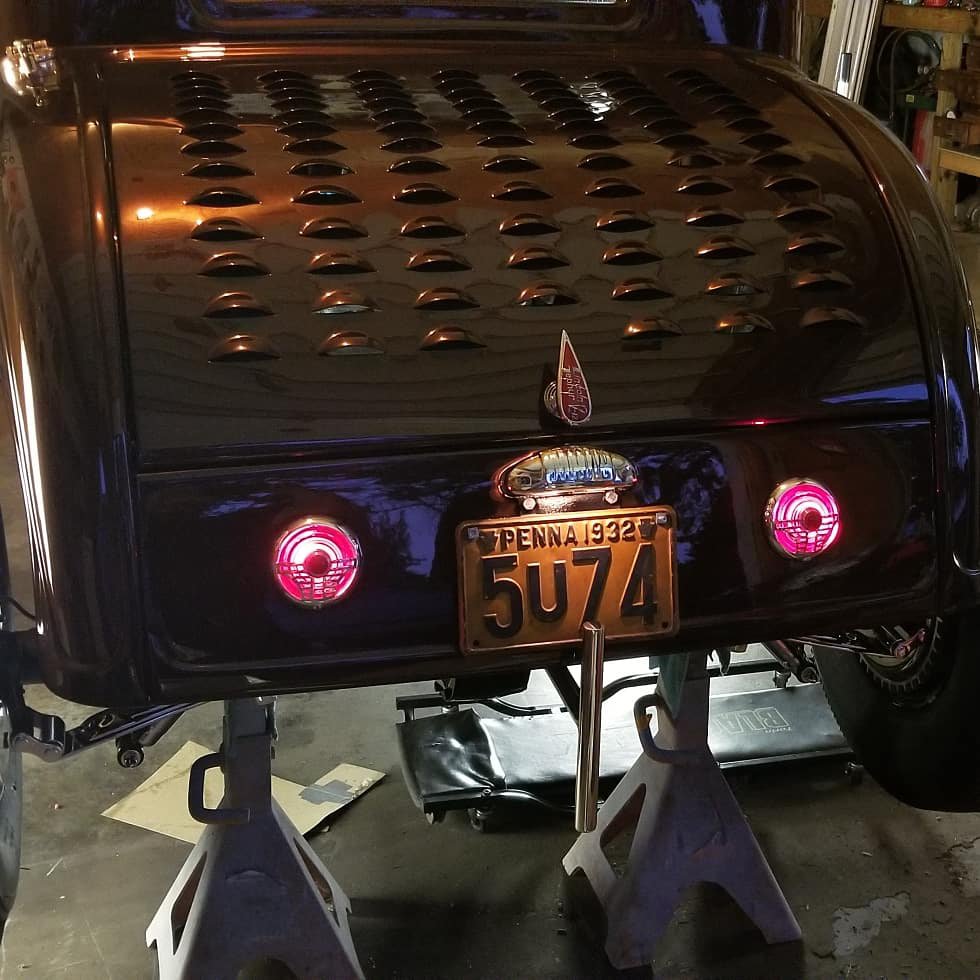

    Rear wood ***embly and gl*** in today. Even rolls up and down! 20190619_174601.jpeg IMG_20190619_175604_340.jpeg IMG_20190619_175604_339.jpeg

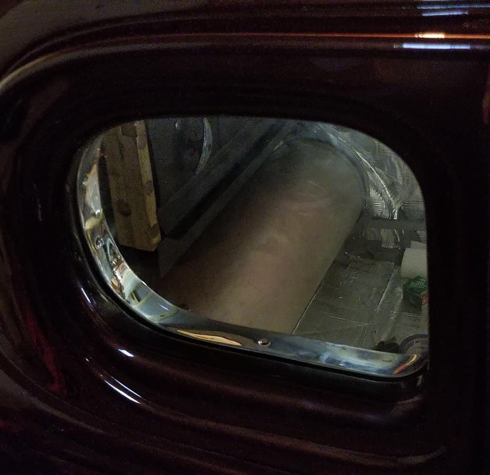

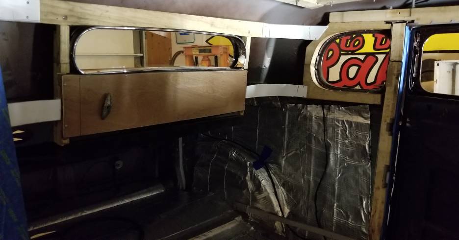

    Spent the morning refitting quarter window wood and got both sides mounted. Here's a tip that will help your upholsterer. When mounting this wood for the final time, you will need your gl*** and your garnish molding. Put your quarter window wood in the slot around the window opening. Then put your quarter gl*** in, and then garnish moldings in far enough to pinch the gl***. Pull the wood out towards you until its in line with the garnish molding edge or just under. Thats where wood needs to be so your upholstery panel doesnt stick out way past your garnish moldings or way in. IMG_20190620_131037_480.jpeg IMG_20190620_131037_475.jpeg

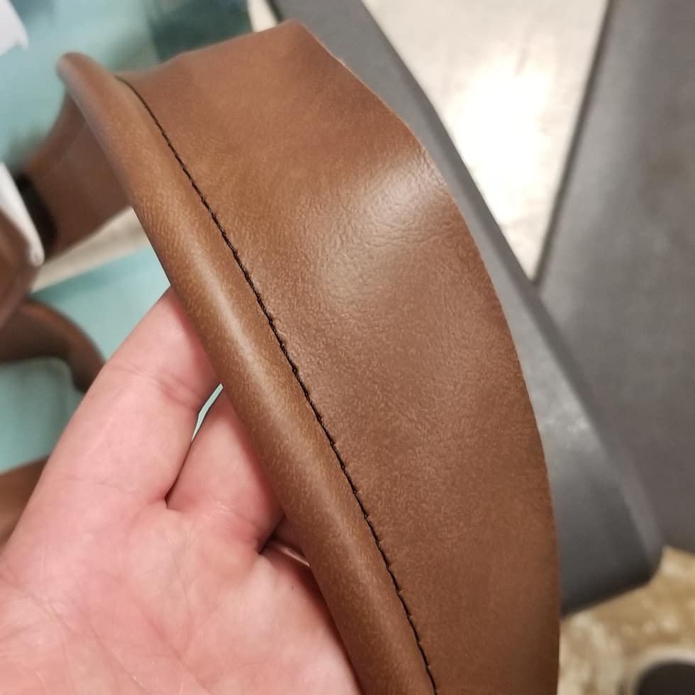

    On to the interior. Made up the windlace this morning. IMG_20190710_133600_328.jpeg IMG_20190710_133600_327.jpeg

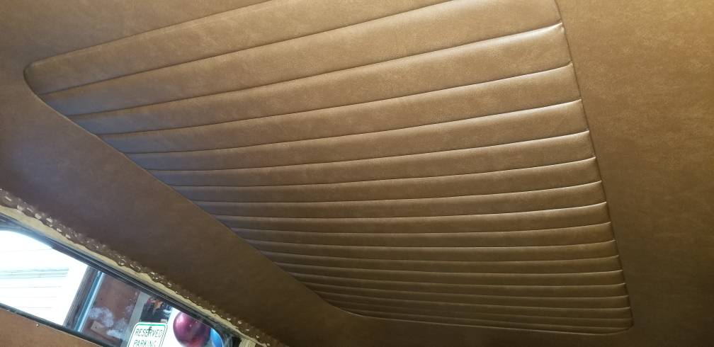

    Framed out mounting strips for the interior panels. Got this really cool cling wrap that protects the paint while working on the car IMG_20190721_184729_501.jpeg IMG_20190721_211612_117.jpeg
