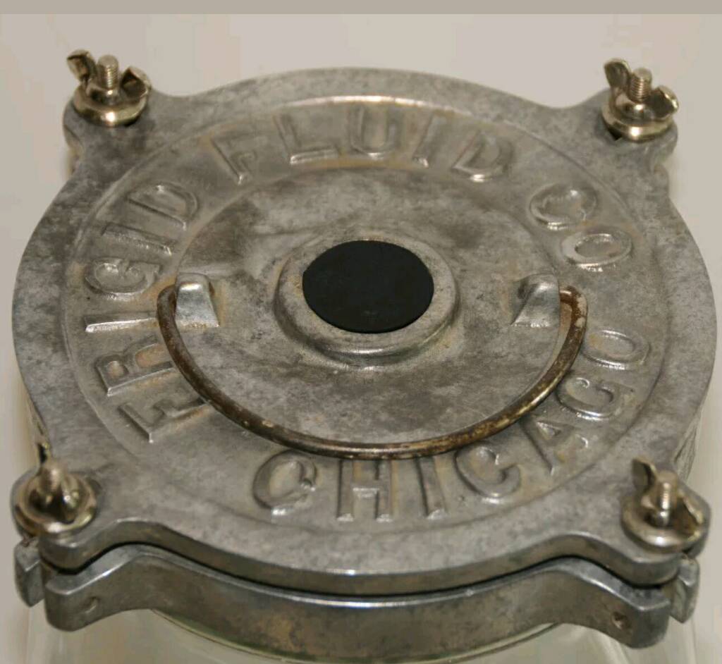

    If you can guess what this is and what I'm going to make with it you may win a prize lol . 1481916841725.jpg

    Gas cap and sand cast. What do I win?

    I'm guessing a piece of embalming equipment & you'll use it as an oil filter canister cover.

    Formaldehyde cannister, nice.

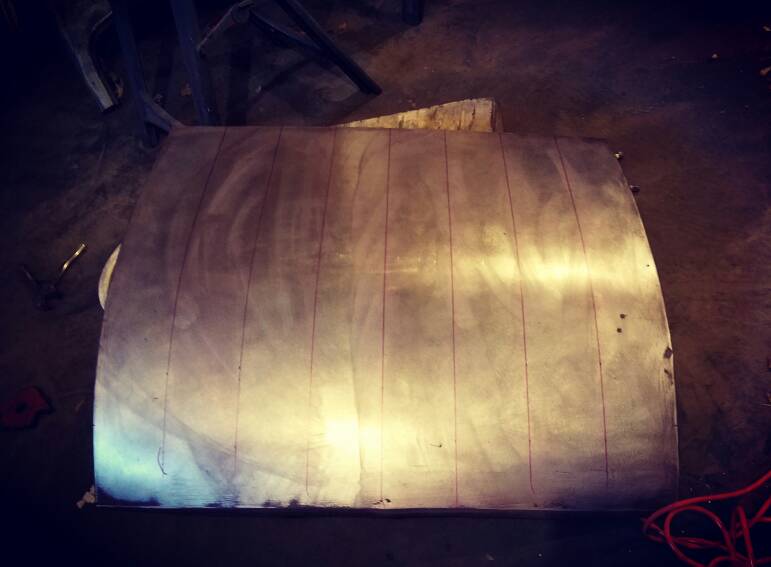

    Tomorrow I'll be louvering the top insert that I made and the decklid skin. I got the decklid skin sanded down and started the layout. For laying out my centerlines on decklid skins I use a bent piece of 1/8 inch flat stock that I shaped to match the crown.

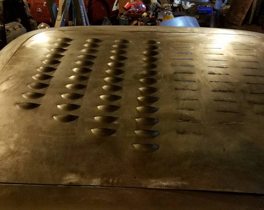

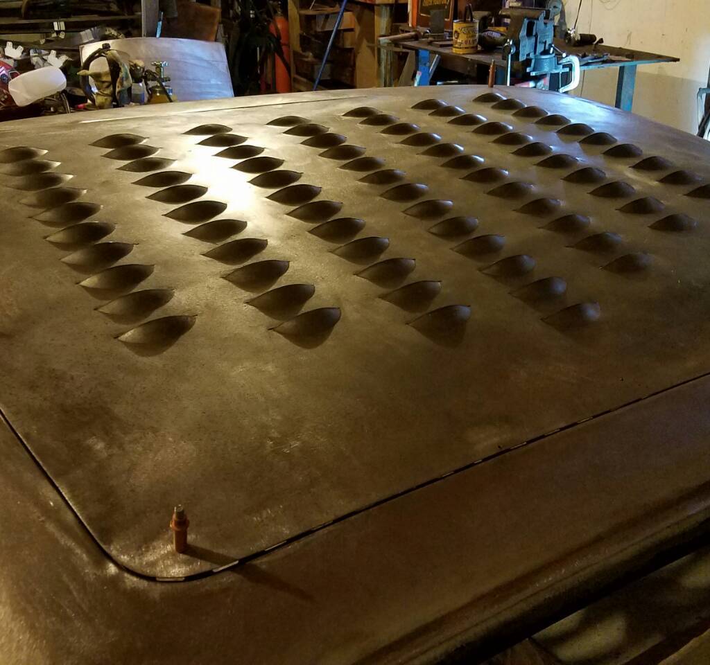

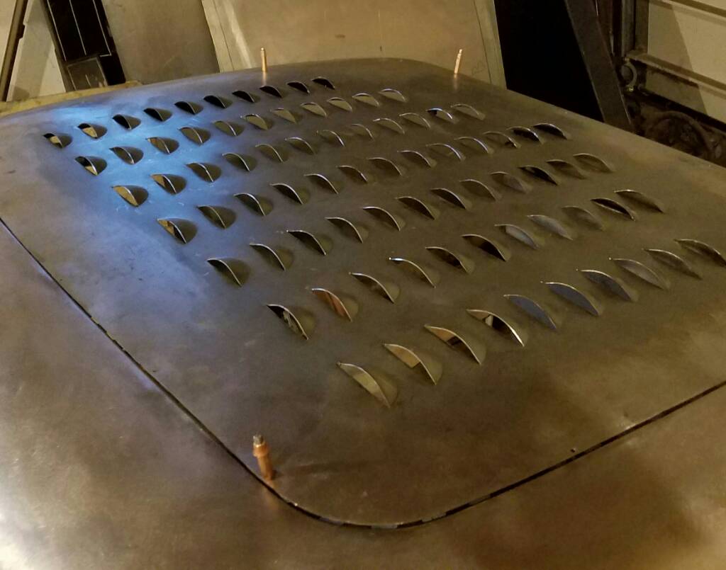

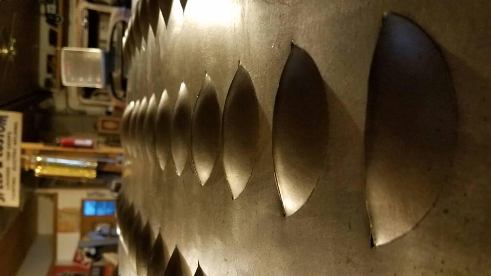

    Got the inset louvered today. I still need to dress the edges with a file but I was tired and called it a day.
    First I cut my lines. Hit the top with a DA sander, then smacked the louvers in with my fixture and a 5 lb sledge hammer. I'll post some pics of the louver setup.
    Sent from my SAMSUNG-SM-G891A using The H.A.M.B. mobile app
    ct1932ford, Hamtown Al, ls1yj and 8 others like this.
  20. HomemadeHardtop57
    Joined: Nov 15, 2007
    Posts: 4,340
    HomemadeHardtop57
    The louver dies were made from the end of an early Ford torque tube. How's that for traditional. Haha. The pieces were trimmed and welded into a simple handheld fixture. I cut the 3 inch line, lower skin down over the 3 inch sheet metal guide, line the top part of the fixture up with the guide plate then go. I hit it light about 5 times to knock the metal into the lower die and seat the male die then give it hell about 5 more times.
    After the first two rows you basically get the ****s of it and want to go watch TV or drink a beer. I guess if it was easy everyone would be doing it. Ha

    ls1yj, 31Truckster, slv63 and 10 others like this.
  21. DDDenny
    Posts: 23,425
    Wow, that's looks good, mad skills and patience Jerry, you gotta want it pretty bad considering the extra effort required for that "back in the day" look.

  24. HomemadeHardtop57
    Posts: 4,340
    HomemadeHardtop57
    Sure no problem. I think it's a pretty neat tool and wanted to share

  28. continentaljohn
    Joined: Jul 24, 2002
    Posts: 5,978
    continentaljohn

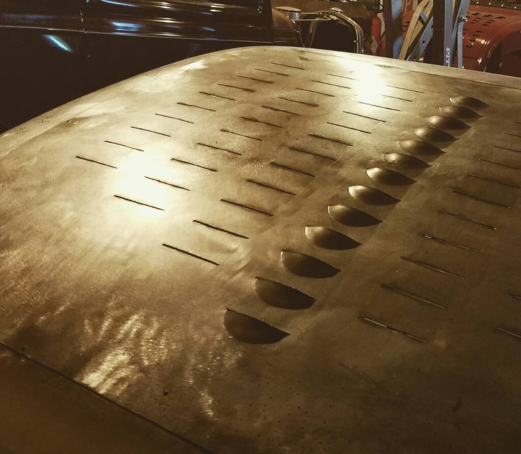

    Awesome thread and love the louvers idea! I have to ask about how you cut the slots plasma or cut off wheel , looks super clean and awesome job!
  29. HomemadeHardtop57
    Posts: 4,340
    HomemadeHardtop57
    Cutoff wheel and lots of patience.
