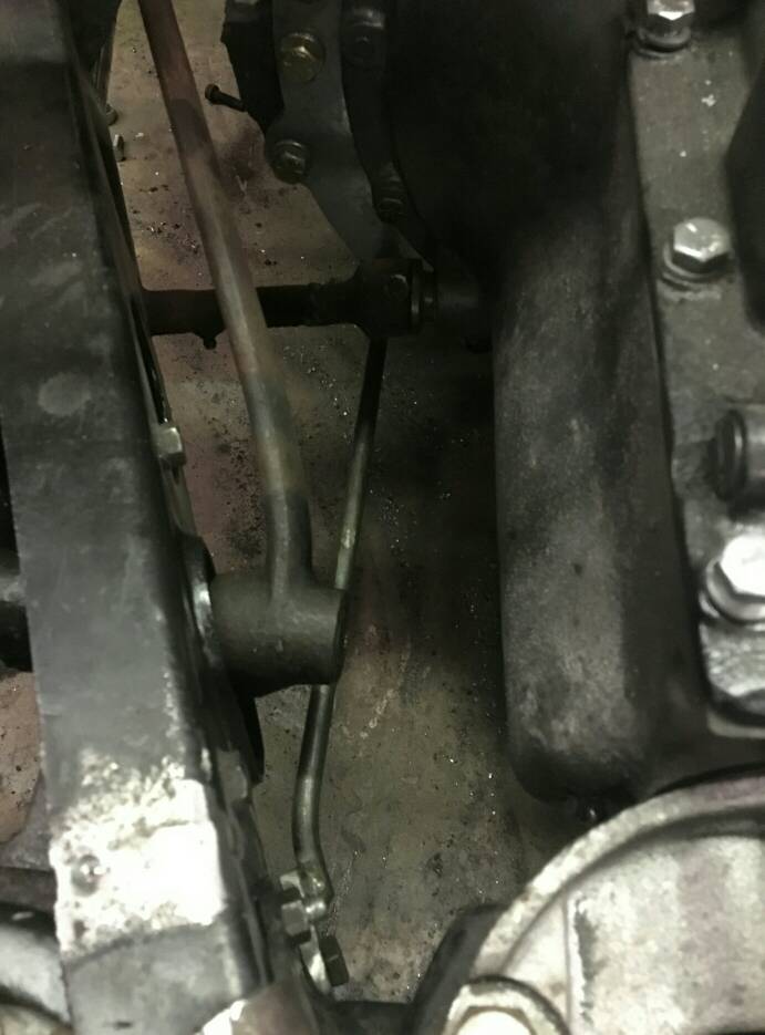

    Anti chatter...I take it that minimizes or prevents the shudder that happens when releasing the clutch from a start that if it happens shakes the **** out of everything? Sorry Jerry, I'm just ***uming what do they do?...o_O

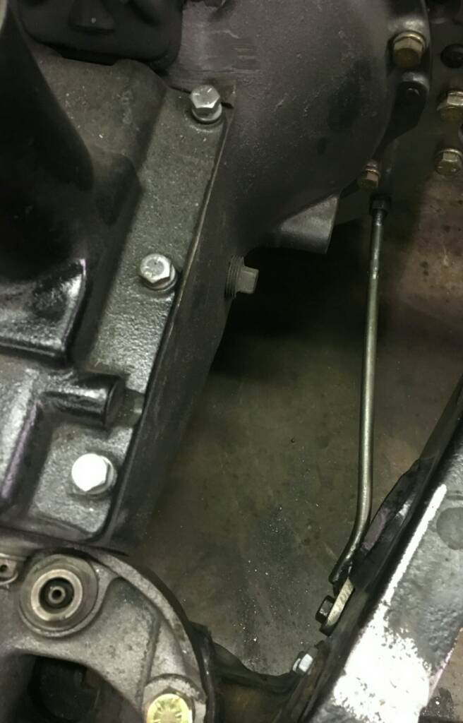

    Stogy..Ford used them on most of their early V8 flathead cars for that reason and also as engine steady rods, preventing the engine and trans from moving forward and/or backwards and your fan eating the radiator I'm the case of mount failure. This was the main purpose for them here in my ch***is.
    The old Hurst mounts I'm using have a long slot where they drop on the biscuits and not a hole. The rods will help keep the engine steady as a secondary support to the tightened motor mount bolts.
    Believe it or not this happened years ago..Motor shifted from a loose mount and I trashed a radiator 3 hours away from home on the road. Not fun!
