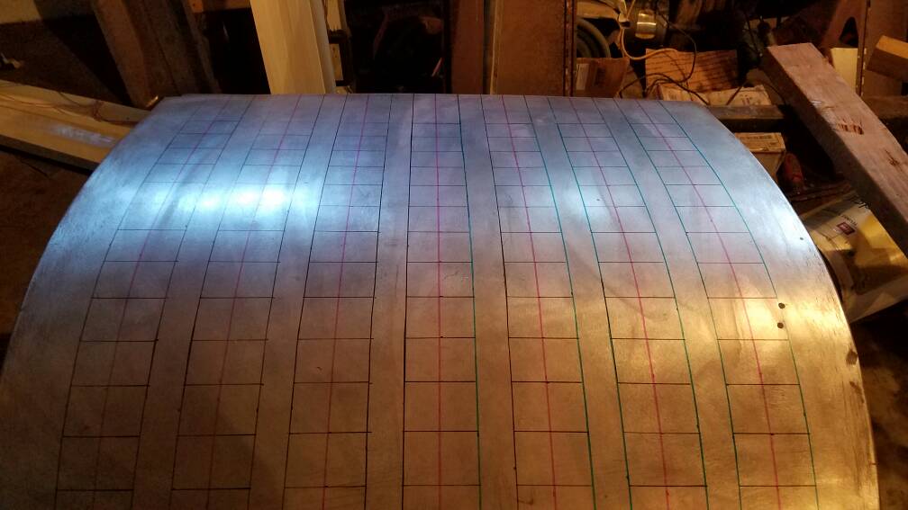

    Getting ready to punch the decklid. Might use a Lincoln door opener..not sure yet

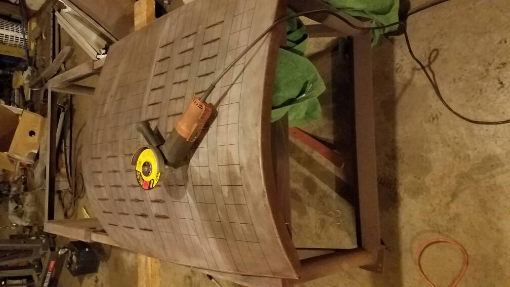

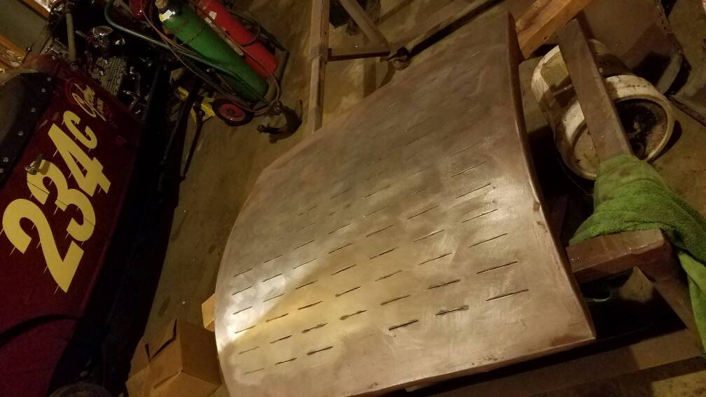

  20. HomemadeHardtop57
    Joined: Nov 15, 2007
    Posts: 4,340
    HomemadeHardtop57
    That's a good question.. when I first started experimenting with this style I used an air powered die grinder with a thin cut off wheel. I found that the electric one had a bit more muscle and cut the line fast and clean. At the same time its easier to really make a mistake. I do this usually at night when no one is around so I can concentrate without visitors. There is a little heat burn that still results but I hit the panel with a DA sander and some 80 grit and it cleans it up right away. I do the same thing to the back of the panel to knock down and remove the cut through burrs that result. I try to get the front side as clean as possible. It makes hand hammering the louvers easier and the bodywork easier in the end.
    Sent from my SAMSUNG-SM-G891A using The H.A.M.B. mobile app
    loudbang and Stogy like this.
  21. Stogy
    Joined: Feb 10, 2007
    Posts: 27,523
    Stogy
    You do have a steady hand there...understood. Once your wheel hits the metal your committed...just like coloring don't go over the line...

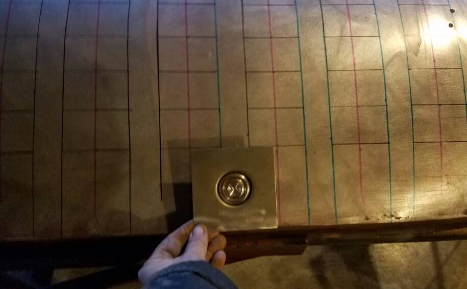

  29. 51box
    Joined: Aug 31, 2005
    Posts: 1,116
    51box
    from MA
    Nice work, that jig you made gives a great shape on the louvers.
