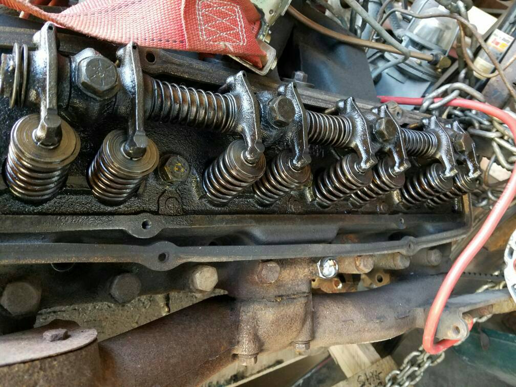

    The hand cut louvers are awesome. In fact the whole build is great. Are you rebuilding the Caddy mill or have you seen it run and are gonna let it fly? The whole set up is great, especially the air cleaners. What's the ******, and is that an adapter?

    Thanks for the kind words. The motor came out of a low mileage original car with about 50,000 miles on it. I pulled the valve covers and Valley Pan and it was super clean inside. Ran nice and smooth. Transmission is a 39 Ford that was converted to open Drive. The adapter is made by Wilcap based out of California. Their stuff is top-notch and everything fits like a glove like it should. I got the ****** adapter, the flywheel, and the clutch kit from them.

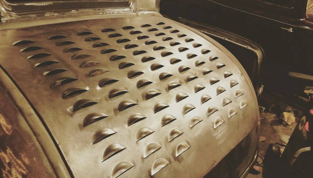

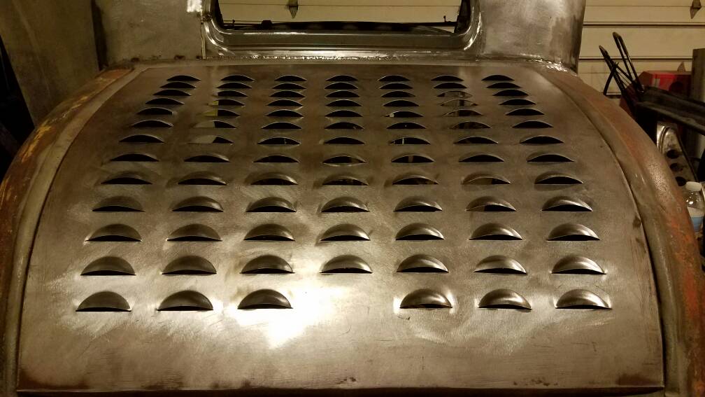

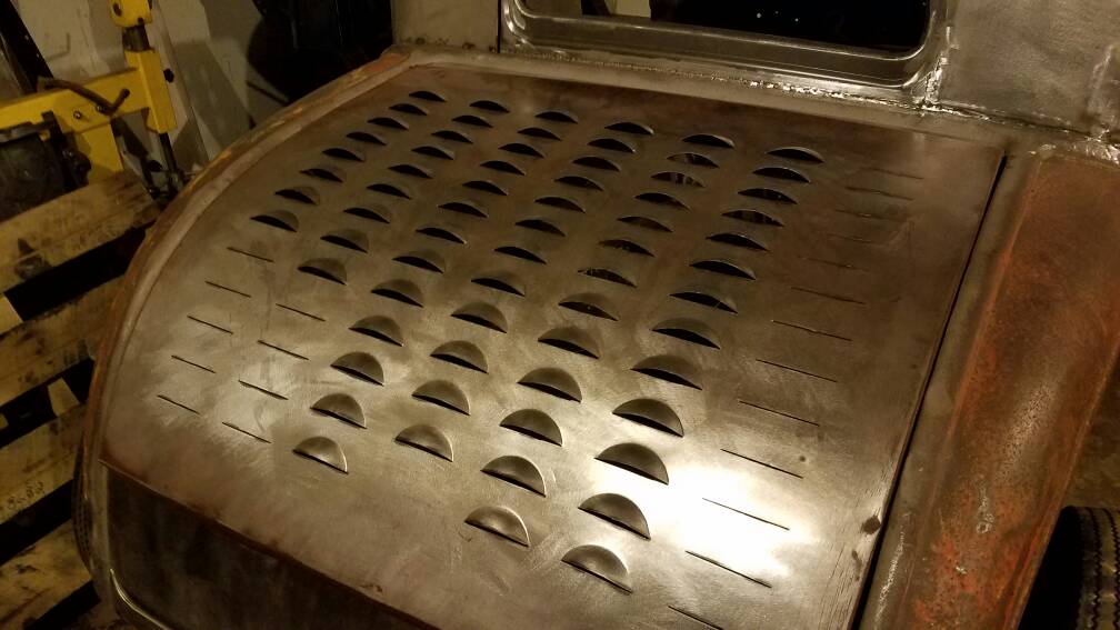

  17. Great build keep the updates coming. Would like to see more details about your louver tools and how you do it.

    Guys he covered his louver technique pretty thoroughly on page 7. Well a lot more the the average person would share their super cool secrets.

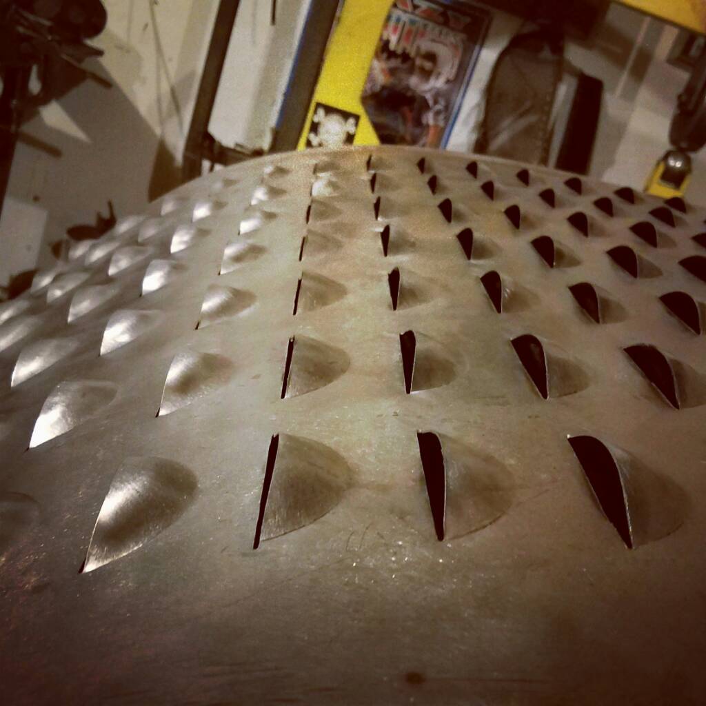

    Happy to share this info...I've learned so much on here over the years and have met some great people. Here's a pic of me in action from a magazine article that's coming out soon. I slide the top piece of the fixture over the guide plate..support it with my hand then hit it about 5 times. The sharp top edge profile comes from the crispness of the die.
