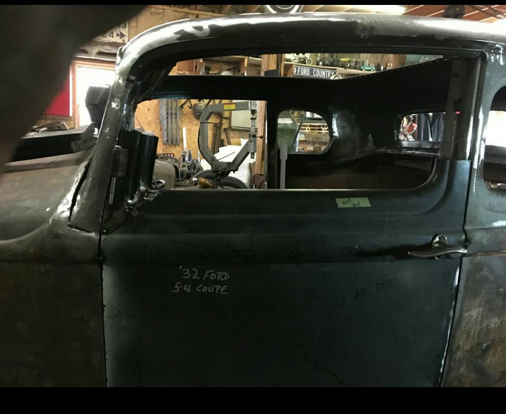

    Right now Andy is helping me sort out a couple things that I had some trouble with. One of the things was the hinge alignment on the a-pillars. Rather than reposition the hinge pocket on the a-pillar which a lot of folks do when they slant the post, he came up with the idea of using an alignment rod to make sure that the hinges are in the same plane so the door functions properly. You hit the top hinge with a torch and keep checking position with the alignment Rod until they are the same top and bottom. Then tweak as necessary to eliminate any binding. Brilliant.
    The A pillar is tacked in several places so in won't move prior to doing this

    nice idea.... thanks or posting pics. is the rod perpendicular to level floor or just inline?

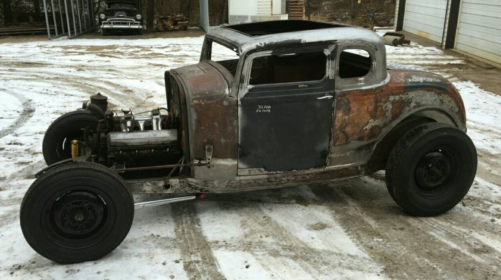

    Outside for fresh air. Andy gave me some help getting the top finished and the a-pillars and hinges situated. I think we ended up with some nice lines.
