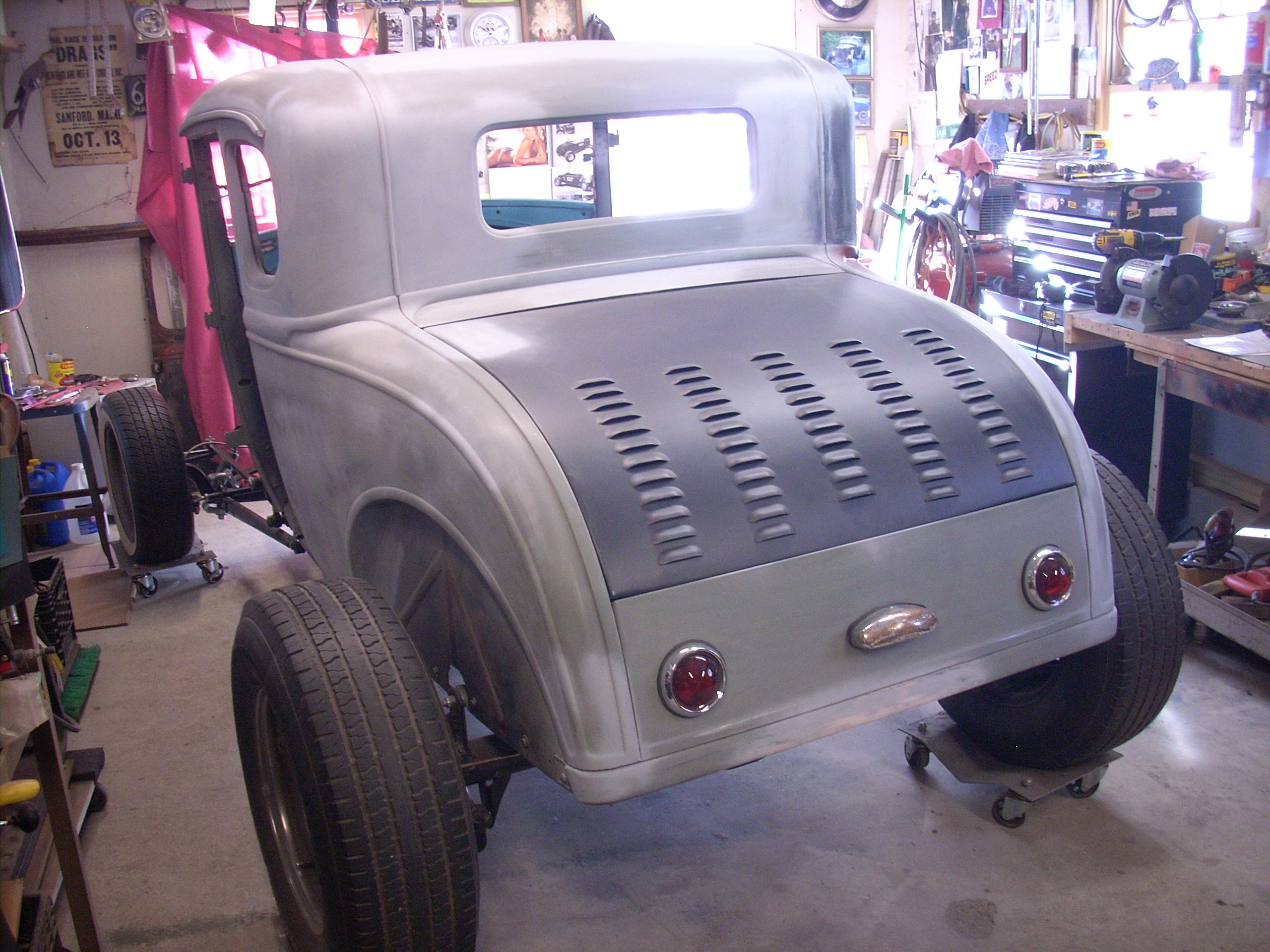

  2. mike bowling
    Joined: Jan 1, 2013
    Posts: 3,559
    mike bowling
    Great job-car looks right-on! That rear body treatment looks very familiar.

  4. HomemadeHardtop57
    Joined: Nov 15, 2007
    Posts: 4,340
    HomemadeHardtop57
    Replacing all the quarter wood with steel. Slow tedious work that doesn't look like much when done, but it makes things real strong
  5. 3wLarry
    Joined: Mar 11, 2005
    Posts: 12,804
    3wLarry
    from Owasso, Ok
    sure is dark in your shop ;)

  6. HomemadeHardtop57
    Posts: 4,340
    HomemadeHardtop57
    It is actually ... My lighting is horrible and when I work at night I use a hand held shop light hung from the inside of the quarters to see what the hell I'm doing.
