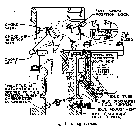

    So I am running a single Stromberg 97 on my stock model A engine.
    It is Running to rich at this point, it is a new Stromberg 97 with the original jets.
    I do have a fuelpump and fuel pump regulator that is set at 2psi.
    What size jets are you guy's running?

    I would have thought a single 97 with stock .045 jets would be fine on your 4 banger, you may want to check your float level, I have purchased several new 97 over the years and had a couple where the float level was set to high straight out of the box causing overfueling.

    The 97's do not vent the fuel bowl to the throat. A restrictive air filter will make them run rich. The original airfilters were really just screens.

    Is is fouling plugs, or just stinky? Have you tried driving it yet and see if it clears out? Just saying, the way these fuel the jets don't have much if any bearing on idle mixture at all. Float level can throw things off, along with too much transfer slot open. Easy way to check transfer slot is to look down the throat of the carb when running, if the boosters are dripping fuel your baseplate ****erflies are open too much allowing it to flow through mains and idle circuits.

    I forgot about the 2 different holes, the 94 Holley has a slot. Never the less if the ****erflies are too far open it will pull from mains. Hence why I said to look down the throat and see if the mains are dripping. This shows air getting pulled by the emulsion tubes and fuel getting discharged. It can also be a sign of float being too high also as it will drip when motor is off.
