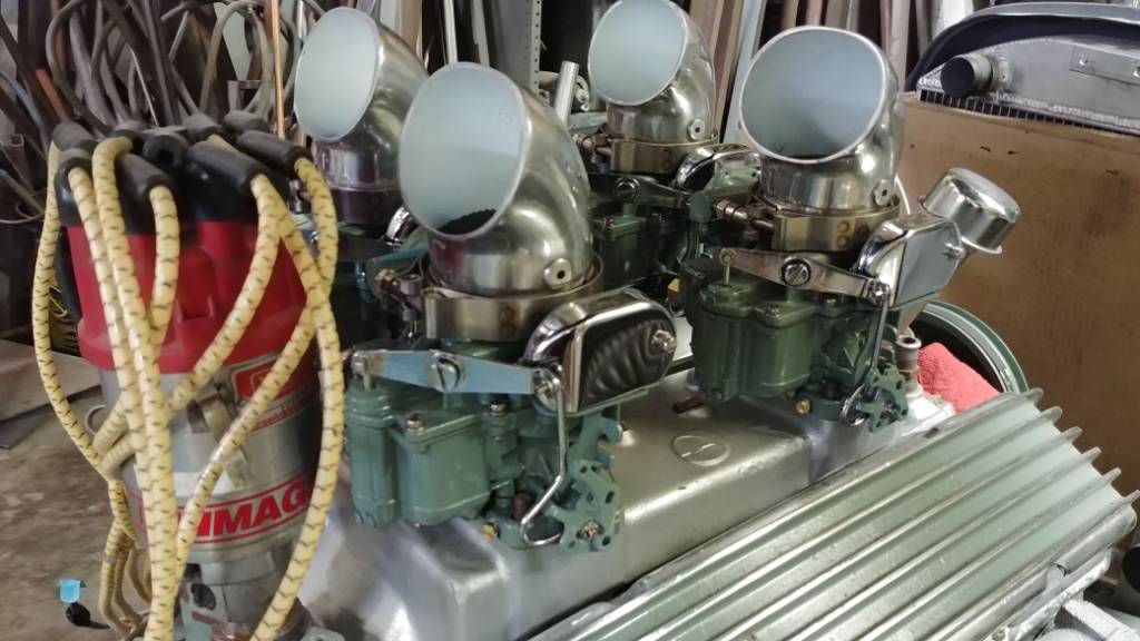

    Hey guys.
    Been trying to get the mix right. Mild 327 - Offy 6x2 manifold. Running progressive linkage so basically just running two middle carbs. I am down to 39 jets and 69 power valves. Front four plugs foul up really quickly then the car starts to run rough - I have a basic MSD setup. The back four plugs don’t get anywhere near as sooted up. I am gradually getting longer runs between cleaning plugs. Thought I would ask the question before I change jets again because they ain’t cheap here in Australia. [​IMG][​IMG]

    Solder works well for closing jets up, then drill back out to the size you want. When you get it running right, order the correct jets. Find someone with a Air/fuel ratio gauge you try, it will quickly dial in your mixture. As for the front running rich, block off the two front carbs with sheet steel or aluminum under the base gaskets. If the plugs clean up, look at the carbs to see why they are not shut off when not in use.

    ^^^^^my guess would be that the four secomdaries are leaking. At idle have you placed your hand over the carbs to see if there is vacuum present. The slightest leak is going to pull fuel thru. Have you considered blocking off all 4 secondary carbs and tuning to the primaries first then adding in the secondary carbs after it is running well on the two?

    Yes the secondary carbs do draw some air even though the blades are fully closed off.
    Thanks guys. I think blanking the secondary carbs may be what I have to do to isolate a problem that may be there.
