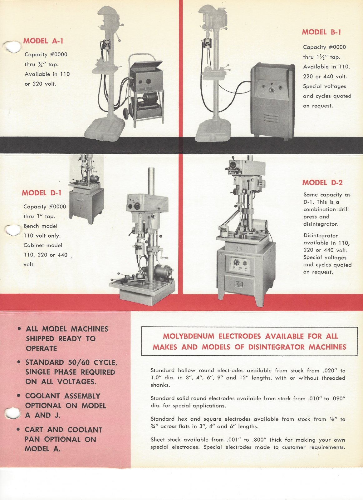

    This one is a modern version, similar to the one @trevorsworth
    https://electroarc.com/wp-content/uploads/2020/09/ExtractAll-X2-spec.pdf
    alanp561, trevorsworth and RMR&C like this.
  15. trevorsworth
    Joined: Aug 3, 2020
    Posts: 2,052
    trevorsworth
    Thanks, I'm getting a clearer picture of how to run this machine.
    How cool is that??? The second article was real helpful as it shows all the peripheral equipment that should go with it.
    winr, RMR&C, lothiandon1940 and 3 others like this.

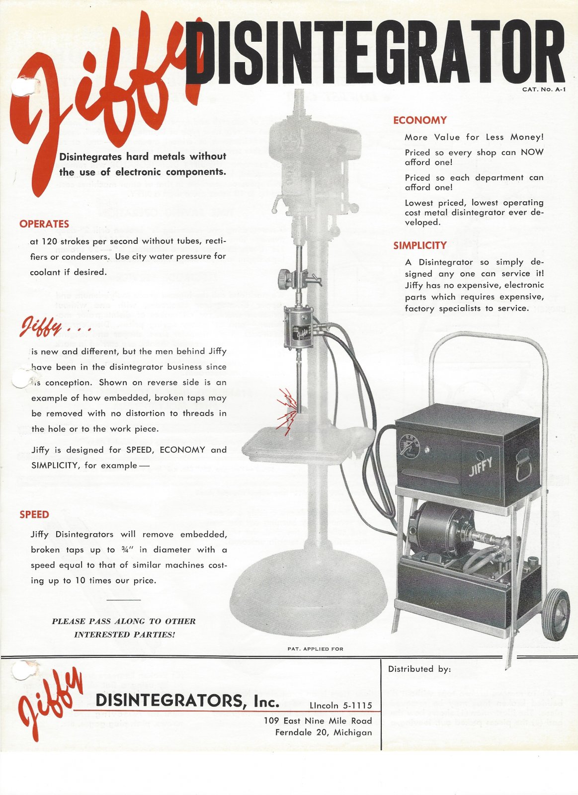

  16. Carrin Harris
    Joined: Sep 14, 2022
    Posts: 5
    Carrin Harris
    Hi,
    Electro Arc purchased Jiffy tool in 1968. You are not getting an arc because the dial is at "0" which is essentially off. This model needs a pump and motor for the coolant, it appears to be missing the chuck lock nut on the disintegrating head as well. Please note if you do test this machine the electrode should not make contact with the work piece and you must use coolant or water to prevent the electrode from becoming hot enough to melt the fixture.. I am attaching some promotions that include the Jiffy model A-1 for your reference.
    302GMC, RMR&C, lothiandon1940 and 5 others like this.
  17. trevorsworth
    Joined: Aug 3, 2020
    Posts: 2,052
    trevorsworth
    Thanks!! I did have the power dial on a higher setting when I had it powered up but I set it back to zero after shut down as I am in the habit of doing with my welders. I had just been trying to get it to spark to see if the transformer was operational but didn't have any luck.
    So there should be an external water pump to feed coolant into the disintegrating head? Can I gravity feed it?
  18. Carrin Harris
    Posts: 5
    Carrin Harris
    Yes, you can get an external pump and motor, the required specs are on the A-1 spec sheet. You could gravity feed it in a drill press. We do have a manual and parts lists for this model if you need further ***istance.

  20. Carrin Harris
    Posts: 5
    Carrin Harris
    I do work for Electro Arc. Most machines like this are obsolete, we don't sell parts for them anymore. Please send me an email marketing@electroarc.com
    Thanks!

    Looking through some of this material I realize the coolant pump for the disintegrator & the hand cart is in the garage at the place I got this from. We were not sure what the pump was for as it was stuffed back in a cabinet. I will be going back this Sunday to get it and some other equipment.
