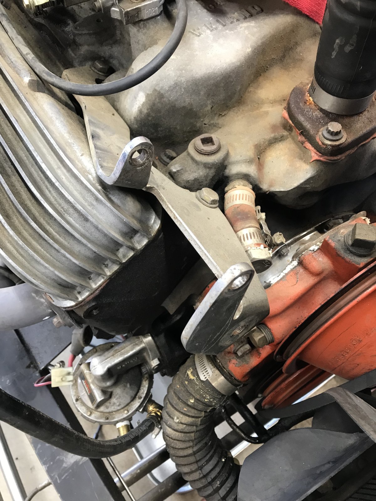

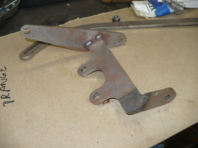

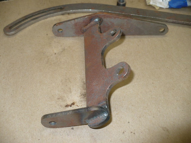

    Does this help? Bill

    Jitney Jakes bracket is set up for a PowerGen alternator . I have one on my engine run stand with a regular alternator. Bill

    Bill is it set up for a short or long generator

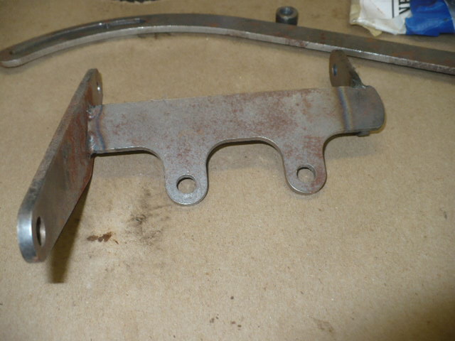

    Theirs always the DIY ugly but traditional, shade tree, version… FF0EA53C-3869-4857-8043-0D0207E873CB.jpeg

    Short

    I run one on our 57 Chevy (p***enger side) I have a spare on the wall (drivers side) iirc. If they dont have what you need available send me a pm.. Id part w my spare for whatever it cost me. I bought mine from Waldens several years ago. Worked great w a stock GM generator. It looks just like the unit 48 Stude posted.

    Does the front leg run down to the WP mounting boss or to a late model head boss?
    Thanks!
  20. 48stude
    Joined: Jul 31, 2004
    Posts: 1,399
    48stude
    It mounts to the upper water pump bolt. It works with early heads that didn't have bolt holes. Bill

    Looks genuine traditional 40's-50's hot rod to me!

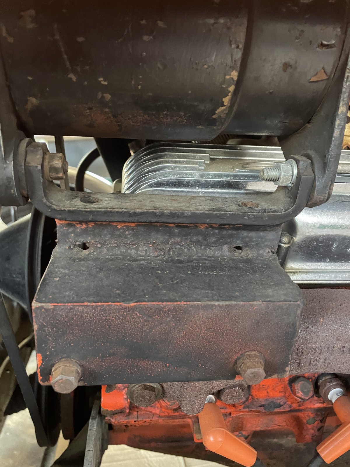

    Here is what I used, unknown year sbc smog pump bracket 3AE90D79-29CC-4A67-BF07-5EB0DD6EF6E8.jpeg

  27. Hey @nochop does the generator just bolt up and put the pulley in the right place or are their any mods needed.
    Also: I was reading your thread about the car this engine was in:
    https://www.jalopyjournal.com/forum/threads/blowing-this-thing-apart.1257505/
    and notice that it had an alternator on this bracket. Have you used a generator on this bracket on another build to confirm fit?
    It sure looks like an awesome option if it is a bolt on.

    I ran an alternator. I ran a spacer with the through bolt to get alignment
  29. Ya know, the design of that smog bracket sure looks like something a guy could copy and make one to fit a generator.
    It sure is a simple clean design.
