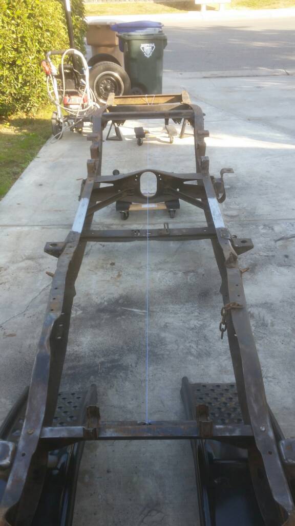

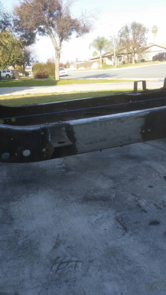

    Got out and did some ch***is work this month. I wanted to try my hand at shortening my truck to a short bed. Might as well since I'm changing the truck so much from stock. Did a bit of reading on the procedure and it seemed simple enough. 12" out of the center and 8" off of the tail. It did prove to be more work than I expected and I was freaking out a bit when I was cutting into the ch***is with a damn sawzall. A pretty labor intensive job mostly because of my lack of tools and the height of my work, and steel is heavy. I did 99% of it alone, but I did get the job done and the ch***is is straight as an arrow and the joint is flush. When I get home from work this month I will back and reinforce the welded joints with plating and hardware as well as remove the rear cab mounts and replace them with solid mounts 12 inches back from current position. With a couple of more t*******s, it will be 100% ready for blast and powder. I'm really happy with the outcome of this modification. [​IMG][​IMG][​IMG][​IMG][​IMG]

  2. You did a beautiful job.
    I shortened a 70s Dodge once. It was a wrecker with a rotted frame right where I had to remove 18 inches. I converted it to a short bed pick up. Everyone ***umed I put 1 ton axles under a half ton truck.

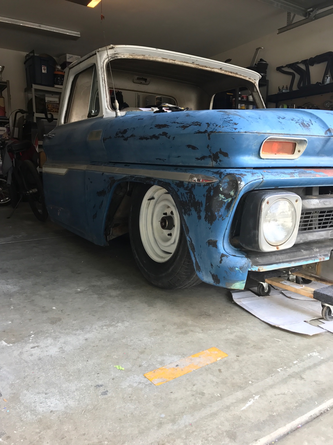

    Got quite a bit of cleanup done. Front calipers, cab ready for blast and seal, rear end clean and a quite a few hours cleaning ch***is and knocking off unwanted rivets and installing rear cab mounts. Staying busy on my Lil 2 car garage frame off build.
