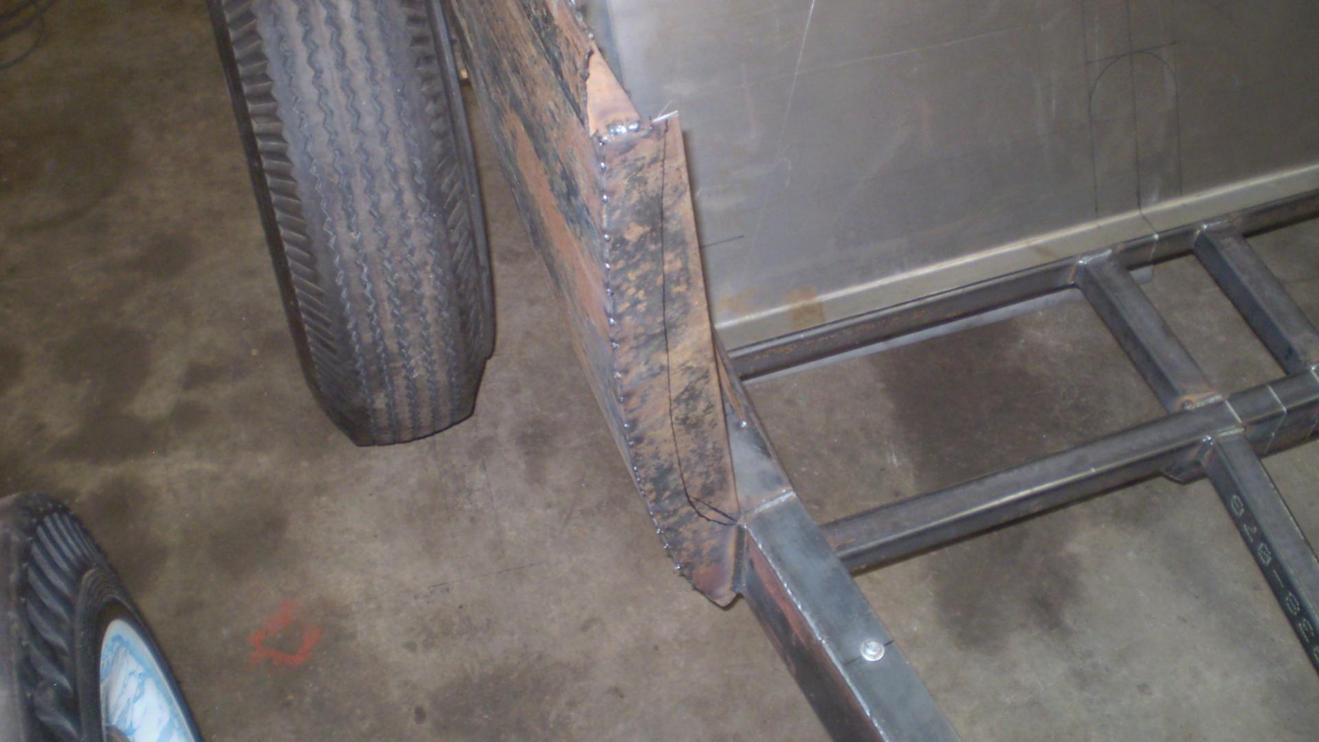

    Man, this is just too cool! What gauge sheet did you use for the floor? And now that its welded in how are you going to strengthen it so it doesn't oil can? Or is it heavy enough that it won't?

    it is 16 gauge . i should have rolled some beads in the floof to keep it from rattling but it is kind of heavy and i will run bolts throught the floor in the x members like a 33-336 ford. theat should keep the noise down. i am trying to get the car dont and running out of time. i wanted to have it ready to go to bonneville speedweek this year but time is running out quick . i have to have the tub running buy the first week in october at the latest.

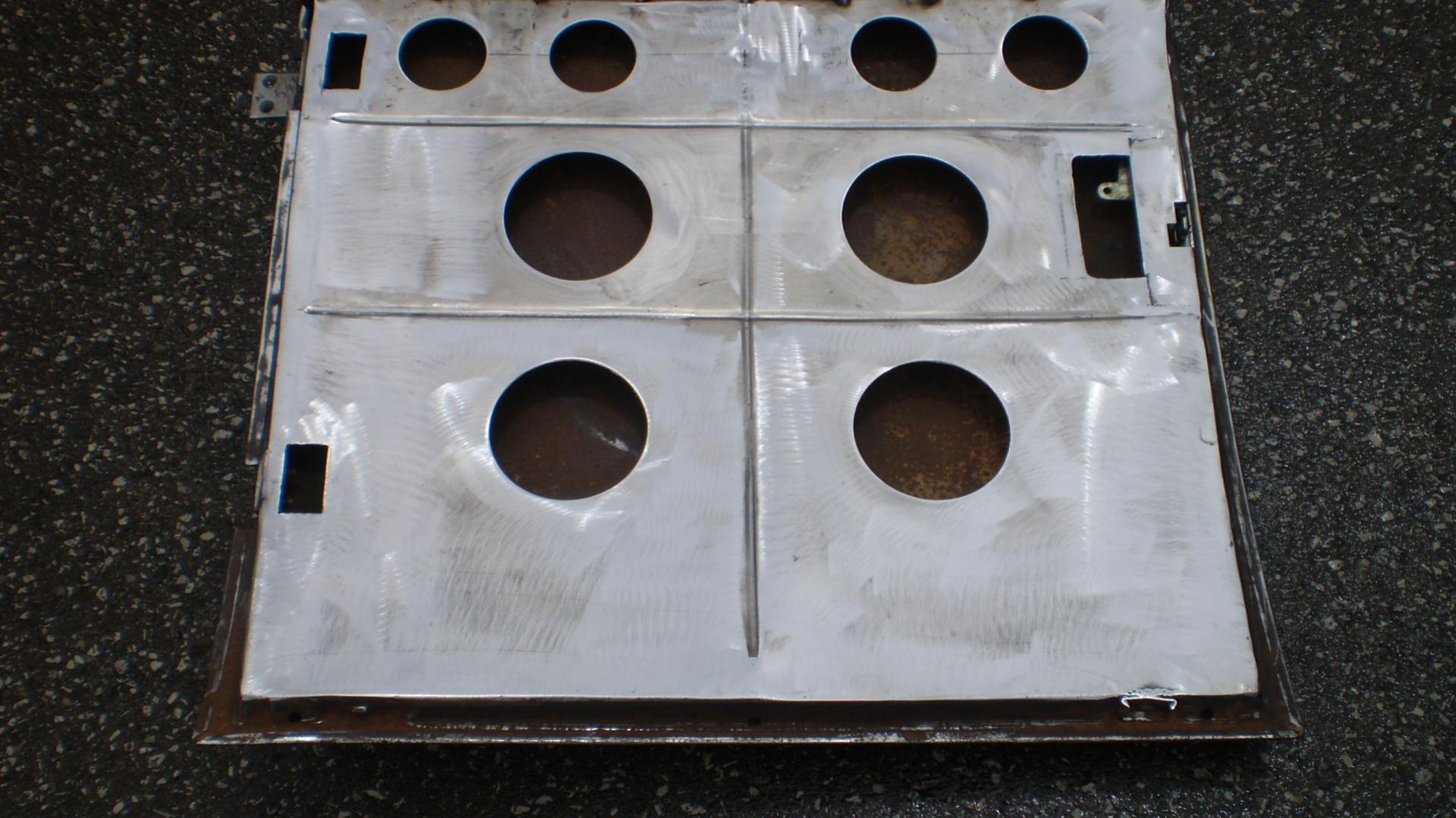

    here are some new pics of the doors. a sedan door is about twice the width as a roadster. i had to cut it down and thin it out. now the sedan door just had and inner skin at the top for the window regulator. a roadster door had a full skin. i just got a picture of a 28-29 model a roadster inner door structure and copied it but also had to make it longer to fit the sedan door. these new inner structures are not totaly exact copies but close enough . all this work and they will be hidden by the interior. i also put in bear claw latches aswell.

    This is good stuff. I've been debating thinning out sedan doors as well on my coupster. I do believe that just capping the doors throws off the car itself. It'd be fat.
    This is giving me ideas and is getting me to think on how to thin my doors out. Thanks.

    put those doors on jenny craig!!!!!! yes they need to be thinned. my though is that if i were to just cap the they would look like there were JUST CAPPED . they dont look right. it wasnt to hard to make up some inner door skins.
