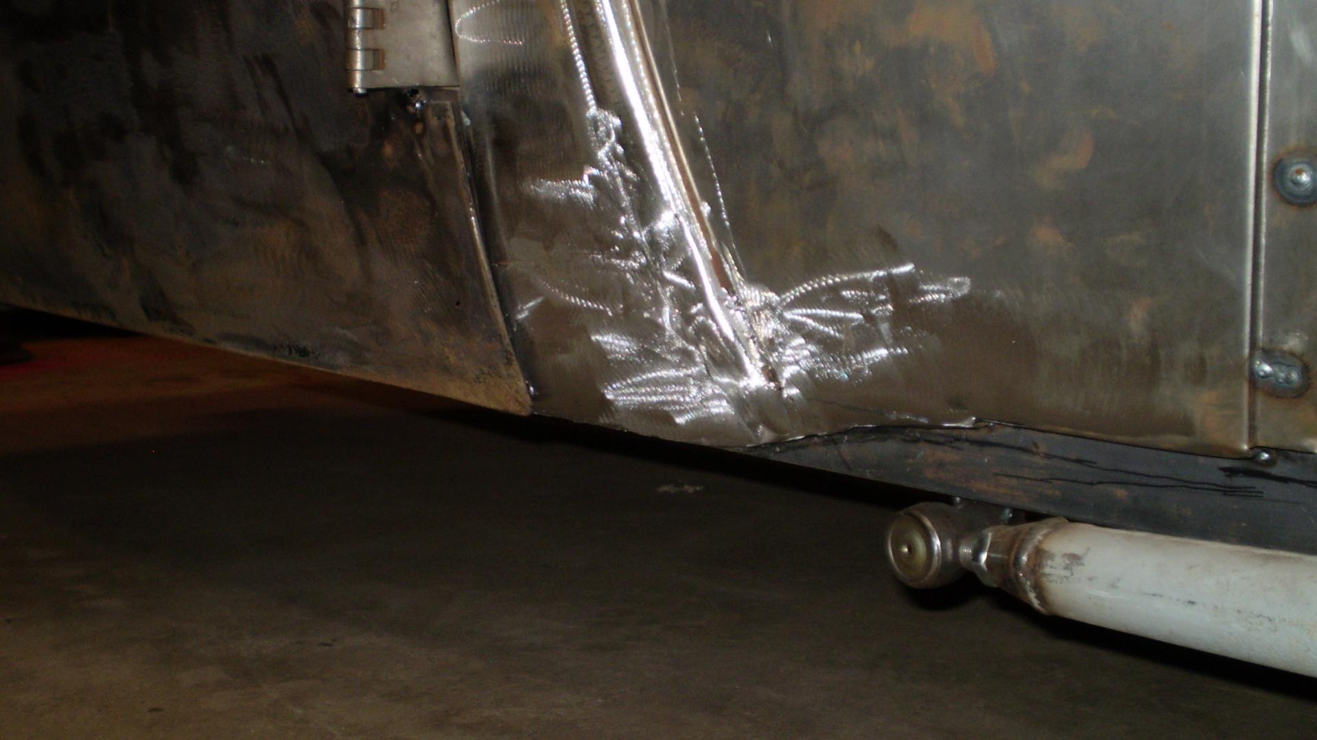

    here is some pics of the cowl area that i reshaped . is still need some more final grinding and welding once the body is off the frame . also i wanted to reinforce the body quarter more so that when i shut the doors the quarters were good and solid and stayed put. also i trimmed the back of the body for the winters quick change. i will be making the hood next

    i need to do a final grind on the very bottom of the cowl but i will do that when i take the body off the frame but you get the idea of the shape

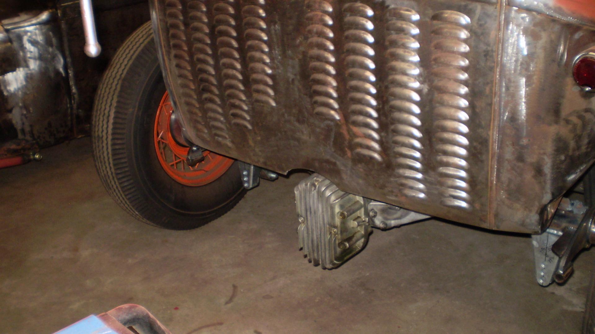

    i got the hood sides done. i still have to attach them with some lunch box latches. i will be sending the hood out to a guy i know that will punch the hood side full of louvers.just about ready to pull the tub apart for paint. hotrodhighley will be spraying the frame. here are some pics

    good stuff,what color?

    chassis will be black, body old red primer for now till i get back from bonneville, and the hood will be left raw aluminum.
