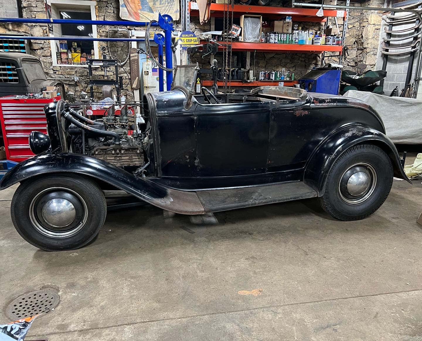

    Was a productive day… Gave the car a CLR bath and a lot of the black paint came back. More work to do but I think it’ll be perfectly shitty when done.

    On your CLR bath, do you just wet a rag and rub it around or do you spray it on and let it sit? How do you do it?

    I took a wash bucket and filled it Halfway with hot water and half a bottle of CLR. Then used a non-scratching scrub pad and soaked the panel and scrubbed with it. I know some people suggest to use a red scuff pad but I think that just puts a shit ton of scratches in the panel you have to then polish out. I think using the red scuff pad in certain areas that are worse would work ok but I didn’t want to do that on the entire car. I don’t let it sit too horribly long on there.

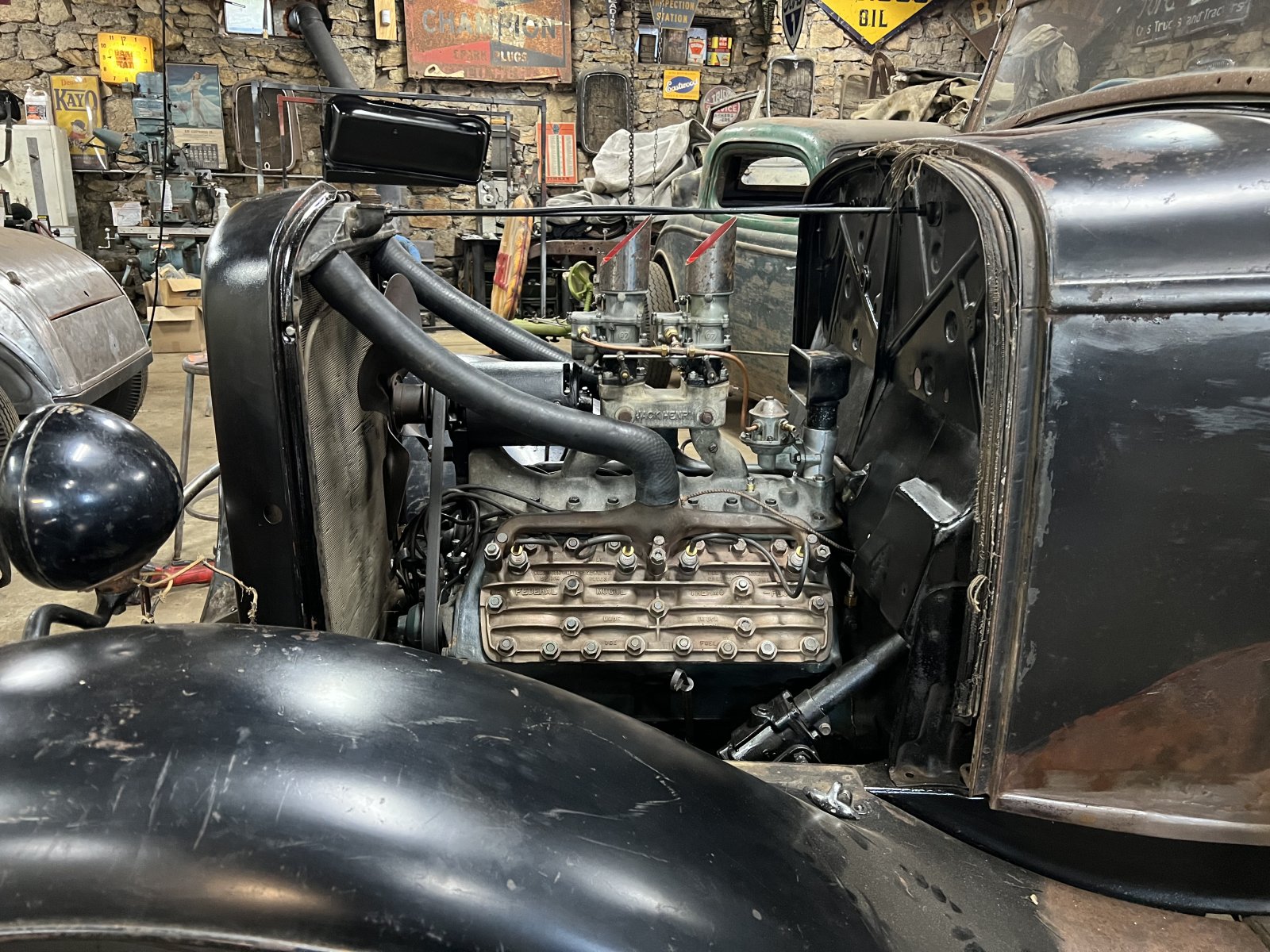

    Drivetrain all installed. A snotty 286 59ab, 39 trans, and a bullet proofed Columbia rear made to fit a 32-34.
    Also welded the threaded filler neck onto another 32 tank and added a flange for a SW fuel sender. While I had the tank out I cleaned, painted and shitified the rear gas tank cover (it was super crusty with zero paint left). Making some headway now!

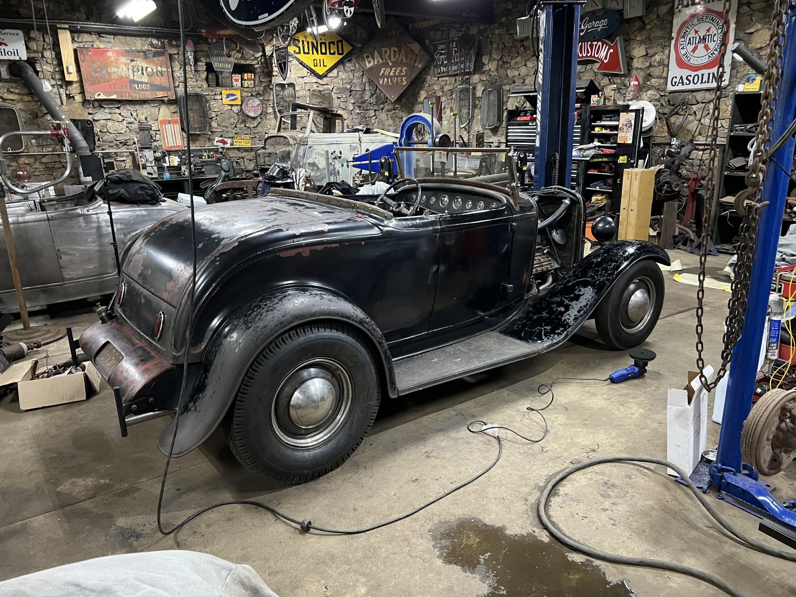

    A little new lacquer sprayed on the areas I patched and the passenger door that was missing all of its paint. Spent today doing a lot of polishing and was able to bring most of the old lacquer back. Still need to do the hood but big improvement!

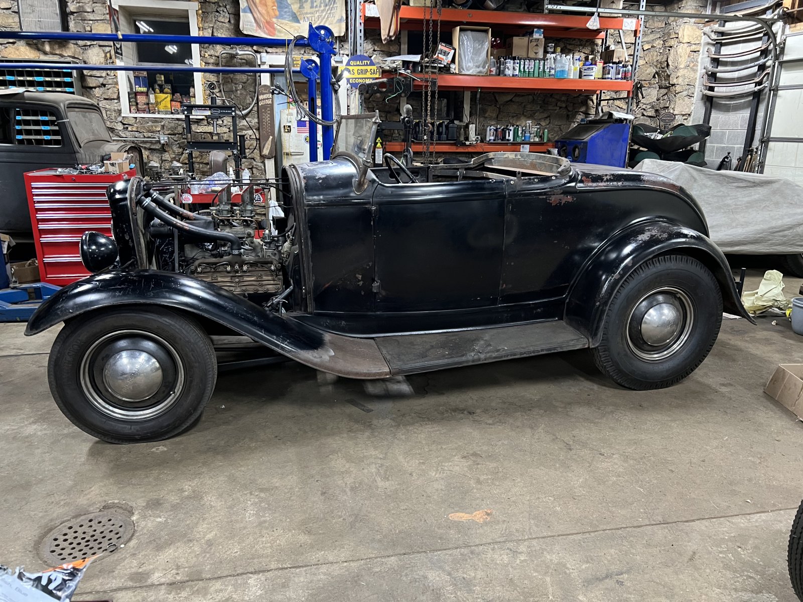

    Got a better old black lacquer filled grill and got the hood to fit a little better. Pretty much good for some shakedown runs when it gets warmer. Have a very talented friend recreating the top and doing the interior in the spring. Hopefully it’s 99% “done” by late spring!
