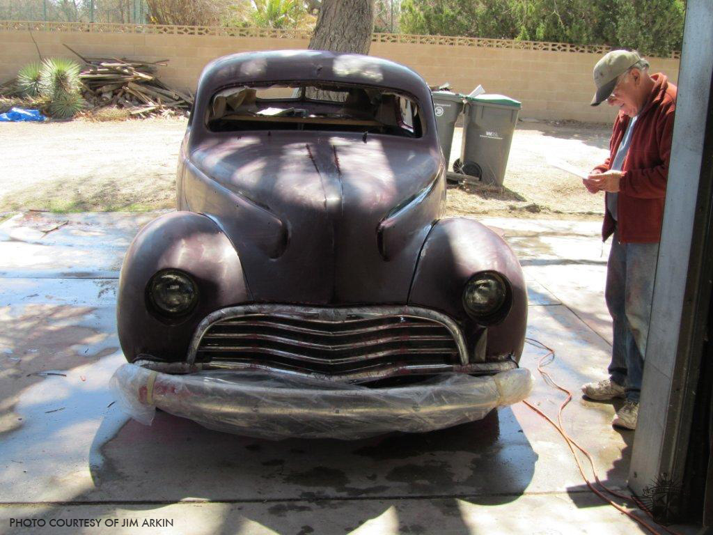

  1. We built this 39/40 Merc from a 4 Dr sedan with a bunch of cuttin' and welding 46 Chevy grill and bumpers, 52 Ford side trim on the running boards, 40 Ford side trim' front and rear pans between the bumpers and body, one piece door windows, chopped top, flush mounted skirts, Buick dash, slanted door pillars, 57 Cad hubcaps, Cad style exhaust tips, a lot of little things . We were going for a little "Bertolucci tub in a sedan" and I think we made it work. JW[​IMG]

    Interesting color choice. Got pictures of the front end and dash?

  4. Johns car is painted Automotive Deep Burgandy acrylic enamel
