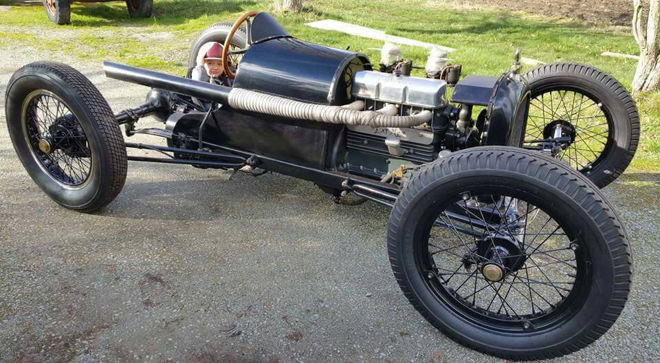

  3. T__N__A
    Joined: May 31, 2006
    Posts: 368
    T__N__A
    No still have driven it yet, we have ti pull the head and repair it.
    These ended up getting full welded because they almost ended up getting nickel. I I used To radius rods on my other single seater and spot where welded like the pictures and seems to be holding up fine.
    I had the local radiator build a custom one. Made a wood template of exactly what I wanted and had them build it to that. The made it spot on, probably within a 1/16"!
    The front tires are Firestone's and yes the backs are Lester that had been grooved. Just the cheap grover you can get a speedwat, they sell different style and thickness cutting blades.

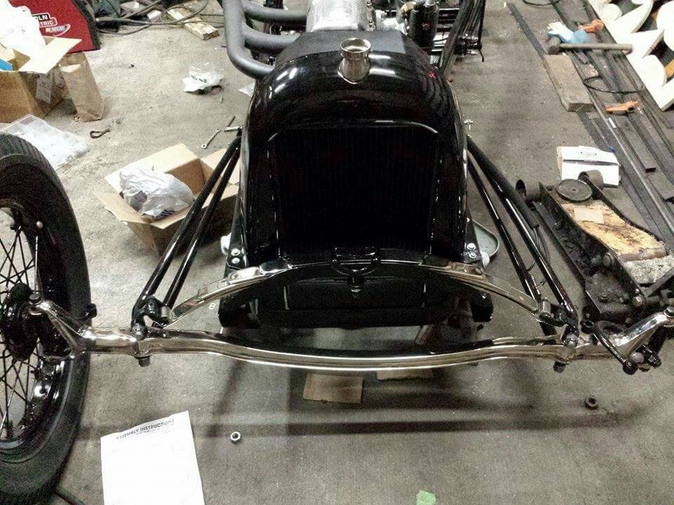

  4. T__N__A
    Posts: 368
    T__N__A
    It don't have a picture of the radiator in this car but I do have a picture of the radiator out of my other single seater. The were built buy the same guy and almost identical, except the one shown is 3" narrow to match the narrowed Whippet radiator. There is 1"x1" angle that support the sides and fill up the tapper between the sides of the radiator and shell, once every is painted black it is hardly noticeable

  8. Yes! More please!

    Cleaned up a bit more from the trip to New Jersey. Should have the hood back from paint soon and waiting on the engine builder to come up before we test drive it

  10. T__N__A
    Posts: 368
    T__N__A
    Close up up of the nickle front axle and spring

  15. The37Kid
    Joined: Apr 30, 2004
    Posts: 32,548
    The37Kid
    What are you running for wheels? Car looks great! Bob
  16. T__N__A
    Posts: 368
    T__N__A
    The fronts are 21" Hayes and in the backs are 21" Buffalo's
  17. rod1
    Joined: Jan 18, 2009
    Posts: 1,532
    rod1
    That is Great.Gotta be smiling...
  18. I've seen the inverted front crossmember to achieve several inches of lowering on T Speedsters lots of times, but never the curved spring to clear the frame. That must be a unique feature of the original car, and I'm glad to see you chose to include it in yours. Nice build! Please keep us posted.

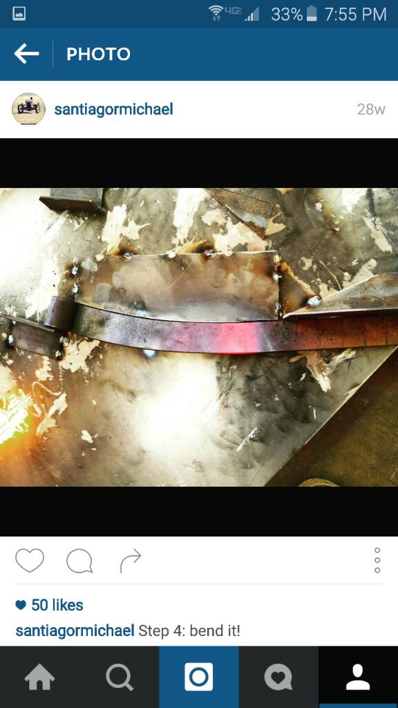

  19. The37Kid
    Posts: 32,548
    The37Kid
    Just how tough was it to bend the front leaves? Bob
  20. T__N__A
    Posts: 368
    T__N__A
    Yes the front spring is one of my favorite parts of the car, it was a **** ton of work. I have not seen the done any any other car except for the Whippet special which makes it pretty unique.

  24. T__N__A
    Posts: 368
    T__N__A
    Step 4: bend it!

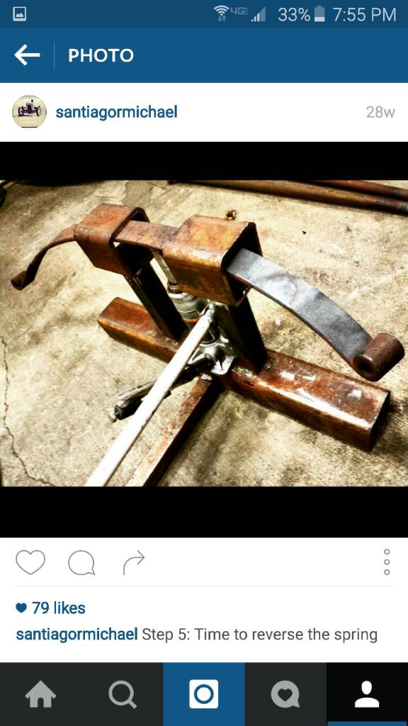

  25. T__N__A
    Posts: 368
    T__N__A
    Step 5: Time to reverse the spring.
  26. How was it for temper after all that?!
  27. T__N__A
    Posts: 368
    T__N__A
    It was pretty soft! Almost like mild steel. On to step 6, step 7 is tempering the spring.

  28. T__N__A
    Posts: 368
    T__N__A
    Step 7: Heat up the spring evenly until it's a dull red color and toss it in some used motor oil, wait until the flames die out and your back in business!
    catdad49 likes this.
