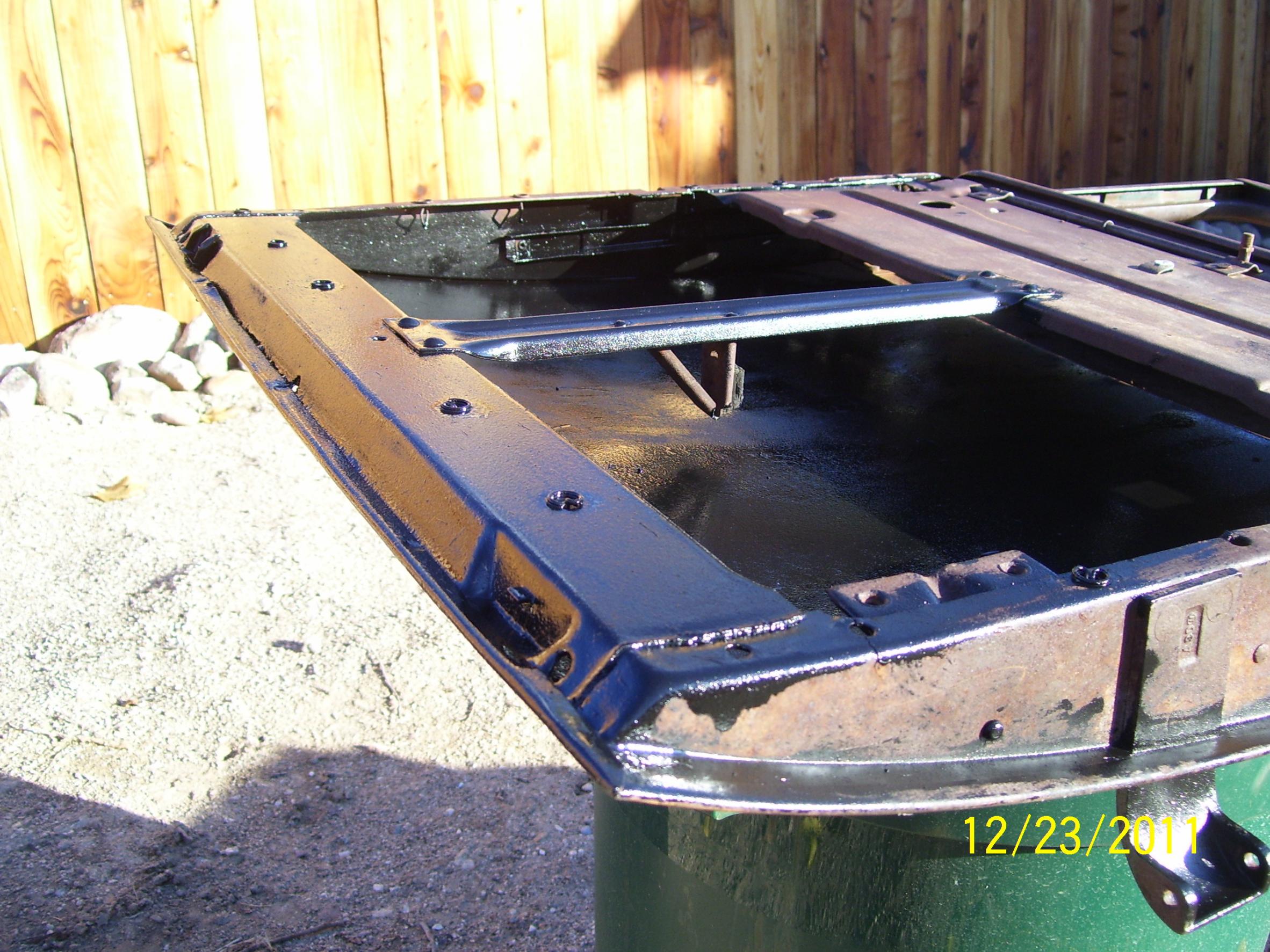

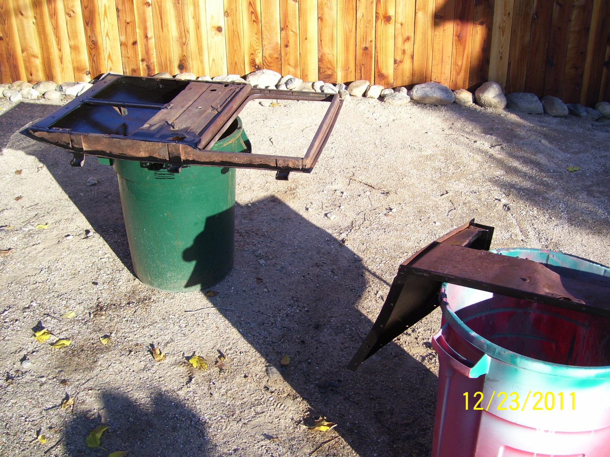

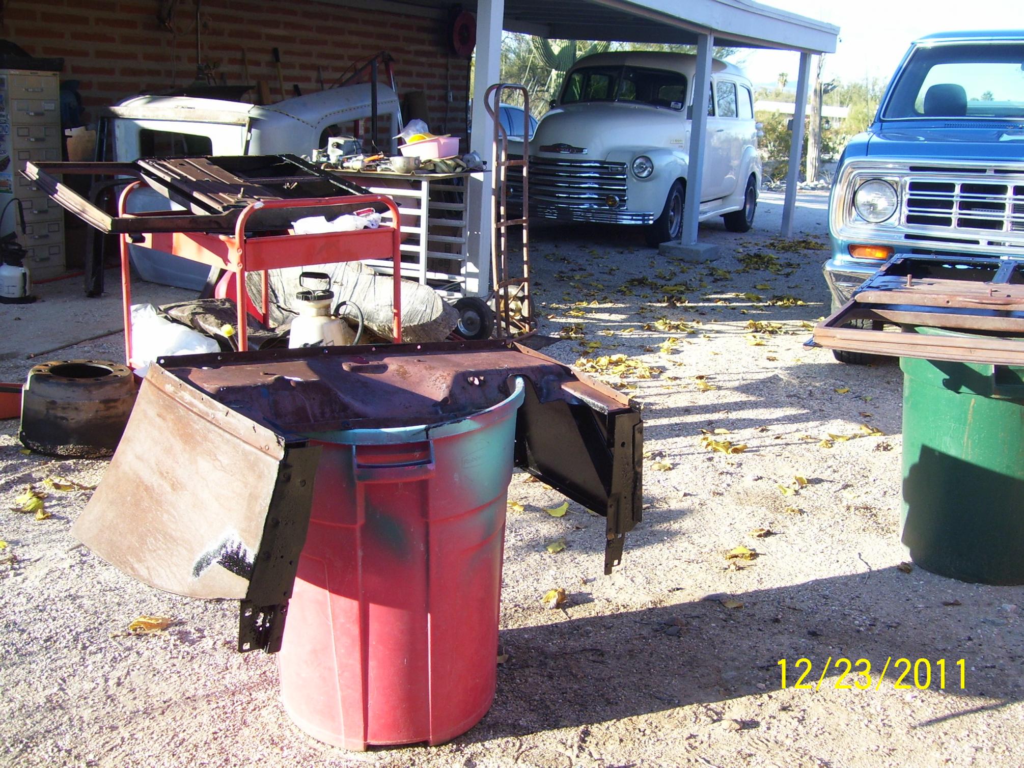

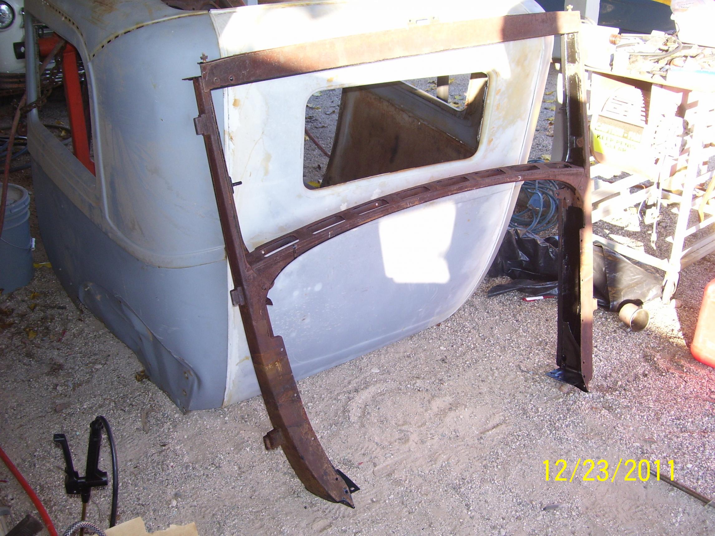

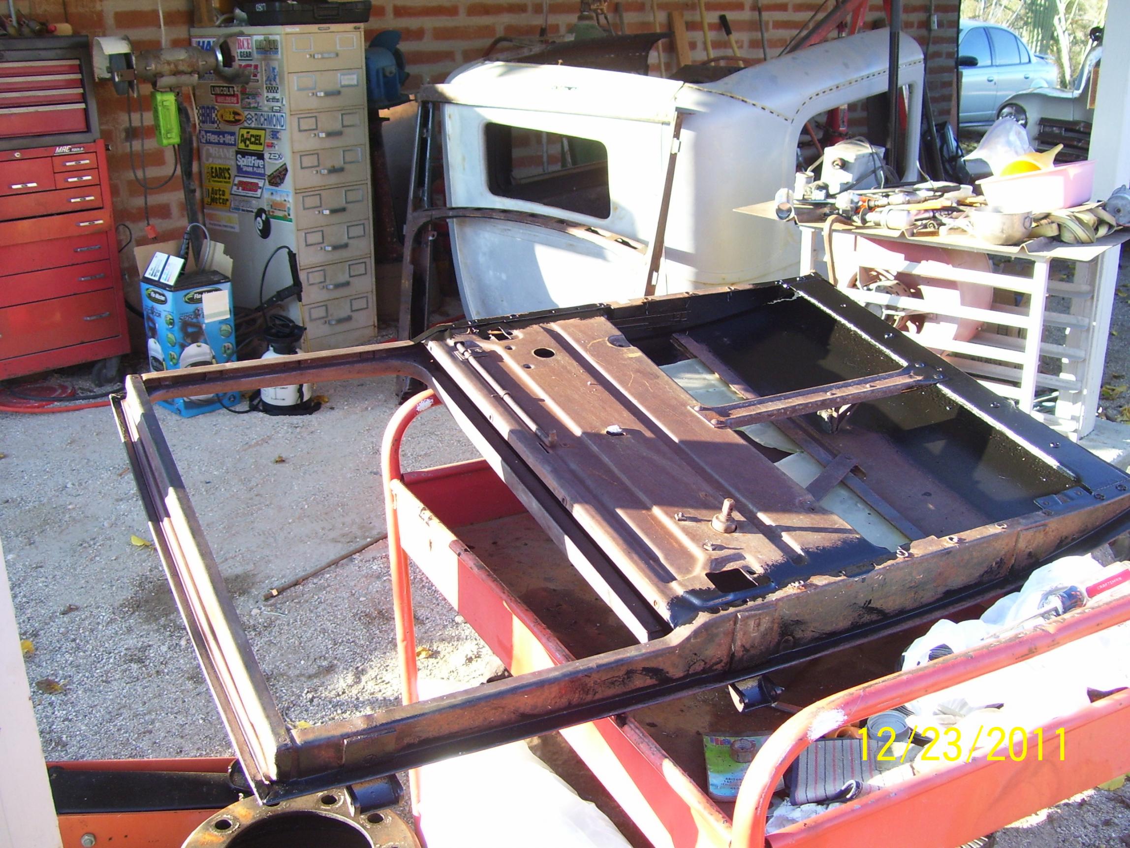

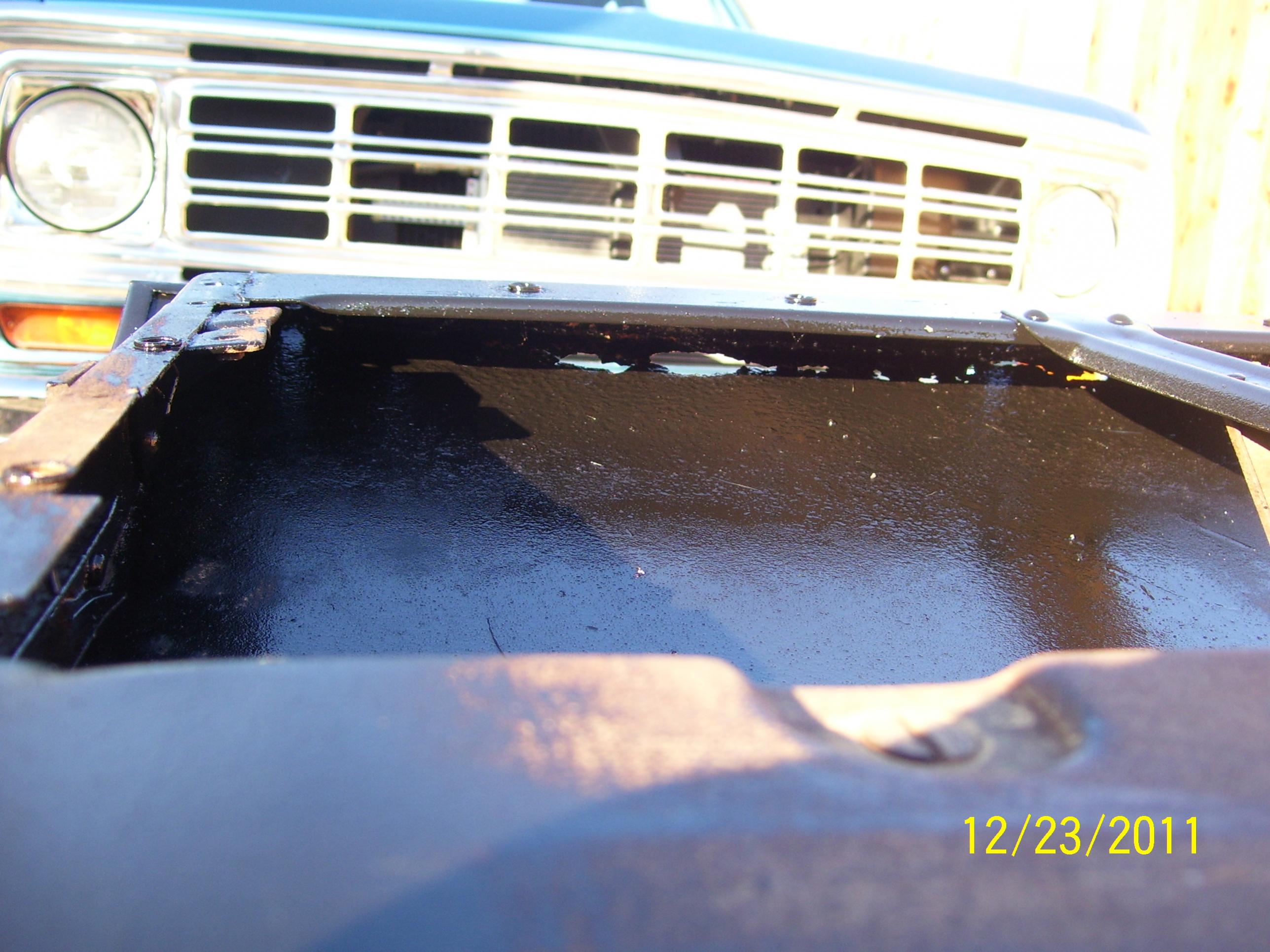

    OK, got back on it over the Holidays.
    Took my very solid subrails and brush painted them in POR-15. Since I had the can open and the brushes out, I coated the door edges, cowl edges and the windshield frame/cowl section where no paint will go. I found some numbers stamped in the subrails, so I kept them clean.
    The sixth pic shows the door bottom rot, that'll be an easy fix! Similar for both doors.

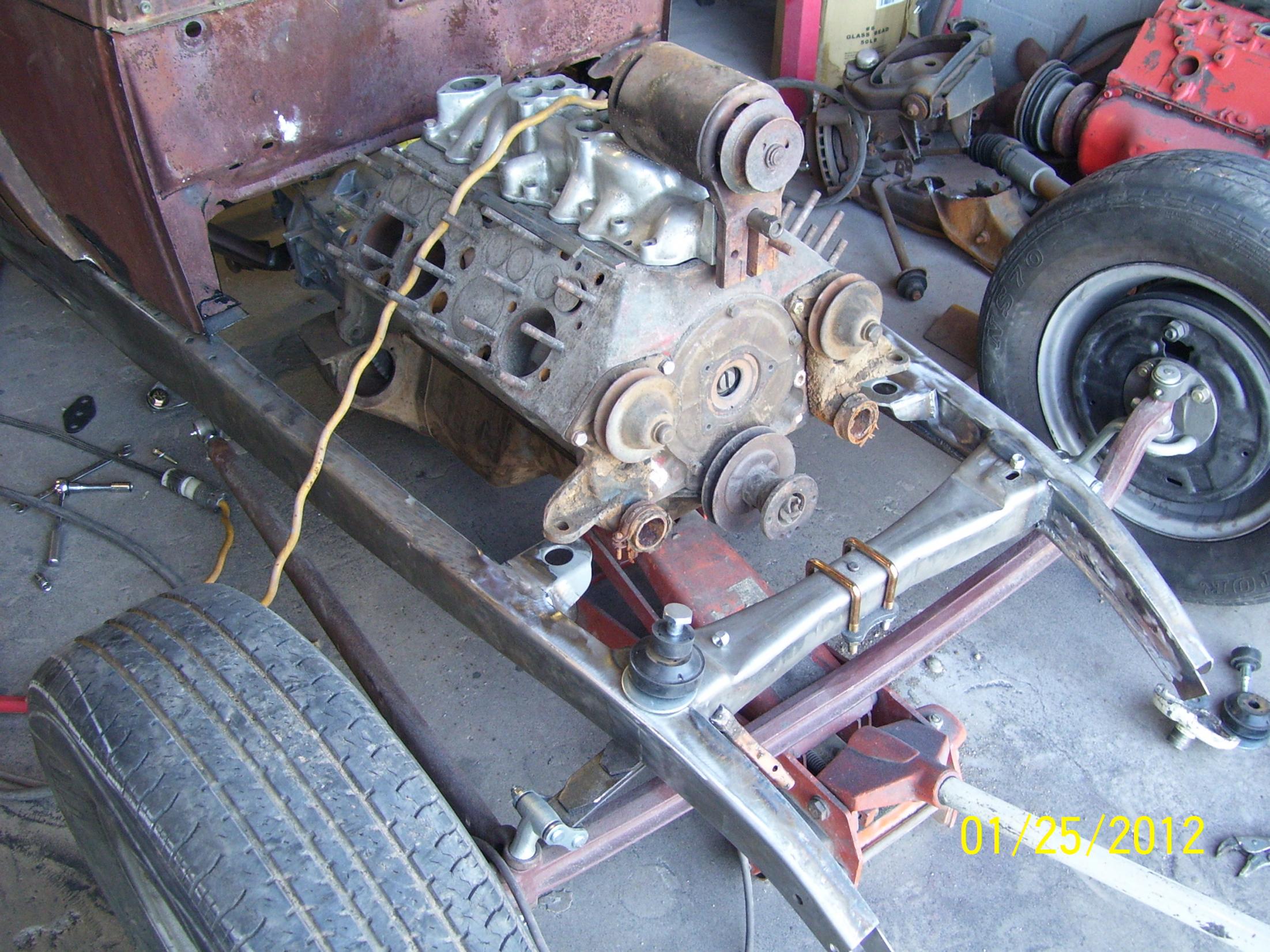

    Went to the shop after work and got the engine, adapter and trans bolted together. This isn't my flathead, but its similar and works for mockup.
    Set in place and after some adjustments put it where it's gonna reside. Looks good to me, minimal floor trans hump with decent clearance.
    Used engine mounts that Peter had in stock at the Old Ford Store next door. Randy welded them in real nice and I'll grind the tops flush later.
    Trans mount is next visit. 'Twas a fun night for sure!

    After getting the body in place, we realized the engine was too far forward.
    Oh well, cut and weld!
