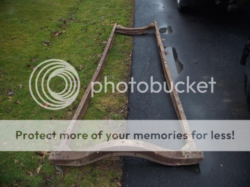

    He is my build thread for my 1926 Model T touring. I have a two kids so the touring body will work out great. I have a model A frame, model T rear spring, 8AB flathead, 3spd with overdrive merc ******, and 39 rear. The body is being delivered in two weeks. I have the frame gutted and boxed and currently I'm working on mounting the rear and engine/trans. I plan on painting the car a medium green with a cream wires and suspension. This is my first personnal hot rod so I'm pretty stoked!

    That frame looks STRONG- good work.

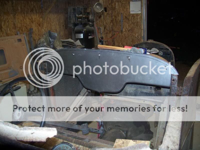

    Some pics from last night. I fabbed up a new dash and fitted to the car. I'm going to use rivet head screws to hold it in the car, right now I just used some 1/4" bolts. I'm trying to decide which gauges to use. I have a complete 55 packard dash and a unknown speedo I picked up at Hershey.
    I was thinking about using the turn signal arrows and mesh background from the packard. I would cut it between the outer gauges and the switches. Not 100% on which way to go so opinions are welcome!

    bump for opinions

    speedo is 46 47 or 48 ford.. i like it mounted in the center..

    very cool dash making progress good luck on your build
