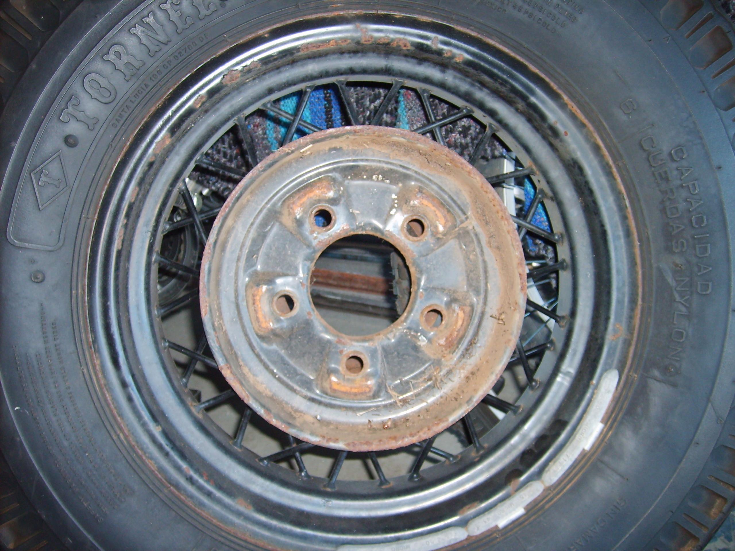

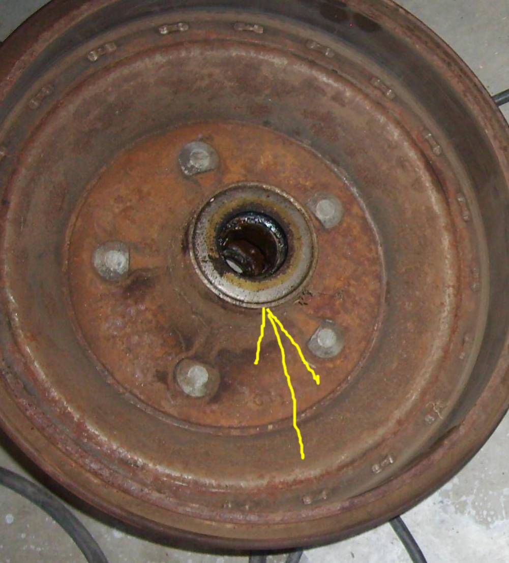

    this a picture of the wheels Im using that fit prior to me taking apart the front end...also is a picture of the spindels that Im using.....do I need to still get a Hydraulic brake adapter ring..it was not on there when I took them apart?
  16. Those round back spindles will work with your 39-42 backing plates.....you will need a ring on the drums if your using those wires....those bumps on the back of the wheel will not allow a flush fit up against the drum......

    the ring for the drums is it a special kinda ring...made just for attaching the wheels?
  18. Yes, the 35 drums had support nubs on em that seated on the wheels, later drums need the rings to work together
