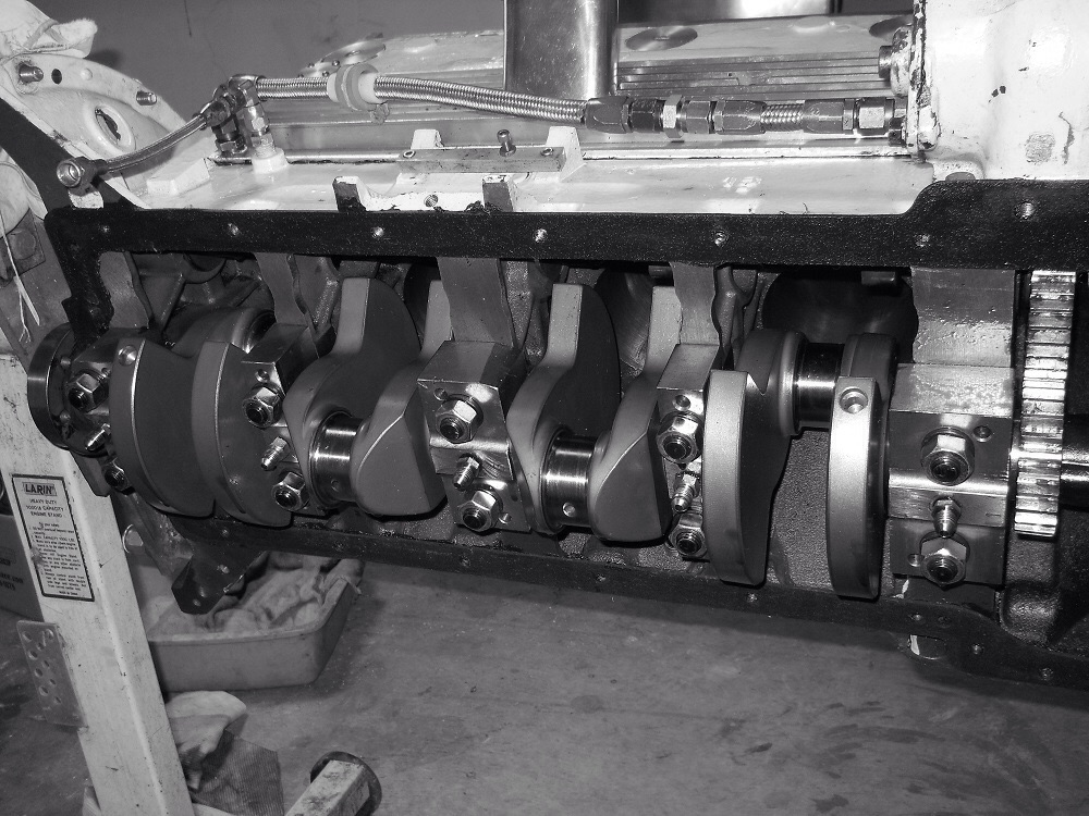

    image.jpg What is this motor? Thanks Frank

    a very healthy banger ?

    linkage.jpg 001.JPG If you subscribe to F.A.S.T (Ford A Speed something) or Secrets of Speed Society you will find lots of Banger only events nation wide. Google them. The motor is a '26 Dodge

    The motor is a '26 Dodge ..................... a very healthy dodge !
