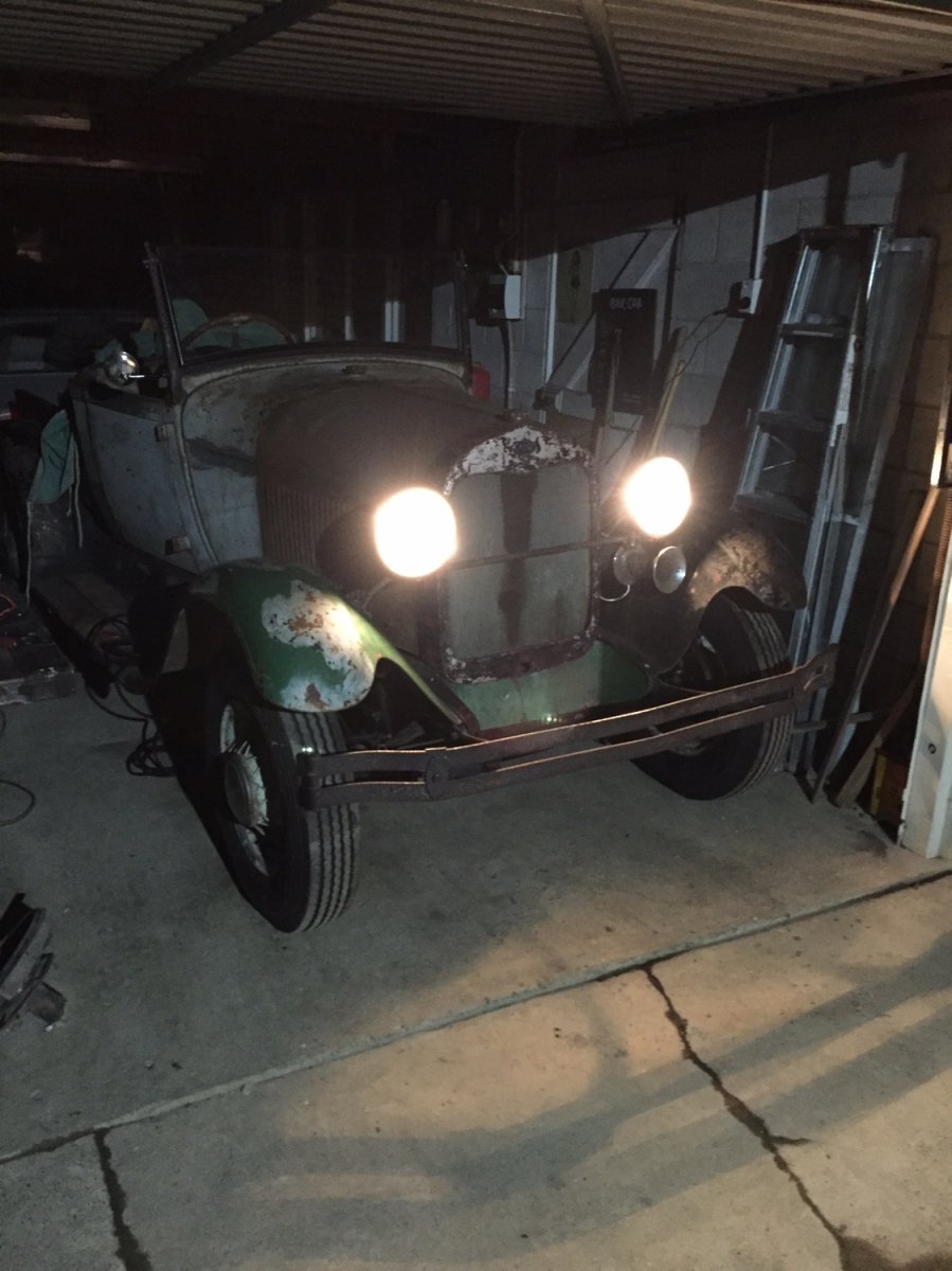

    Just checking in, have lights now, high and low beam seem to work great, but for some reason the switch won’t go into the park position,(clockwise from off position.
    Any thought? I have a new repo loom that I have filed down the connector plate to the thickness of the original. And I’m using a good original switch.
    With out the plug install the switch on the steering wheel has full motion but when plug is installed will only go from off round to high beam with positive detent in all positions.
    Any ideas would be appreciated.

  13. What do you mean by "plug"?
    Wiring in an A is very simple, and it helped me a lot, when I did a simple, schematic drawing of it - I have visuel memorative skills, so if I draw somethin, I understand and remember it better. And the positions on the switch is easy to understand too, if you take it apart. :)

    Craig,
    Had similar problem with mine. Light switch spider P/N A3643 has to be set up properly into switch or it won't turn both ways. Had another that light rod was broken at bottom and wouldn't turn both ways, but did work one way. Good luck. Love the Ute?
    Dannerr likes this.

    I can see that the car is a 28-29, BUT do you know what year steering column it has? There are two different length light switch rods for 28-29 and a few more for 30-31, if you don't know you have a matching set you have to carefully mess with the switch and the bale and the rod etc to get it all to work together...mix and match can be a real pita.
    http://www.fordgarage.com/pages/lightswitchrods.htm

    Hi Dannerr, first of all thanks for the reply.
    I’ll clarify on some naming first, I’ve been calling the switch at the bottom of the steering column that is held in with the bail a “plug” and the switch on the steering wheel a “switch” to differentiate them.
    So what was doing was splitting the plug and removing the contact disc to ensure I was getting full motion with the switch (park, off, low and high) and I am.
    Leaving that half of the plug installed, I fit the contact disc, and back half of plug locking it into place then checking switch and I have (off, low and high) switch feels good going into these positions. But will not go anti clockwise back into park...
    Hope that explains my problem
    Cheers Craig

    Hi midnight rider, thanks for the reply. Yep it’s a 1928 RPU, which had been cut down from a pheaton well before I go it.
    I did wonder if the spider was catching on something... it’s a head mess when it will go one way and not the other... I have checked the light rod and it looks all good and horn functions sweet.
    I’ll look at the spider abit closer with half of the switch ***embly in place.

    Hi 97 thanks for the reply.
    Good spotting, you bang on it’s an early 28 or some call them an AR, and abit of a basket case at that too.
    So what I’ve done so far to make all work.
    Steering column is original to the car, to the best of my knowledge. As it seems to be with this car the light rod length isn’t listed on your chart... but because I’m using the column and steering box that’s matched to it will it be a problem?
    Removed original switch as that was for the single light wiring loom,
    Have a new two light loom as well as a good two light switch (plug at bottom of column)
    Bail was to short so have removed that, need to order or make a new one.
    Horn works fine, low beam work fine and high beam works...... so strange it won’t flick back to park..
    Thanks again everyone for reply’s I’ll keep ya posted
    Cheers Craig
