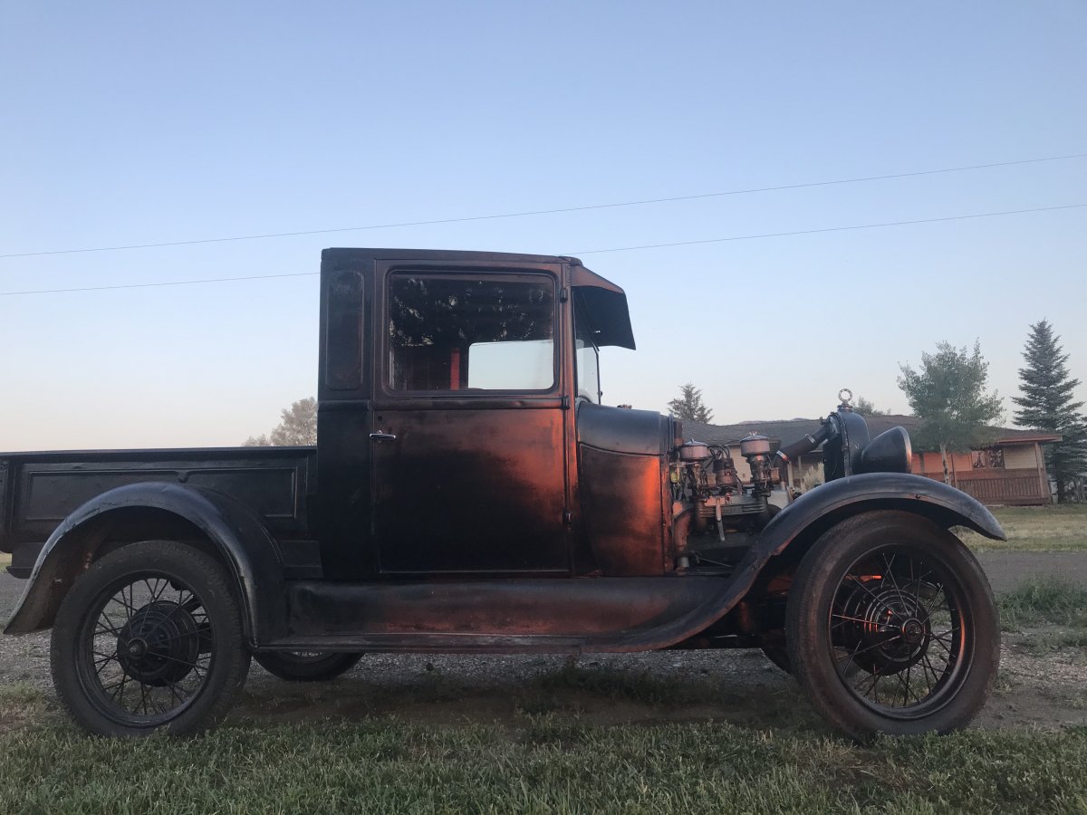

  7. Jet96
    Joined: Dec 24, 2012
    Posts: 1,431
    Jet96
    from WY
    Got the pickup back together, runs pretty well. Like the Winfield on my roadster, the Brierley likes lots of advance quick, but not a lot total. It runs best with about 16 degrees by 1200rpm limited to about 22 at 2000. On 91 octane I can run 24 degrees and it runs a little nicer (and cooler)
    Put about 100 miles on it back and forth to work,etc. The old honeycomb rad can't keep up with our 90+ temps, I'll get a good one coming for it. 71917612-A13D-4A1E-812E-0D3DDEEDB0B3.jpeg nice sunrise pic headed to work Wednesday..natural flame job :)

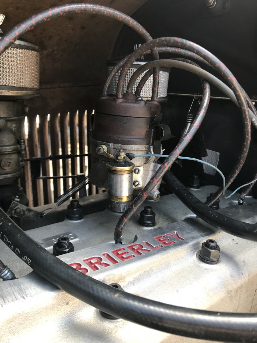

  9. Jet96
    Posts: 1,431
    Jet96
    from WY
    A6EC3A16-08E1-4D44-B956-040715833869.jpeg @mikko it's an older (50's?) Mallory v8 single point. A fellow in FL sets them up and sells them.It came complete with cap, wires, and big can-type condenser. It's a nice distributor, easy to change springs, limit advance etc...plus -it doesn't look modern! Bubba's had run out of cores a couple years ago when I was looking for one for my roadster and a couple guys recommended this one as it's not as expensive as the FS.

  11. dmdeaton
    Joined: Nov 25, 2017
    Posts: 502
    dmdeaton
    do you have the fellows name In Florida? He did a Mallory for me and would like him to do another
  12. Jet96
    Posts: 1,431
    Jet96
    from WY
    @dmdeaton
    His name is Ken Holcomb, I don't have his email, I've got the sheet that he sent with it at my shop if you don't come up with it
  13. dmdeaton
    Posts: 502
    dmdeaton
    Thanks
    I will try to find him
    I really liked the single point aluminum he did for me but I lacked oiling the shaft and after a running season it locked up
    I need it repaired
  14. Jet96
    Posts: 1,431
    Jet96
    from WY
    Yes-that's an issue I had with it, I caught it when I pulled the head to do some welding. I could barely turn the shaft. Dis***embled it and got everything lubed and it worked good again. -Thought to put a tube in the side similar the stock A oiler. For now I just poke my squirt can up in the hole in the bottom and give it a shot once in a while.A bit messy but it works...
  15. Jet96
    Posts: 1,431
    Jet96
    from WY
    Something I've done in the past is submerge the bottom of the distributor in a can of oil. Deep enough to cover the advance mechanism (if possible) but not the point plate. Just an idea...
