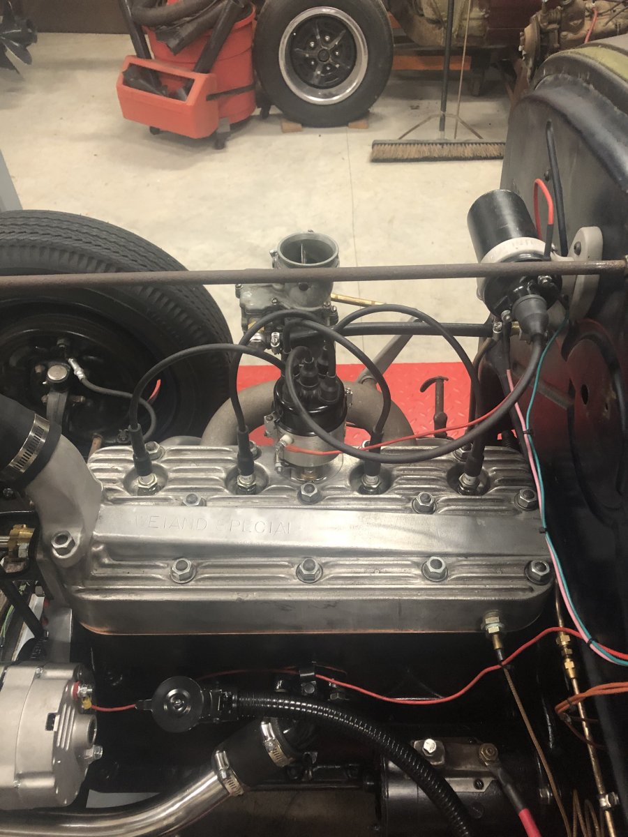

    from Minnesota
    Checking for the month
    Finally had time to get the engine back in the car but its been a fight the whole way.Cant get it started just wants to backfire.Figure its a timing issue but have double checked all of the logical possibiltys.May have to pull the cam cover off and double check the re-builder installed the new cam gear set on correctly,thats the only thing i havent double checked.Any other ideas ? banger.jpg

  16. Burl,
    Have you checked dist position? Rotor is pointing to correct spark plug?
    Verify #1 by removing plug and holding finger over hole while rotating motor. You will not be able to contain compression with finger. While you are at it, you can check visually if timing mark on pulley/balancer is close.
    Then, disconnect wire to coil and use ohm meter to set initial timing.
    Just an observation, if you are worried about timing gear installed correctly, you may need a different re-builder.
    John

  17. burl
    Joined: Nov 28, 2007
    Posts: 888
    burl
    from Minnesota
    Few things i have checked
    Marked crank shaft pulley with head off and check tdc with indicator,checked with finger with plug out seems correct,turned crank 180 and checked made no differance
    Have compression on all four cylinders
    Have spark on all four cylinders
    Checked number one was firing at right time with timing light
    Checked coil with meter shows good
    Double check plug wires in correct fire order 1243
    Distributor was on car last fall at hot rod hill climb worked well after we set curve
    Carb was on car last fall as well and worked great,will open up and double check
    Act really strange like timing is off
    Had the engine rebuilt in skokie,hope they know what there doing by now.
    Fighting the idea of putting in a good 283 thats waiting for a project

  19. Burl,
    It sounds like you have done all the checks, it should fire up and run.
    Maybe a manifold leaking air? or carby not happy?
    Let us know what you find, John

  25. 5280A2
    Joined: Sep 8, 2014
    Posts: 197
    5280A2
    Hi Brian:
    Talked to Gary this evening, and he mentioned your problem. Two additional things we talked about were the need to be certain you are firing on the compression stroke if your timing mark is on the crank pulley, and be sure your coil polarity is correct to get a good hot spark. If you are running 12 volts with negative ground be sure the negative side of the coil (if marked) is connected to the distributor. John Neilson mentioned using your thumb over the open number one plug hole to be sure you're on compression and not exhaust when you approach your timing mark; worth double or triple checking that. I have made the mistake of timing points on the wrong side of the cam lobe too, another thing to check, timing will be close but it won't fire. Hoping for success (leave the 283 in the corner)!

  30. burl
    Posts: 888
    burl
    from Minnesota
    We questioned the tdc mark on the pulley to compression stroke.When the crank pulley comes to tdc the dot on the cam gear lines up with the hole in the cam cover.I would think that this confirms the right location to fire #1
