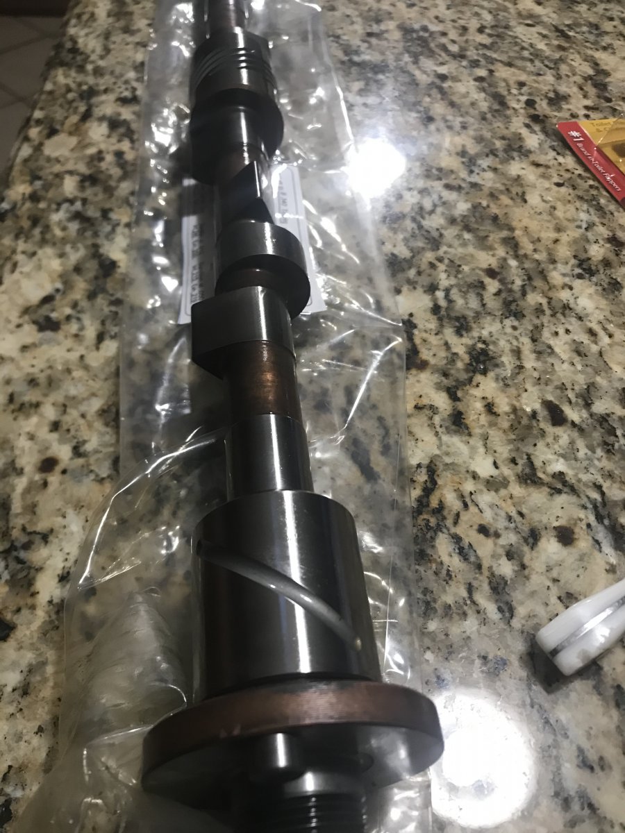

    Yup- a Stipe 340. Really nice piece and got here in a week! My old cam was badly worn in the distributor gear.
    New cam gear and drive gear, advance slots polished up good in distributor...
    -I might actually be able to get my timing sorted in an educated way. I like the look of the combustion chamber in my Brierley head. I just rounded off the sharp edges from machining. I shall report...

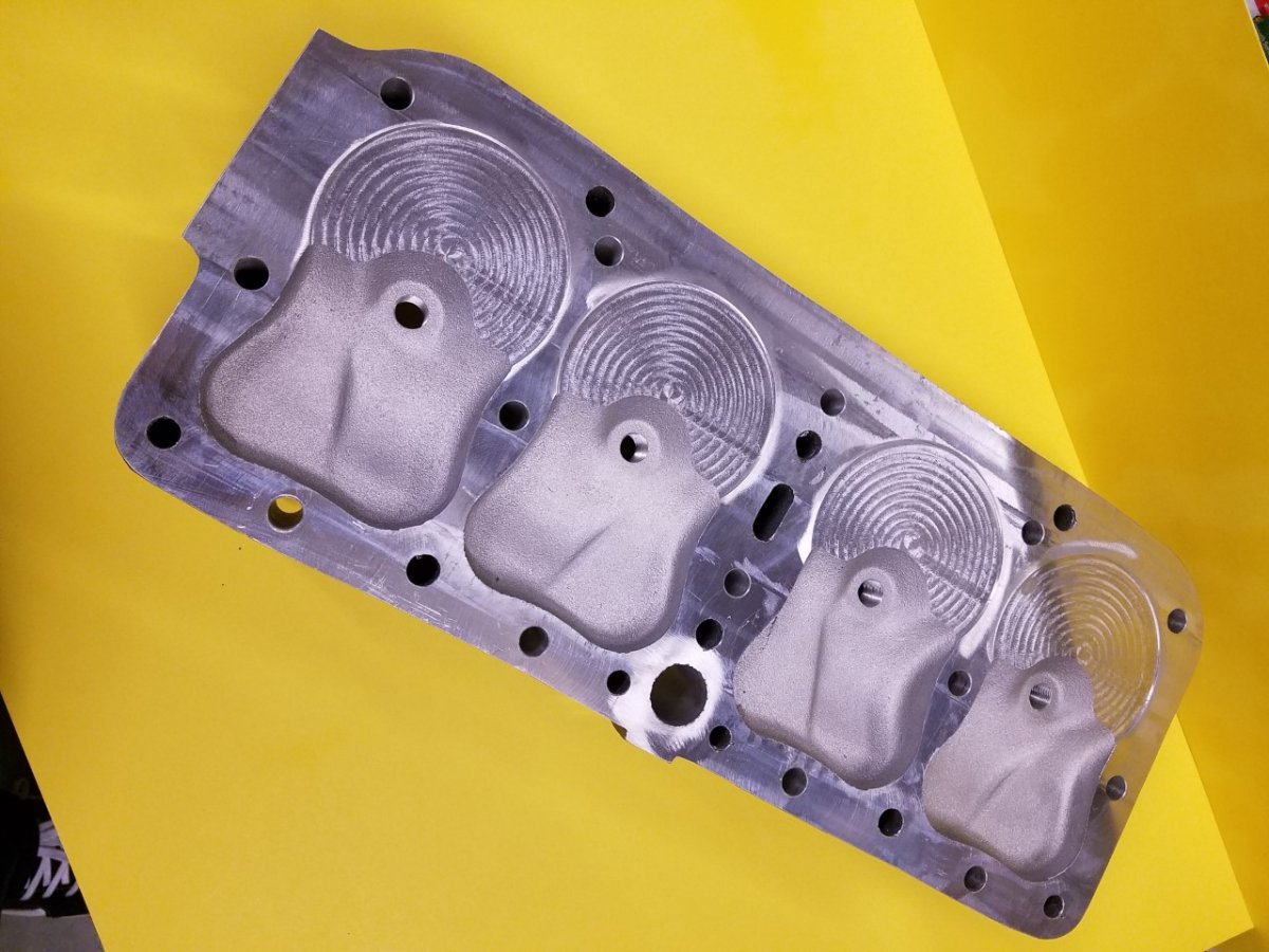

    Well, I've been talking to Jim Brierley and decided to go with one of his heads for my B-engine.
    Hopefully I want regret my decision.:D
    7:1 CR and a .040" relief over the pistons.

  14. Mikko,
    While I do not run any flatheads currently, I can tell you this.
    Jim's sparkplug position is advantageous over the stock location, much better for performance.
    With that said, you will need to limit the amount of total ignition advance from stock.
    Not knowing which distributor you have this can be done with springs if automatic.

  15. Mikko_
    Joined: Aug 3, 2018
    Posts: 653
    Mikko_
    from Sweden
    Yes, Jim told me that about 20* advance was max for his head.
    Was thinking about using a FSI distributor since they seem to be the only distributor that are available new and easy to get a hold of.
    Would prefer something like a vintage Mallory or something like that but it seems difficult to find a good one that is not worn out, atleast here in Sweden.

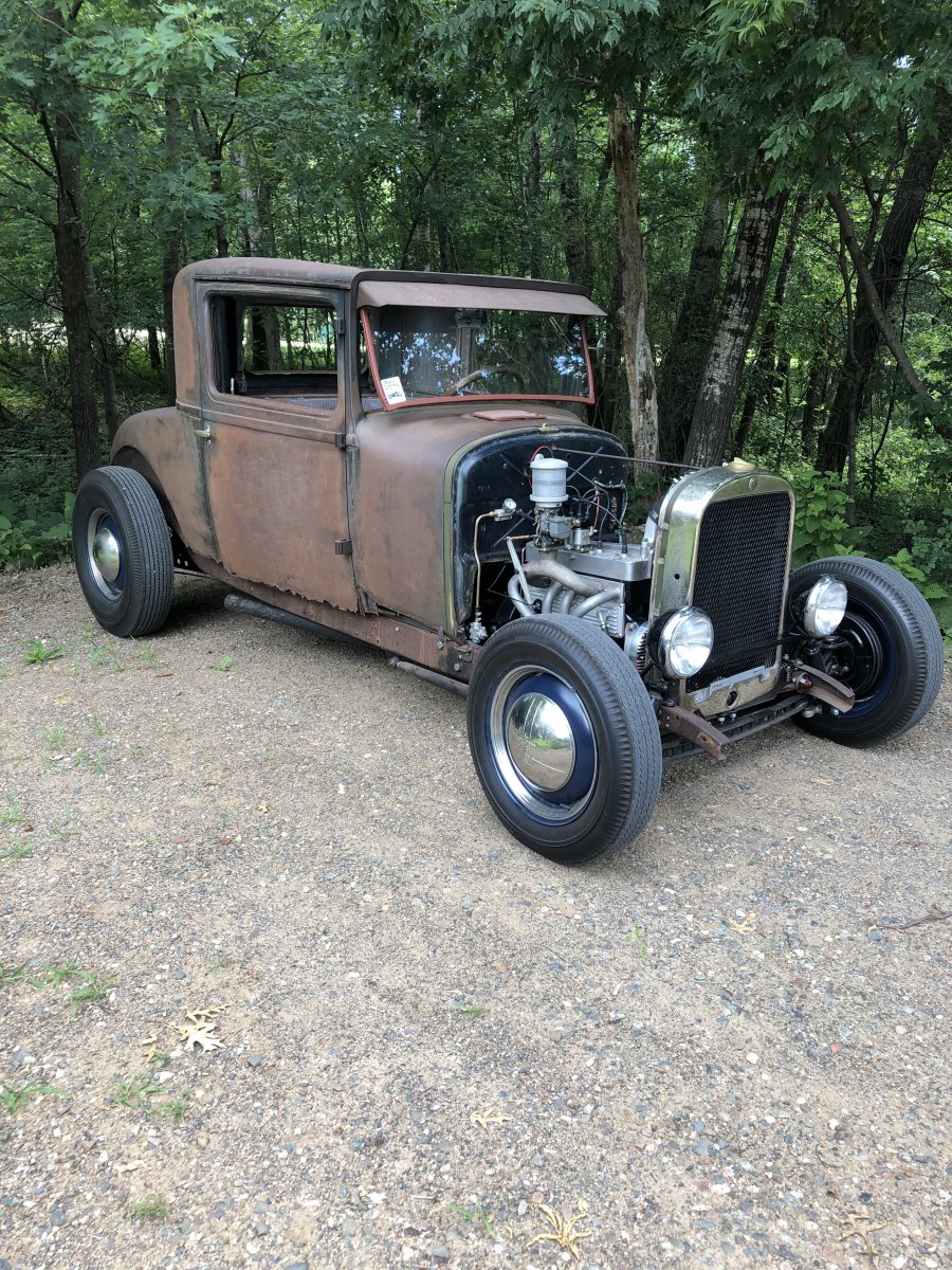

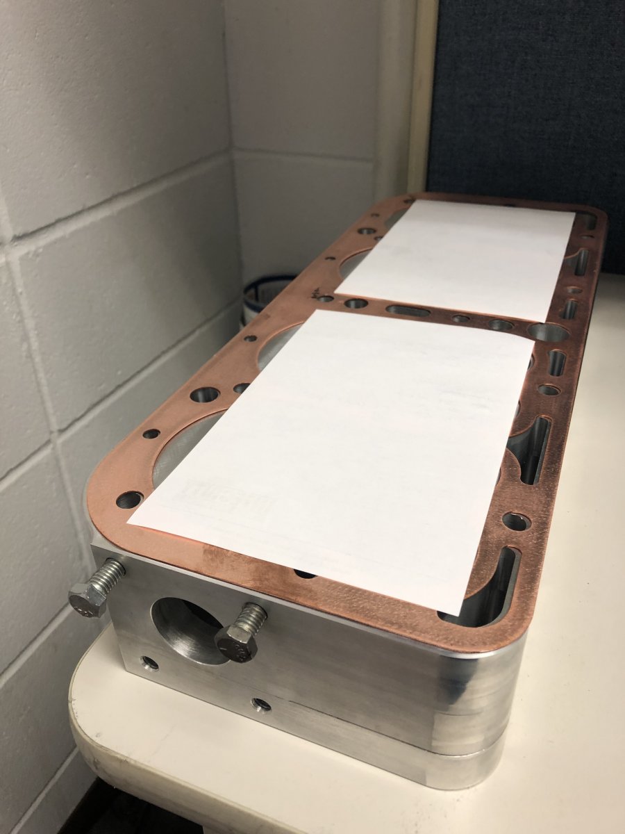

    Finally was able to get everything back together and start rippin around in this old beater.Seat of the pants dyno says the fresh motor with all the goodies pull pretty good.Need to get the special head finished and see how that works. mopar.jpg head.jpg

    Ahww, you got head gasket
    Glad you found time to drive the beater...that's what it is all about
