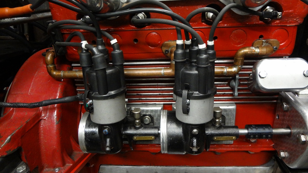

    So this must be ........... 1 2 4 3 x 2 ....... gee this online learning is great. Gary DSC01711 (1024x576).jpg

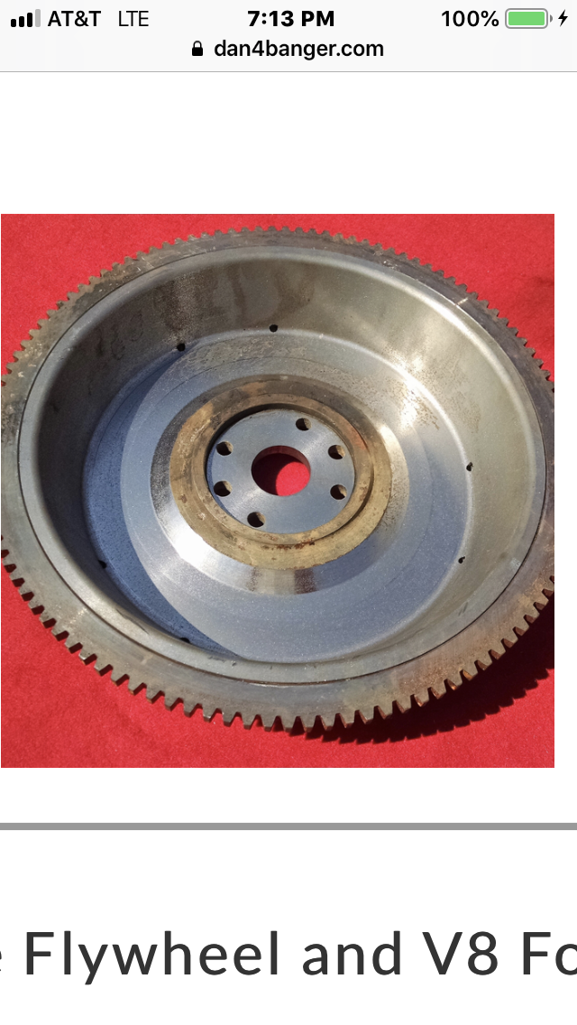

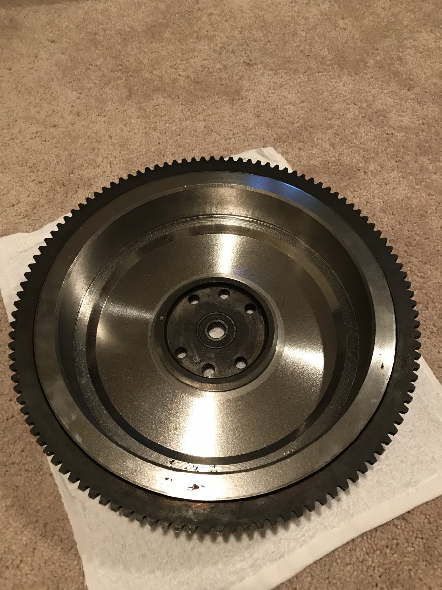

    B95A1414-EB45-4C1E-8B80-04CCE0E4FD31.jpeg Top pic is my flywheel. Bottom pic is what I took to the machine shop for reference. 65DB3544-B8FE-4B3B-ADC1-19DC6903A52C.png Hello fellas,
    Pretty new to the HAMB, hope I’m posting this correctly. I’ve read some older threads saying there was an error in some instructions on lightening a banger flywheel? It’s got me a little worried on the flywheel I had lightened. I read in the Brierley book that you can take it down to a 11 1/16 diameter and take some material off the back side too. I took the dimensions and some pictures to a local machine shop. I’m concerned about the material he took off the back side, I feel like he took too much close to the crank? What are your thoughts? I’m thinking of building a ****ter shield but I also don’t want to risk destroying my engine and ******. Please let me know what you think thanks.

  16. Yeah too cool, nice dist drive setup.
    Is that a two port rocker arm McDowell head?
    John

    Hi John: not a two port rocker arm McDowell. It's a obscure 8 Valve cross flow Model "T" head on a 1927 "T" block. Gary

    Gary, any more info on those dual distributors?

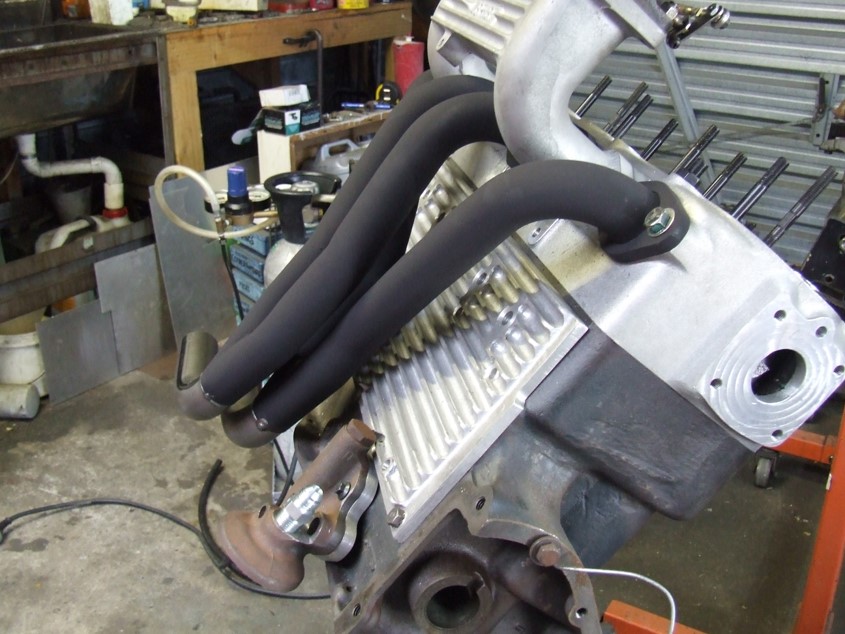

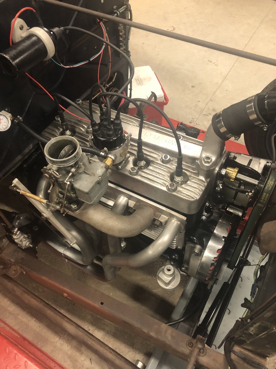

    Still futzing with headers . Getting closer day by day but slow. Hope do get some decent numbers when we are done.B block to go in a 32. The head was part of a deal where we had to take an original cragar along with a new Serr head , sold the original head but kept original rocker cover , kind of want it to look period to match the used look of the 32. Now we have a half price new head, all ported and cleaned up.
    Definitely not my idea but my engine guys ,after lots of His research to use 348 BBC pistons , not W head But BBC bus and truck pistons to get compression up after we milled the head .080 .
    858A53D9-0564-405E-83E8-FAD316C733C1.jpeg 43660F98-64CE-4147-8FA1-87371A8A8FA6.jpeg 5665C4D4-9F2F-4D44-AC28-A17BF2C96F1D.jpeg

    Bosch China knock offs from ebay $ 37.00 each fits VW, counterclockwise rotation 20 degrees advance at the distributor. I machined them to fit 1920's Dodge 4 cyl. dist mounts. Gary

    Gary,if you go to the The Samba.com,the big Vw forum and contact a guy named Glenn Ring he rebuilds vintage Bosch cast iron Vw distributors..the real deal,those cheap 009's from China will bite you

    I cant help much with the Flywheel issue but Welcome to the HAMB and the banger meet!
  24. Gary,
    hell, I didn't even notice the block or flywheel housing, too interested in the dist drives.
    Does the shaft drive from front run at crank speed or cam speed?
    John

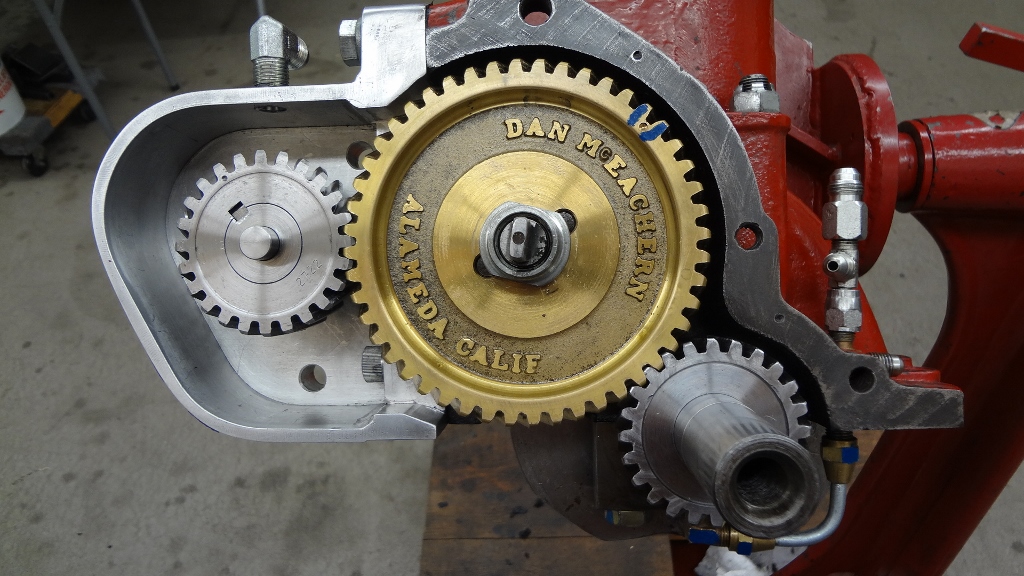

    Crank speed , but there is more going on. Let's say crank ( 25 t )speed is 500 rpm....cam gear ( 50 t) down to 250 rpm ... second crank gear ( 25 t) and back to 500 rpm.... the 90 degree 1920's Dodge dist housing and gears, ( 9 t ) on the shaft and ( 18 t) on dist lowers the dist speed to 250 rpm Gary DSC01629 (1024x576).jpg

  26. Gary,
    That is exactly the info I was looking for. The Mod"A/B" governor housing is crank speed and so are most side drive aircraft mags. That is a very nice setup.
    John

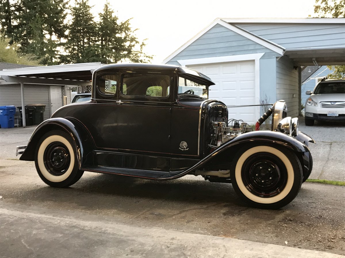

    0B3AAFBC-6935-440C-92C9-0D2E407E929A.jpeg F20293B9-7008-4A24-AC82-984835711FCF.jpeg 41EBF2DA-9D80-420C-B2A1-793DAB6CDF05.jpeg 7A6535AB-0B68-4E7A-B74A-04EF60E41D3E.jpeg Hello,
    My name is Hance. I’m new to the HAMB. I like banger powered hot rods.
