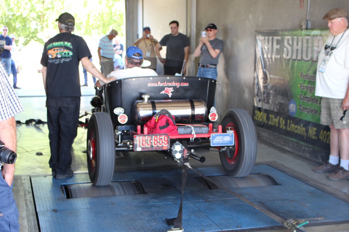

    You obviously don't go to the same FAST events I go to. 72A3BD0D-E1A7-4B3E-8C5E-3965C65A3EEA.jpeg

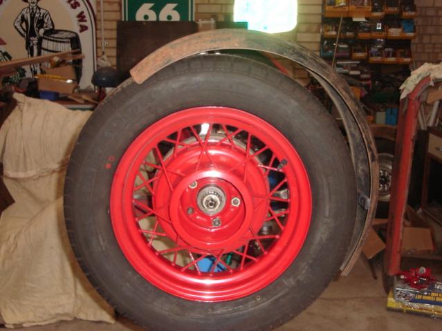

  12. C3BF431C-F195-4CD7-802C-4538D69E574E.jpeg It’s buggin me so I gotta ask..maybe wrong thread...
    Running 600x16s all around. Want cycle fenders. (600s were stock size in ‘35)
    Scored a ‘35 spare tire trim band...snug fit on a spare-no go as a fender.
    Tires are good. Don’t want to buy smaller ones if there’s any alternative ?

    trim the fenders .........

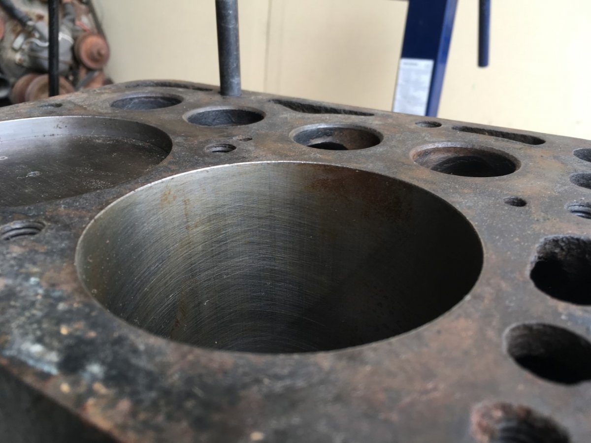

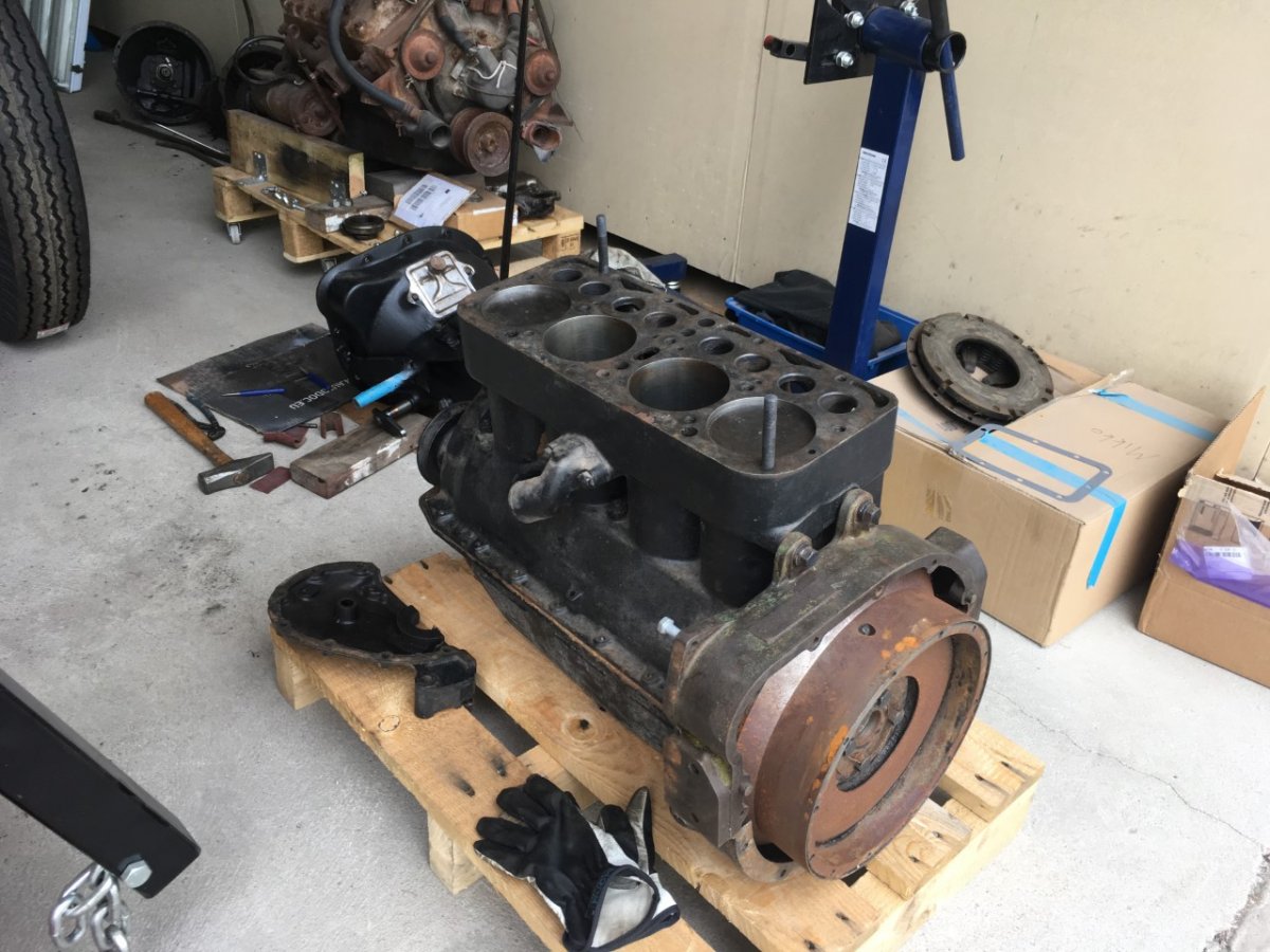

    Picked up the B-engine that I'll be using in my '28 Phaeton.
    Bored .050 over many years ago but still looking good.
    Has the counterweight crank and flywheel is lightened a bit to around 40lbs.

    I just threw away a stainless steel band for a 19" RV spare tire cover. Looked like a perfect fit for a free standing fender. Enough material in a single band for two fenders.

    You can always add to the middle of the spare tire band and make it wider. Depends on your sheet metal fabrication skills. if you are not too fussy you could look into some trailer fenders that may work for your needs.

    Thanks @Binger. Metal skills ****, but width isn’t the problem...it’s the tight radius.
    Front fenders are holding up state inspection...still an outlaw for now.

    where was the dyno ?

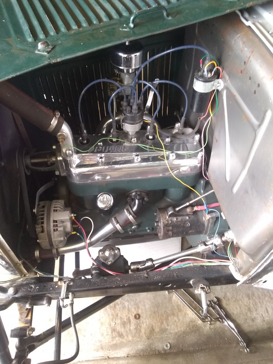

    IMG_20200525_094332958.jpg Hay everyone kind of a new guy to all this banger stuff
    But just picked up a 30 rpu that was kind of a project that the original owner lost interest/time in
    It has a ron Kelly built engine
    T5 trans ,40 rear and big Lincoln brake's
    My question is has anyone had any experience with the champion aluminum radiators
    Some time in the future I may change to a32 grill and don't want to dump a lot of money on a rad
    Jet96 and Binger like this.

    dudley32
    '32 grille should fit your radiator with little to no changes...

    @Shutter Speed . Yeah probably wrong thread.
    You can change the arc by steady down pressure, but it would appear you have more than half a cover there so if it were shorter the fit could improve.

    from wyoming
    Welcome to the banger world. With your T-5 is it open drive shaft or are you running a torque tube?
