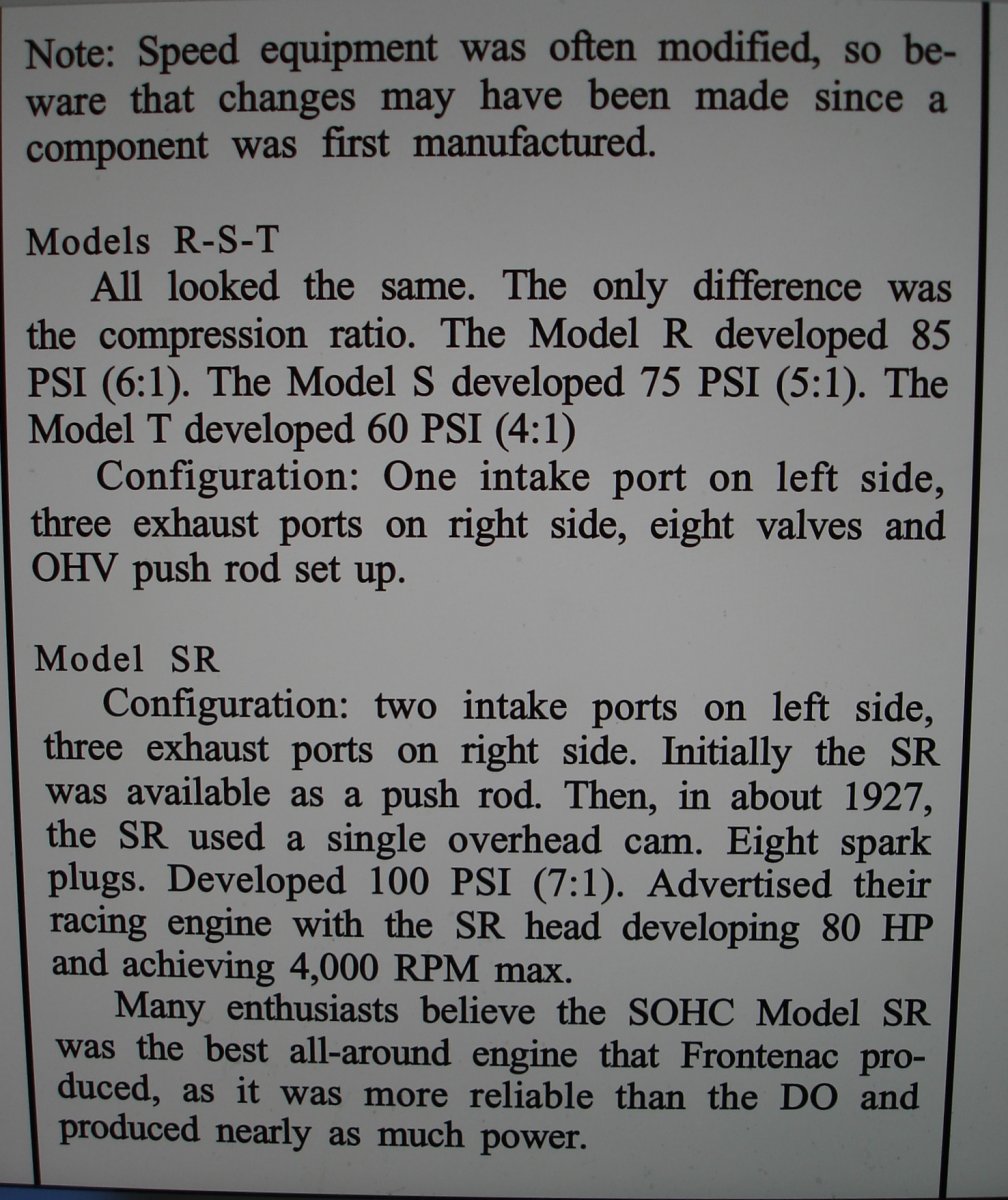

    I,m sorry I forgot to mention, it is a "T" head. That is why I am having custom pistons made to bump the compression up. I have been talking with a hill climber out of Colorado that also runs a "T" head, he was kind enough to give me the the info on his pistons so I could get some made, albeit at a lower compression ratio for me (he just upped his to 9 to 1).

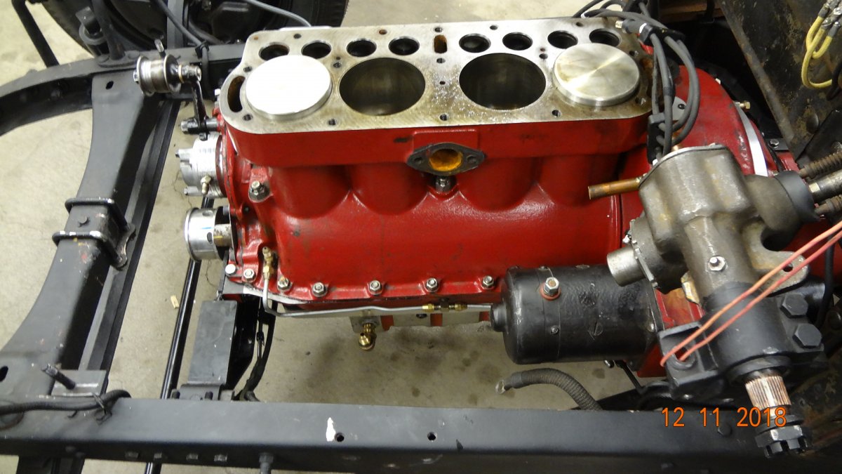

    Something like this........pistons are 1/2" above the deck.....6.5 to 1 comp ratio. Gary DSC01031.JPG
  13. That's some pop-up!
    barrnone50 likes this.
  14. V4F
    Joined: Aug 8, 2008
    Posts: 4,391
    V4F
    from middle ca.
    thats the way they are , but be glad the head is recessed ............ looks really cool

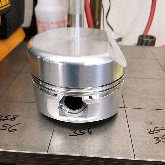

    Below is the custom Ross pistons that have been made for a Frontenac and other similar chamber heads. I am not sure if his pic is of the 7.5 to 1 or his newer 9.5 to 1 version. He runs the same head that I do, and our chambers CC to be similar size.
    But I was proposed an offer on his 7.5 to 1 pistons today. I am not sure if I want to go that high. But it would save me a few hundred dollars...and definitely add some pop.
    Any thoughts on that using his old barely used pistons? My cam is a Stipe copy of the Laurel Roof cam, 196 / 205 @.050 / 117 LSA / .310 cam lift (about .420 at the valve).

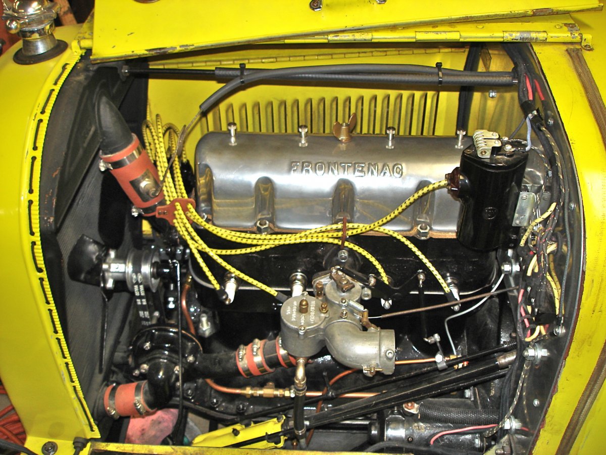

    My Mercury Speedster has a Fronty S head with 6.5 to 1 pop ups, Stipe Laurel/Roof cam, triple front plate (water pump, oil pump, and distributor), and a Winfield H side draft carb. Other than a 12 volt system and DSM ignition almost all parts are 1925 or earlier. fullsizeoutput_1296.jpeg

    First off @25mercury , that is awesome!
    I have some questions:
    I see you are running head studs...where did you source them from?
    I see a valve cover gasket, are these available or did you make your own?
    How do you like the Roof cam? Plenty of go?
    Oil Pump---oiling just the mains or pressurized rods also? Do you have a deep oil pan?
    Les Shubert 5 Main Block? AND a Fronty SOHC!?

    The head studs are Model A, the 2 long studs at the front of the Model A head are perfect length for Fronty single port heads. I cut my own valve cover gasket from a roll of cork. You have to grind the block a bit to fit in the Roof cam. The cam likes a light car and low rear end gearing, I might play with some offset cam dowels in the future. The engine has pressure oil to the mains and splash to the rods with a deep aluminum oil sump. My black Mercury gets the SOHC Fronty and the 5 main block made by Les Schubert. It will get a flathead V8 transmission.
