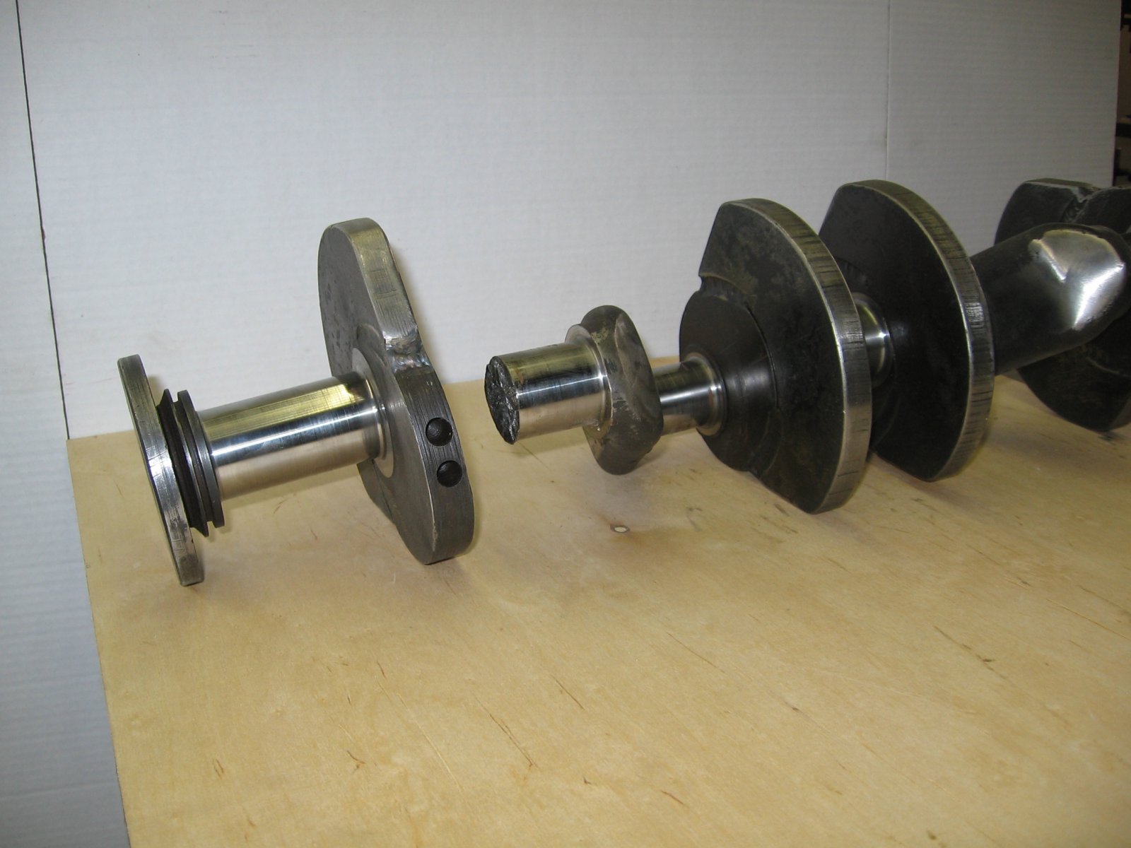

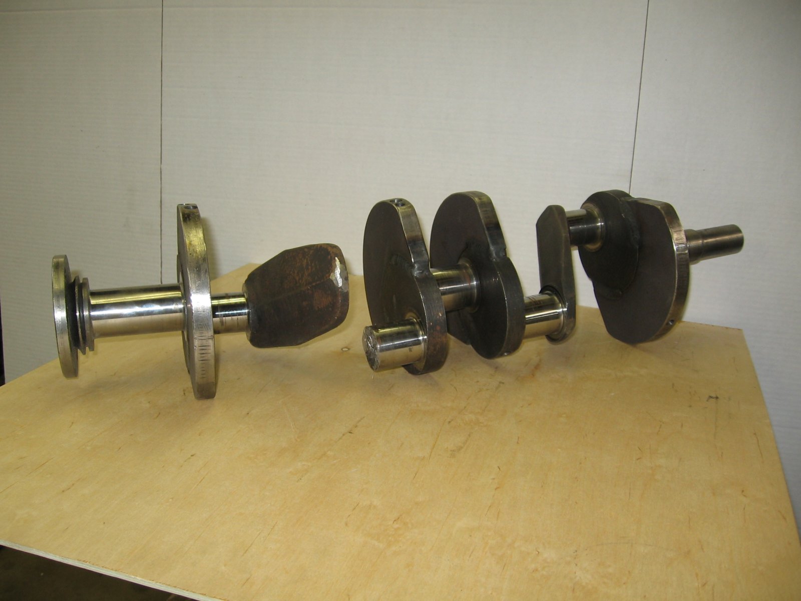

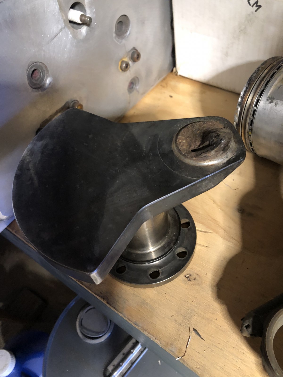

  3. So
    This is a solution,
    that has so far prevented this, which happens to be a **** crank

    Yes, the combination running with those two crankshafts included lightened and balanced flywheel and clutch ***emblies. I believe the cause of the breakage was excessive spark advance, the set-up running at that time had about 30 degrees of total advance.
    My solution was a new Burlington crank, steel main caps, inserts and pressure oil to the mains. Ten years later it's still running and taking some occasional abuse.

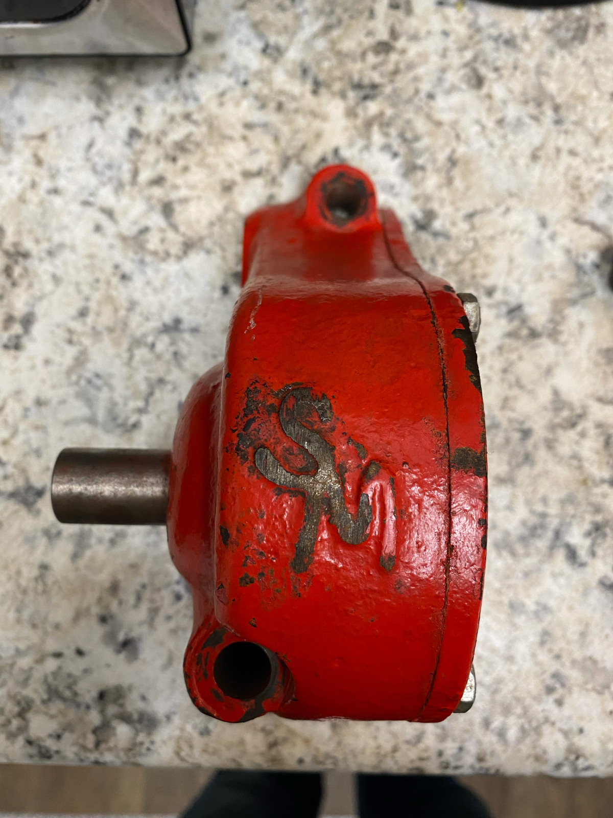

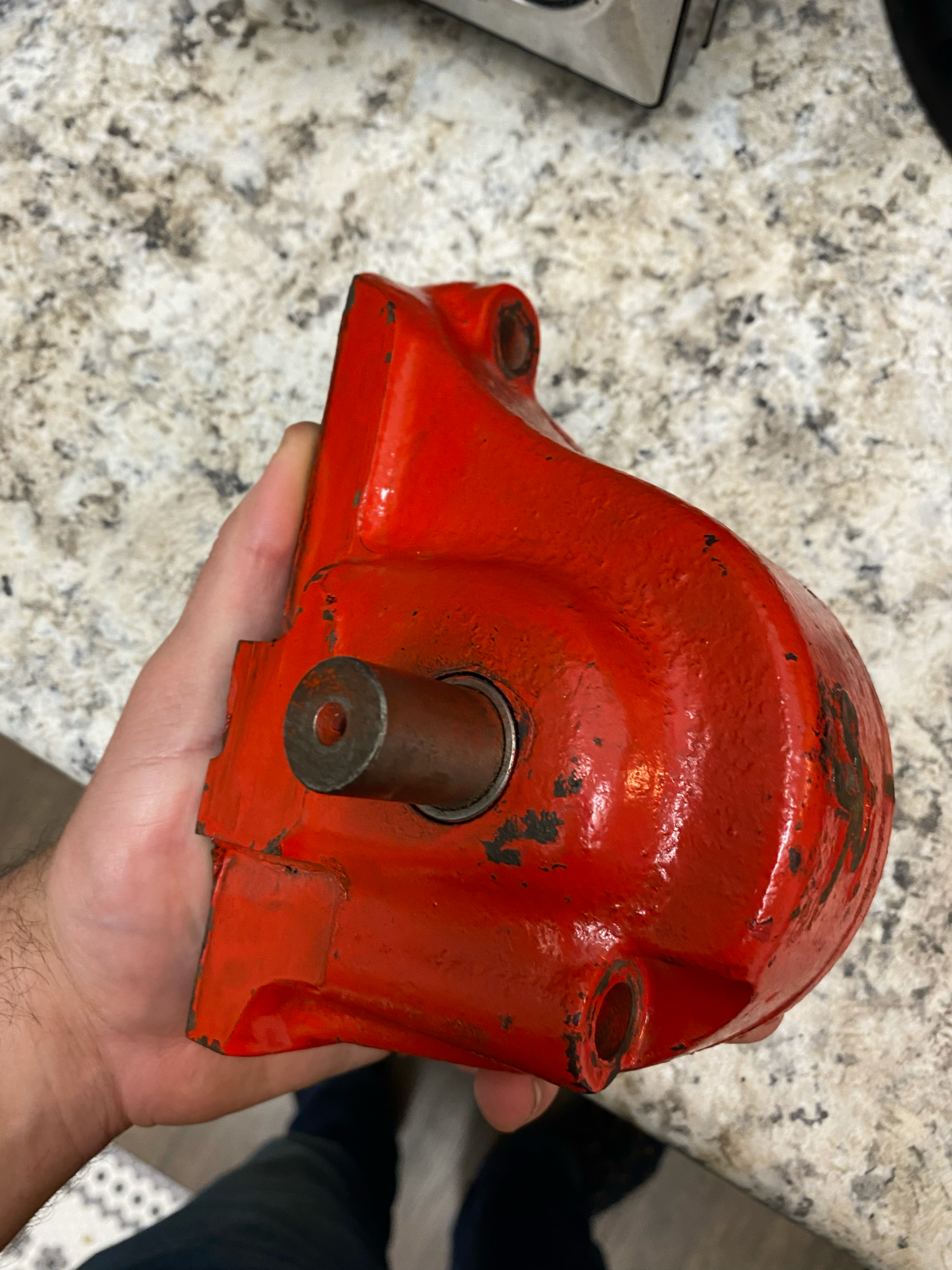

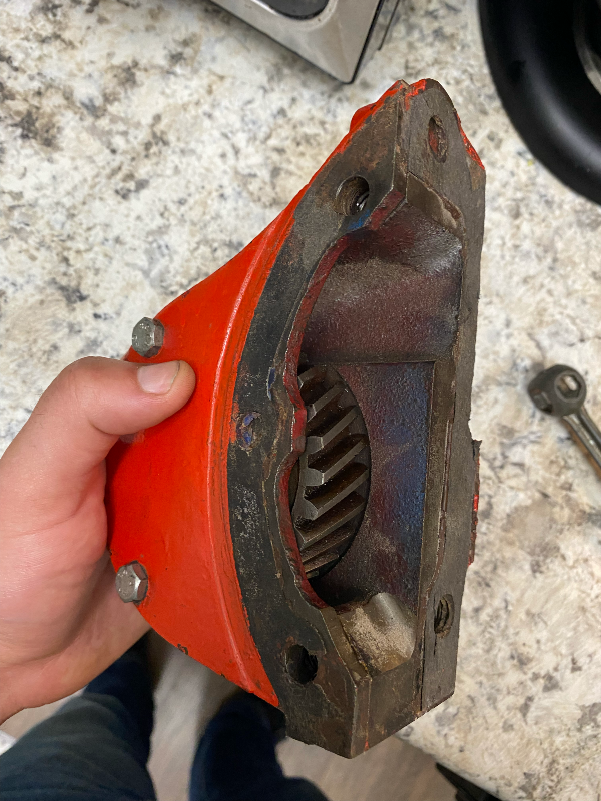

  8. Friends, can anyone identify this?
    I know it's somewhat related to the "SM" Smiley Martin Magneto Drives, but this one is a little odd.
    It's got a drive, but there isn't a base to mount a mag.
    Leaving me puzzled, I'm curious.... What would this be used for?

    Does the shaft have a key way? It looks parallel?
    Maybe it is for some type of coupling or auxiliary drive for something? ?

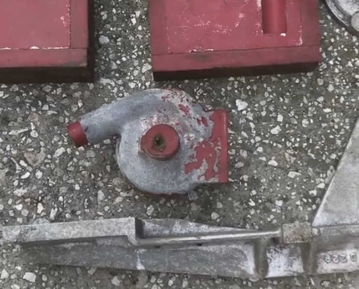

  10. It could most definitely be an aux drive. As far as the shaft, there is no keyway and the hole isn't threaded.
    I'm considering reproducing some shaft driven water pumps, and might run this with them. Screen Shot 2022-07-17 at 8.41.00 AM.png
  11. Water pump would be a good thing, it addresses part of the inadequate cooling system in the "A/B".
    The fact that there is no key would lead me to believe it is for a magneto, using a clamping collar for timing.
    It's all good, keep it up!

  13. I think the water pump could be pretty cool. My friend, @chevahaulic took a Chevy 216 pump and adapted it. Apparently the flow of water was backwards.

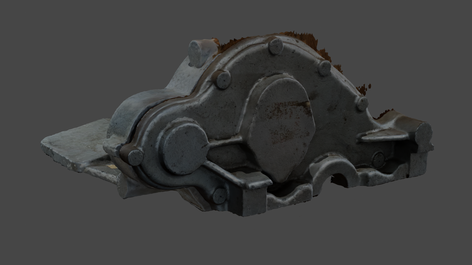

    I'm working on this, despite being super rough. Plan is to start cleaning it up, and possible 3D print it for mockup. I'm hoping to have it setup for a Wico X mag or Bosche MJC. untitled.png

    Retson,
    Yes, keep building on this platform. Only comment, make the pad larger to fit a rectangular pump flange.

    Perhaps a mounting pad in front of the accessory gear too, then something could be driven off the front of it. It would be easy enough to remove some metal and smooth it over if someone didn't like the looks of the extra metal.

  27. Definitely will do! At the end of the day, I'm just a kid learning CAD!
    Here's what I've made so far. It's quite rough, but I'm still getting the hang of it.
    I'm considering having it secured with some longer oil pan bolts, which I feel might help with rigidity since it kicks out to clear the oil return tube.
