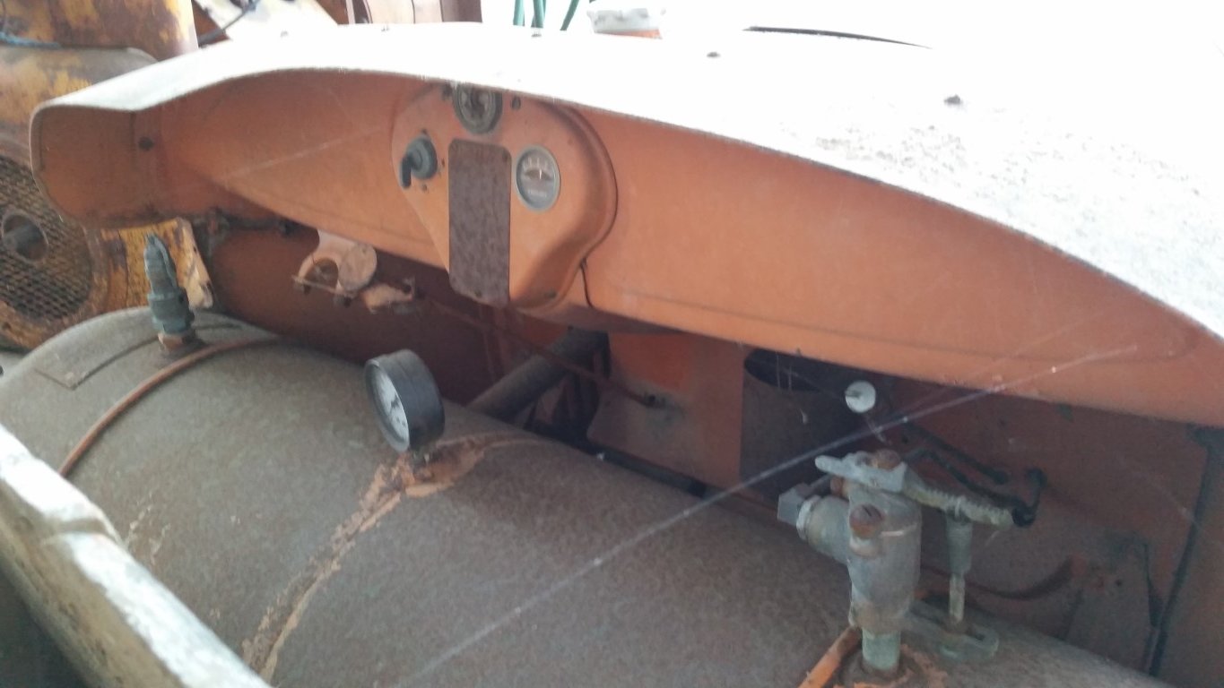

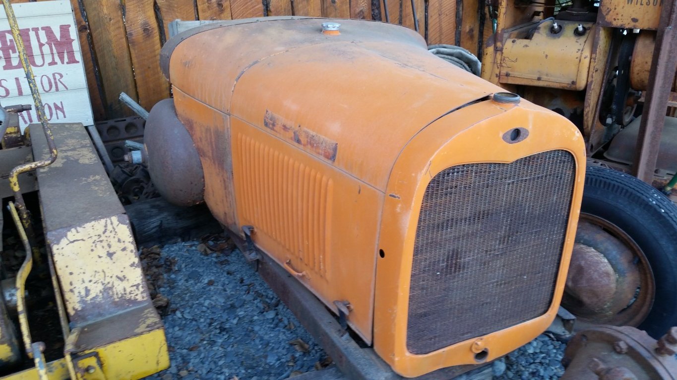

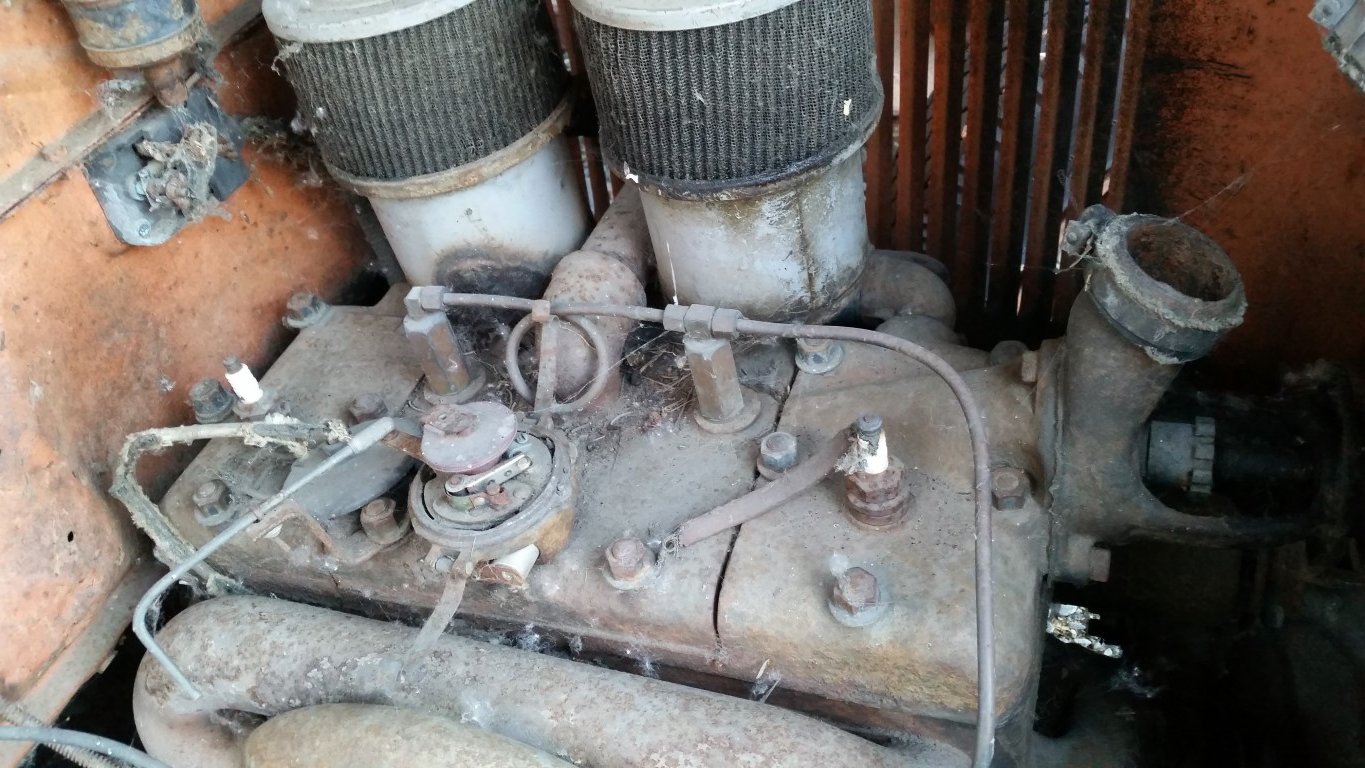

    60 years ago, my brother showed me an "A" head that converted the motor into being an air compressor -- two running, the other two pumping. Is my memory bad or was I just drinking too much?

  10. No not drinking too much, maybe not enough....
    That was a common conversion for portable air compressors.

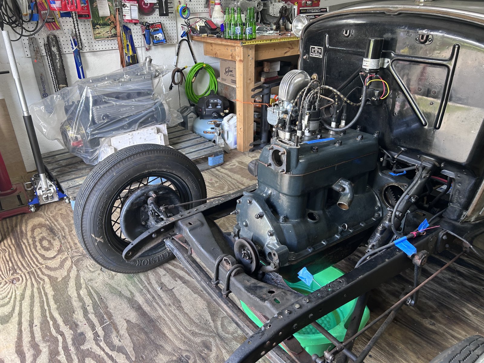

    After months of waiting, my new Banger arrived from the other coast.
    I started stripping the old engine today. A21FD21B-397C-46B8-9412-5AB0AAF19352.jpeg

    Apparently, a lot of engines have been converted to compressors. First time I heard of it, the outfit one of my buddies worked for rented a compressor for a few days that was a 302 Ford engine running on half and squeezing with half.
