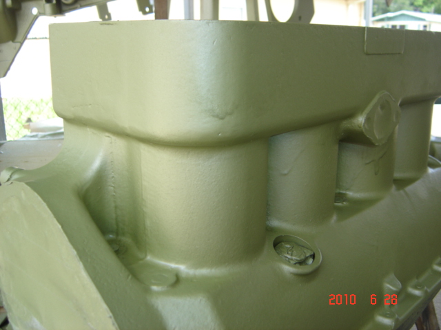

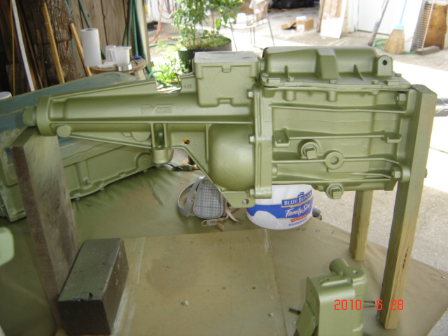

  3. Did some engine painting.
    Mike

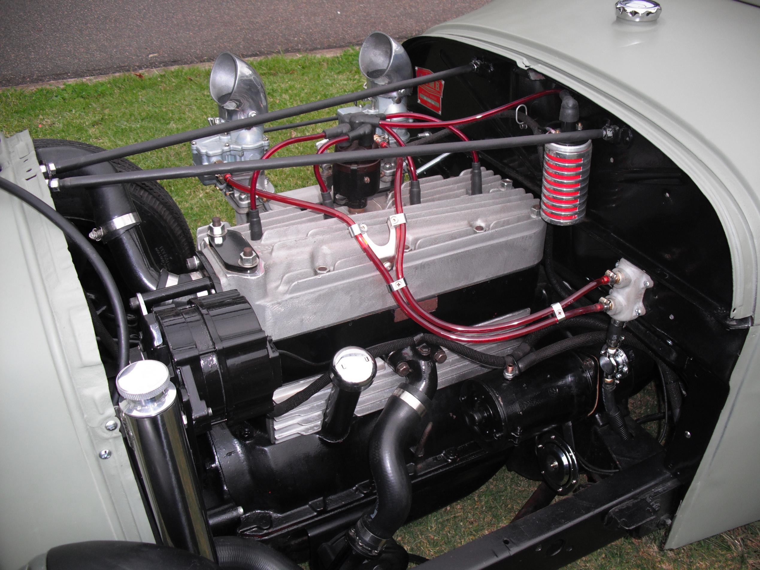

    I got a new Edmunds Custom air cleaner to put on the 97. It's pretty...
    Going to a show on Sunday, just to have a reason to drive it. The kids are really loving the car, just begging me to take them for a ride around the neighborhood.

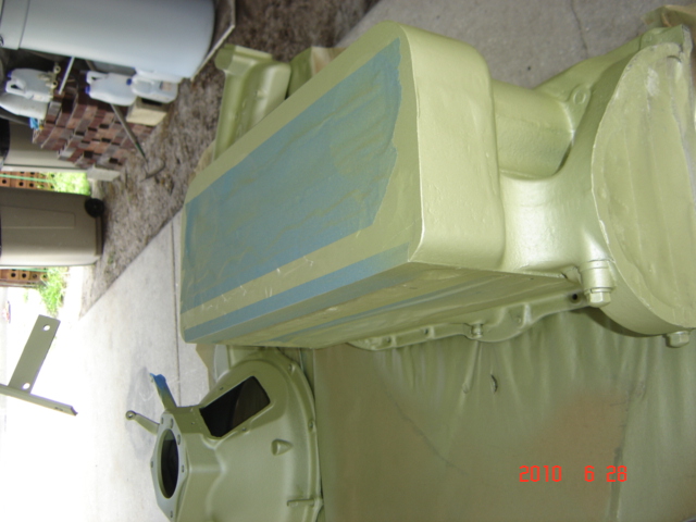

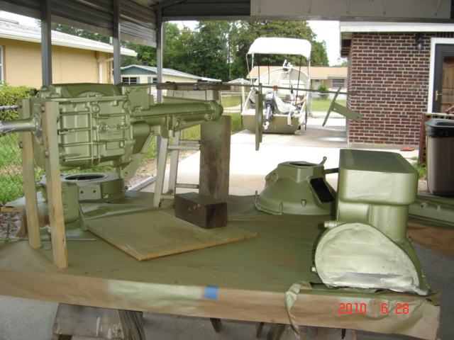

    really looks better- got some runs though, I am about to paint mine- any advise you can offer from experience.
  8. I used easy off then that enviro friendly orange paint stripper and a small stainless steel wire brush, followed up with picklex 20. The green paint is a waterborne primer with a top coat of clear poly. I was going to scrape the runs but ran out of primer and knowing me I would have scraped down to bare metal.
    Mike
  9. I like Plasticote sold by Carquest. I have sprayed alot of my model A parts with either tractor paint or plasticote. Generally I have prepped by wire wheel, sandblasting more intricate parts, cleaning the parts with linseed oil and letting dry over night. Lastly I paint with lite coats and all coats within an hour. After a day or 2 if I don't like how something turns out I scuff it up and repaint. This was how I redid all my drivetrain. I had little issues with runs in the paints.
    Just remember to read the directions well and experiment on something small first. I tried Krylon, Rustoleum, Ace Brand Rust stop, Bear, and some cheapy crap from wal-mart. Plasticote from Carquest, Valspar from Tractor Supply, and Caterpillar brand paint were the best. Here in California most of the good paints have been pulled from shelves do to high VOC content and replaced with waterbased crap. If you recoat with most of these water base paints you will have crinkles and have to restrip the part to paint again. Just my .46-Weeks
