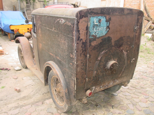

    Brought new by a painter (house) in Paris only LR4 delivery truck left. Lucky for us ch***is' are the same for all LR4s but as I said they were only a short production between LR2 and LR4-N2 all three have very different mechanicals
    Almost nothing is interchangable with Austin, Dixi or American versions

    The rims are Bibendum design. They have a drop center but only inside half way around. This was thought to keep the tire on better. Rims are more high sided than later designs. Inside the rims are 17-7/8s inside(so you had to buy French tires).
    Corky Coker had a few of them ..... very old and NOS and wanted STUPID $$$$ for them and who knows how round after long storage.
    If you put an 18 inch tire on they don't center.
    Remember this is a 25-40 mph truck.
    The Czech's make a wonderful 4.50x18 tire for antique tires fresh, round, correct outside measurements and at US$70 each a set of 5 cost less than one of Corky's! We got strip of rubber glued it in the rim and the new tires went right on with less than 1mm runout.
    Please remember the wee van weighs nothing and doesn't go fast. I wouldn't do this otherwise.
    The very very old tires we took off said max speed 40kms in French. Must have been made for wagons!!
    Yes Tires were a problem........

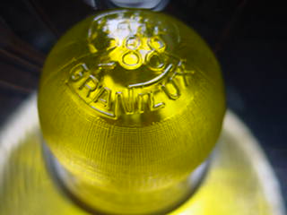

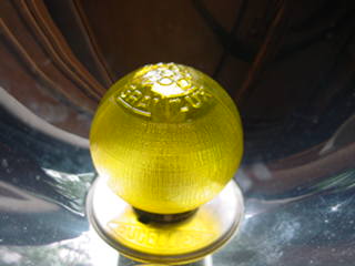

    If you think tires are a problem here's the headlight bulb
    As you can see the focusing is all etched on the bulb not the reflector or headlamp lens
    I remembered a little old lady that had several at a swapmeet in Holland. Went back years later to see that she sttill had 20 bulbs .... now have THE WORLDS supply 6 and 12 volt :cool:

    The Rosengart is actually much smaller than it looks in the photos. It's the size of an American Austin. 3.10 M long and 1.20 wide. My idea is that successful designs have no real scale. I know that the 3/4 front photo it could be Model A size, but nope it's small.

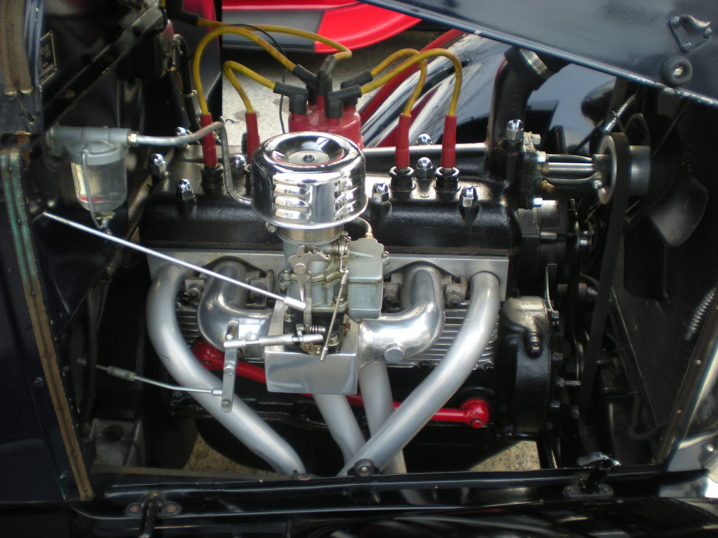

    Can someone please tell me what intake manifold this is? Thanks!!
