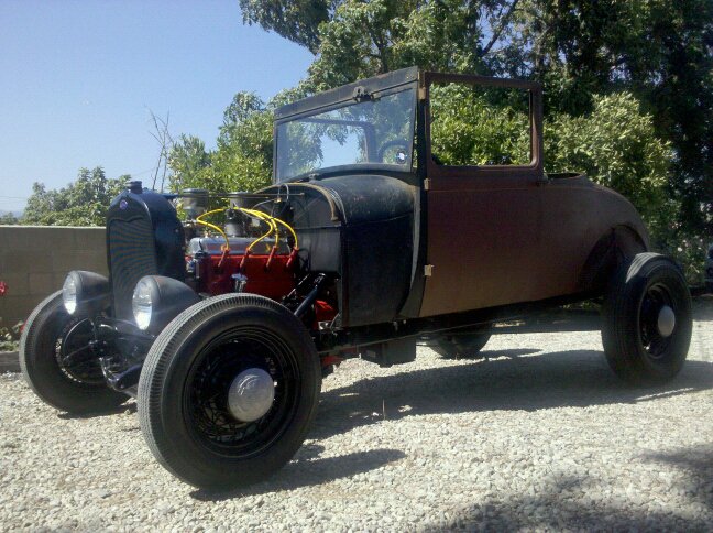

    First road test yesterday. Ran out nicely, but it loads up unless you stab the thing. Two 97s might be a little much. I'll try to rejet them first, but may end up going to 81s. Only thing left is to hook up the overdrive. Concluded the night at Santa Paula Cruise Night with a pint at the pub. A good Friday night.

    i tried everything with my 2 97's on a 4 banger . could not solve the rich problem to my liking . went to 1 97 on scalded dog manifold . it got faster & much better to drive ! went back to colder plugs even ...................... steve

    Not even a rattle of a lug nut before I was draggin *** and my wheel p***ed me at 30 mph. Good for one's prayer life.
