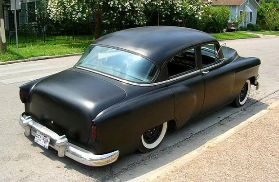

    I could not afford a 2 door when i was looking for one, but i found the 4 door i have now cheap, here are a few pics
    from this ..
    to this...
    To this ,with this...
